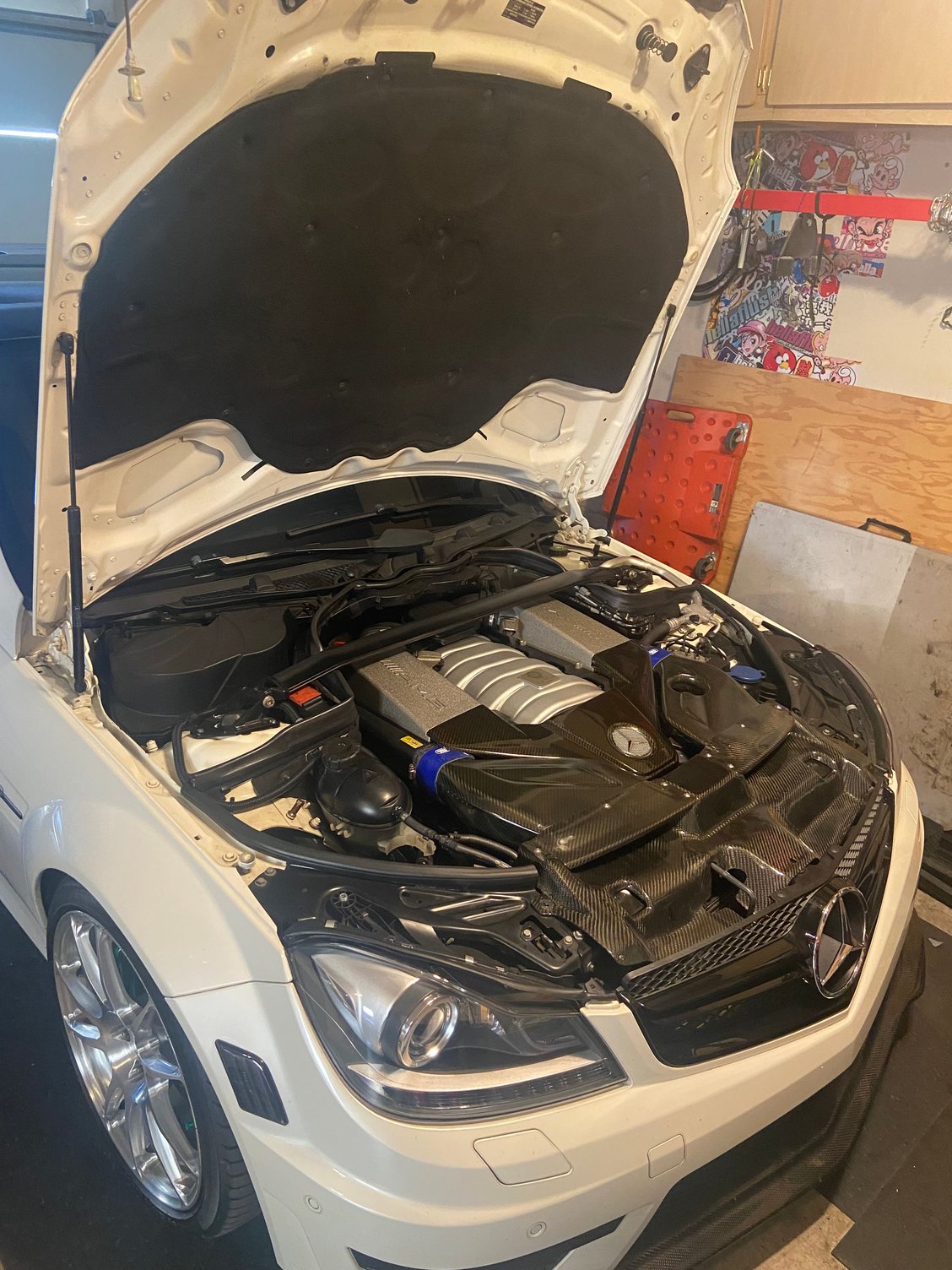

Teaser 2...

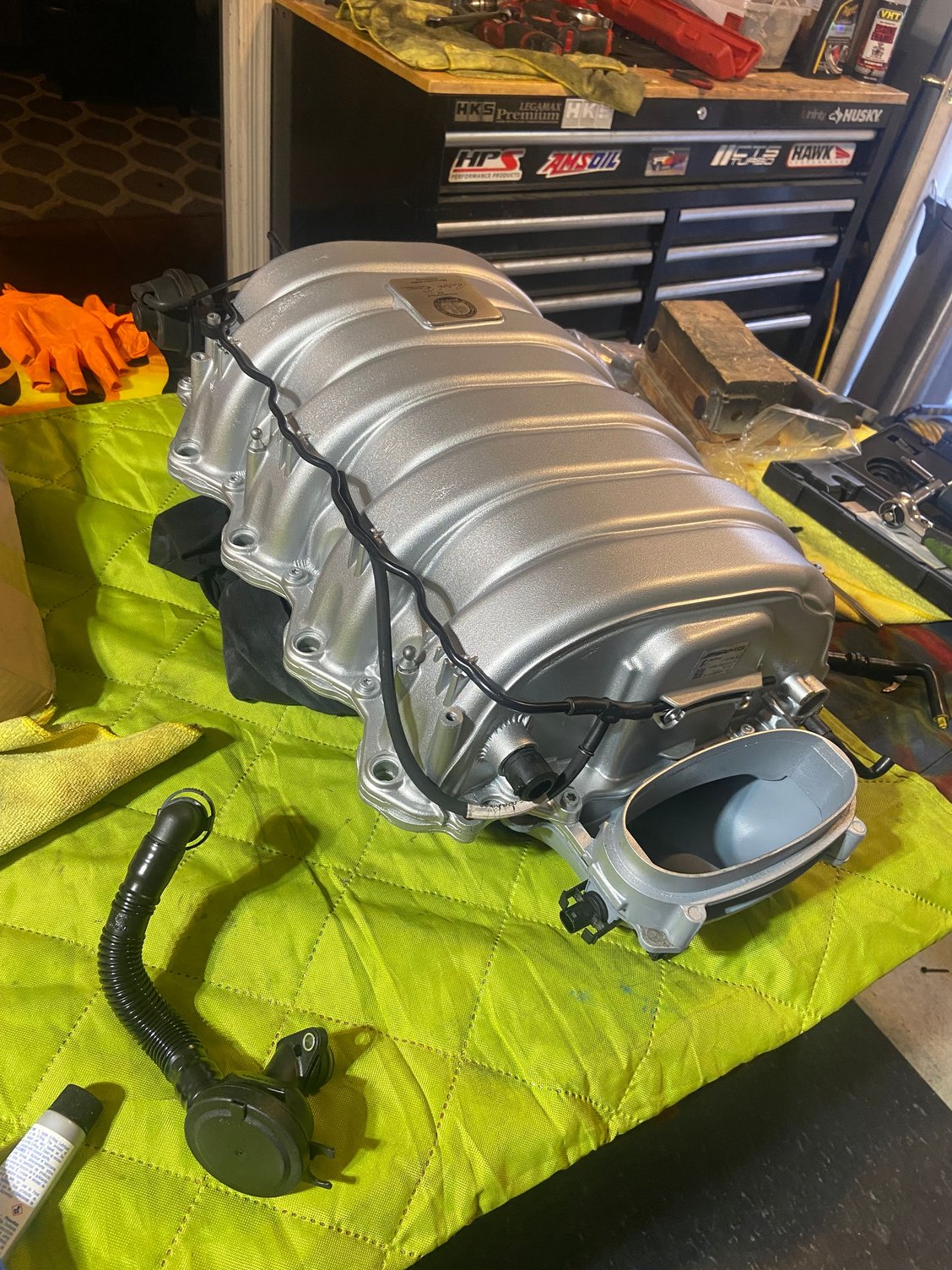

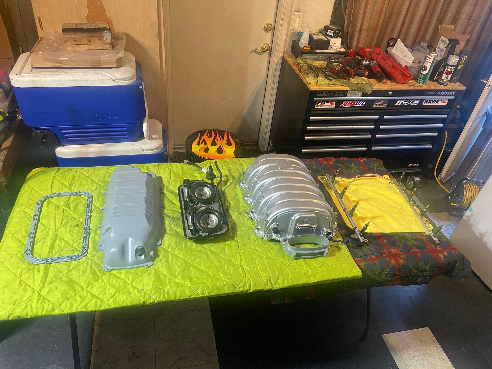

Manifold clean/refresh with new tb plate and treated metal to stop corrosion (since this magnesium/aluminum turns to powder) and all new gasket and fresh paint.

What products did you use to clean, treat, primer, paint, etc?

I used por-15 products. sanded and used dremel to remove all rusting areas then cleaned and prep metal with por-15 degreaser and metal prep to help neutralize any rust I might have missed then used pre15 top coat in gray and silver.. less then $70 in those products to help stop further corrosion..

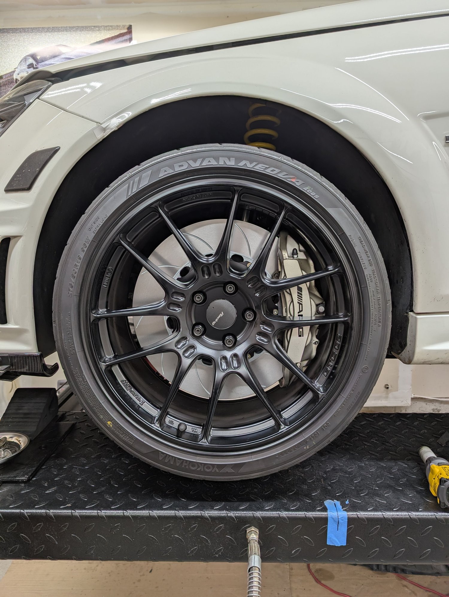

390mm front rotors
