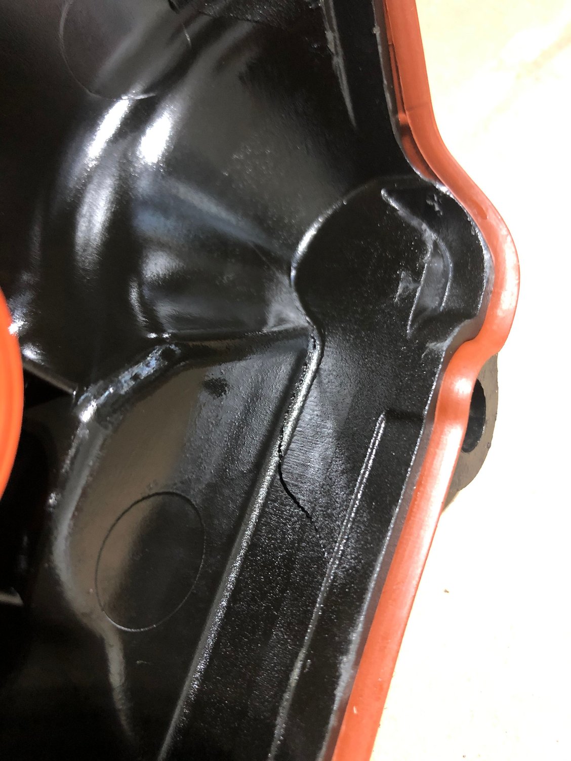

One thing to look out for is cracking on the driver side close to the firewall. When I dove into mine thinking my gasket had failed, it was actually a cracked VC.

As Cammer88 inspect very carefully as they like to crack, especially back lower corner of drivers side, hard to find sometimes, but I did my seal twice before I found the crack. PCV not sure how anyone does it with the manifold on the car and since the manifold gaskets are known to fail, just easier to pull the intake and do the gaskets and PCV at the same time, probably takes no more time to pull the intake than fiddle around trying to do the PCV without pulling it.

Thanks for all the info guys. I will be checking for cracks. If there is any does plastic weld work or do I need to replace the covers?

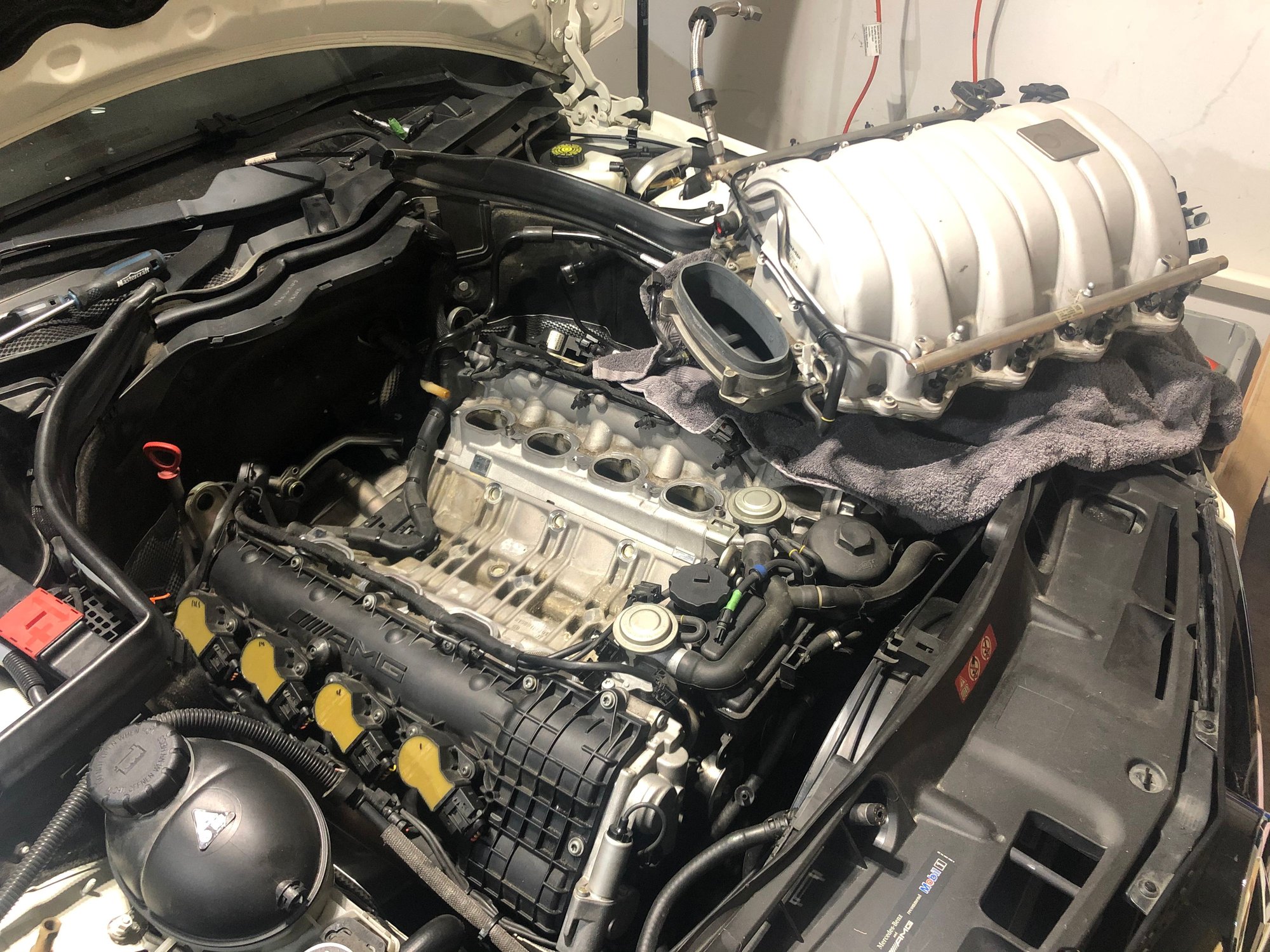

I also removed my Intake to fit the new PCV valve which took no more than 30mins. Iv opened it up to clean and was really surprised how clean it was inside. My questing is now! What torque do I need for the new intake manifold and also what torque for the throttle body bolts and plate.

I think my intake took me like all day but I took it apart and cleaned it and broke one of the throttle body bolts which sucked a bit.

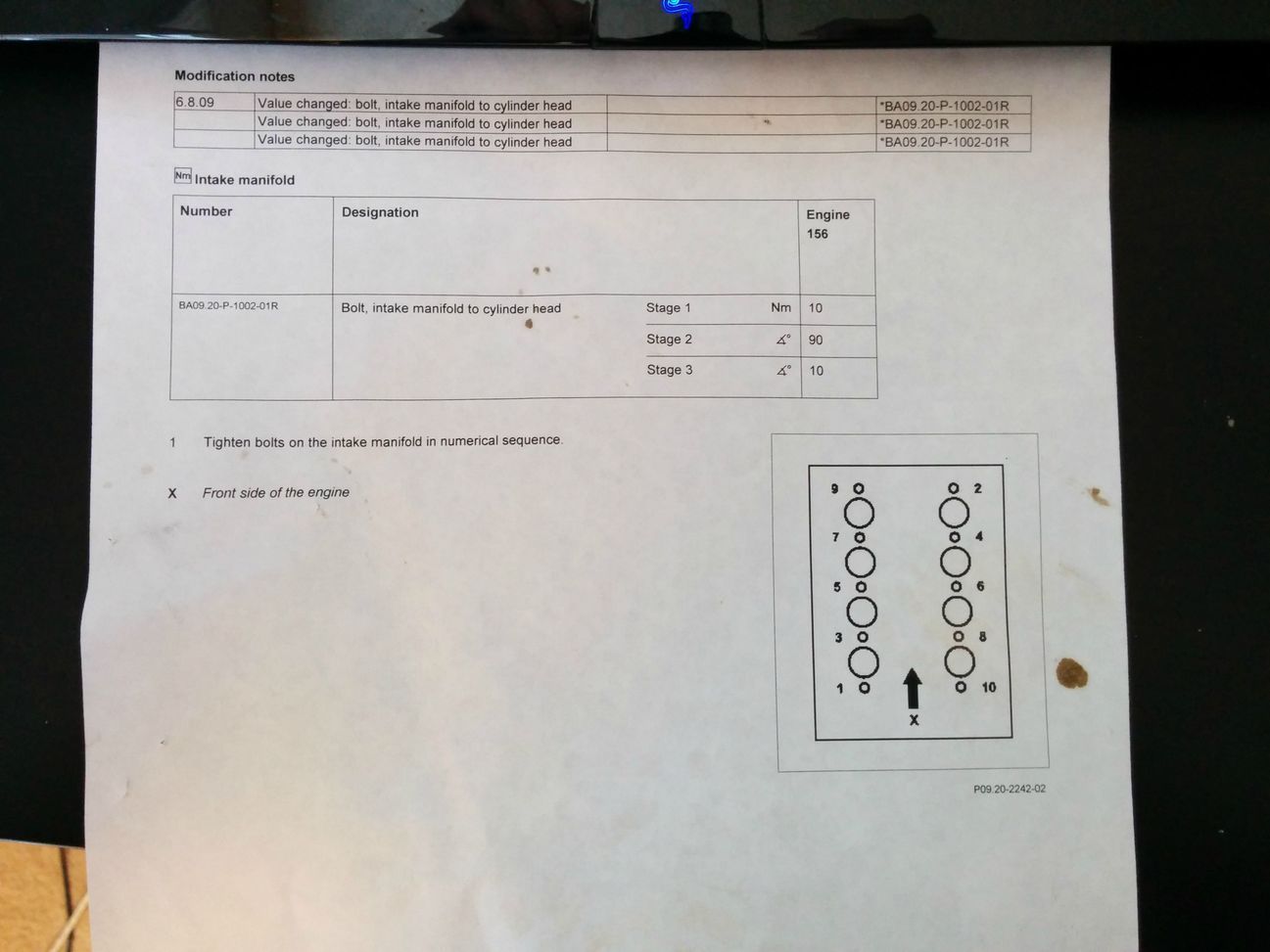

First hopefully you have new bolts they are one use only or will break 100%, 3 stages of tightening sequence attached..
First stage = 10Nm
Second stage = 90deg
Third stage = 10deg
I will look up the throttle body torque in a bit, think it might have been 8 or 9 nm
