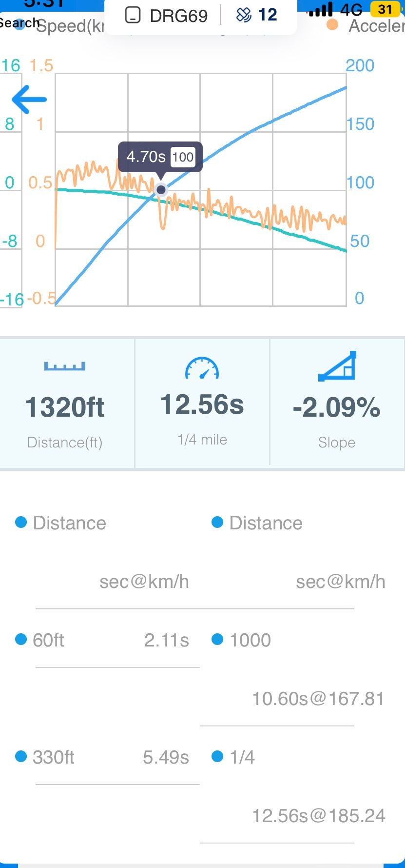

Hi guys, this is the best I could get of my car with eurocharged V7 stage 2 on 91 oct, cars got AFE filters, both the cats deleted and fresh Pirelli pzero tires…..I’m not sure if the tune is working…. Getting it on a dyno in few days….Any suggestions as of now would be appreciated Thank you

P zero tires are dog ****. We're you spinning like mad? This on the street or track ?

I believe your trapspeed is actually quite low.
It would be a good idea to dyno it to sort out some problems if you see any.
Mine traps slightly above 200km/h
Trapspeed shouldn´t suffer so much just because a bad hit from the dig.

They did offer good grip and very minimal slips….did it on a empty stretch with good Tarmac, I did close 20 pulls comparing stage 1&2 maps.

Hi, what’s ur setup and ur 1/4 mile timing ?

109 mph trap is too low something is wrong

low trap speed will outline that full power is not being delivered or being pulled to save the engine. you may have an issue mechanically or an issue with the tune itself.

Hi, I am running primary and secondary cat delete with stock reso and mufflers…. Is this setup bad for making power ? I will be changing to stock map and do few pulls…

If your stage two is designed for headers and you have stock manifolds running stage two it could pull timing. Even a tune only no other mods with a negative DA should be much higher than 109. You need to get your car checked out. How many miles on your car? Is maintenance up to date spark plugs ect ect. Maybe it’s an intake manifold gasket leak pretty common and can cause issues too.

I felt the car was better off in stage 1 and the shifts were smooth, my car has only 25k kms and have no problems till date,I have only serviced it in the authorised service centre…. Changing it to stock map with 95 oct and see how it feels, will update on that….

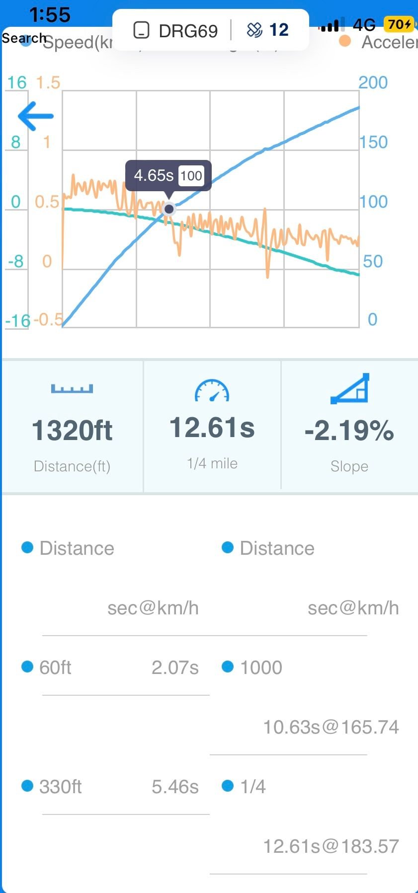

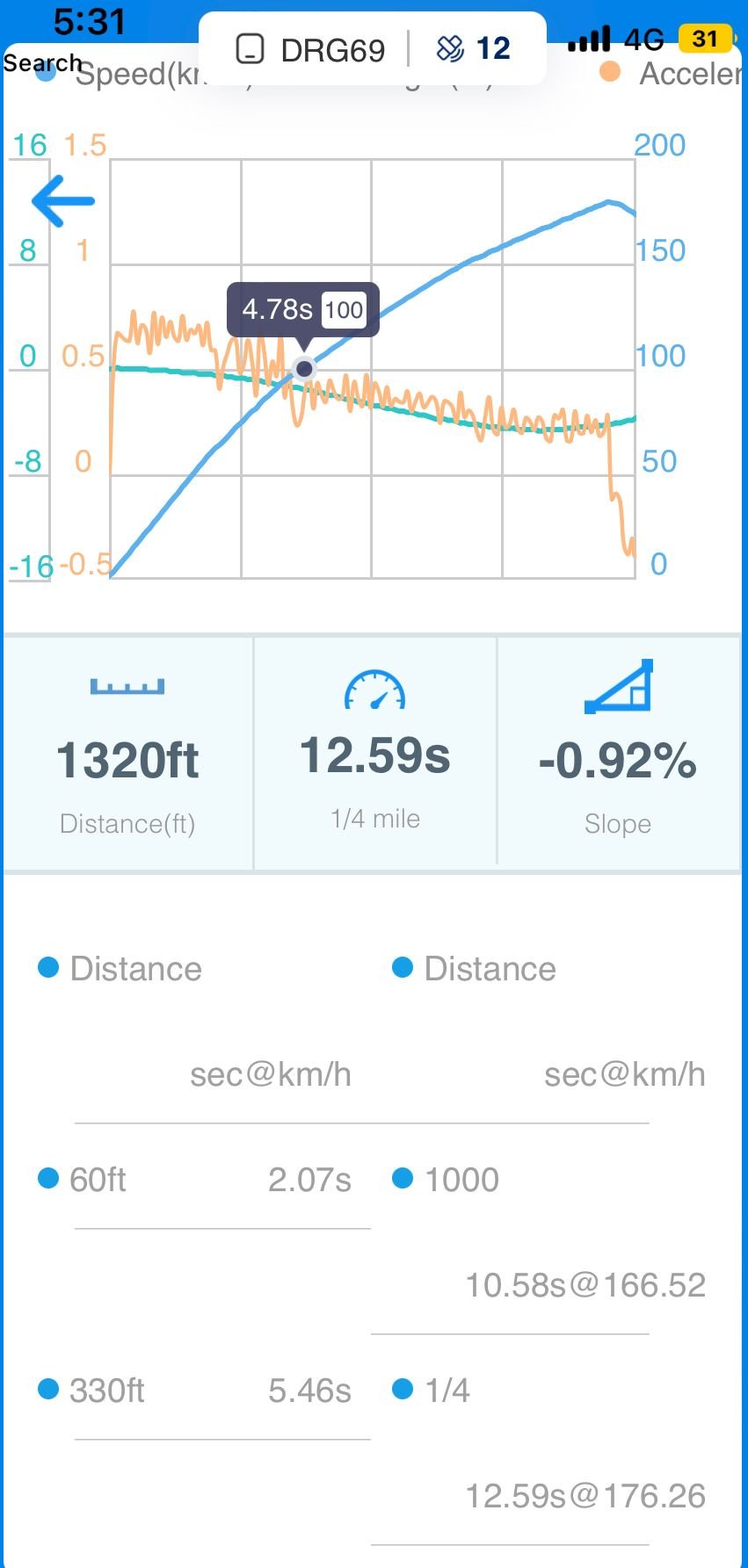

Hi guys, did a few stock map pulls on 95oct and itseems like I have a problem with my eurocharged v7 tune
