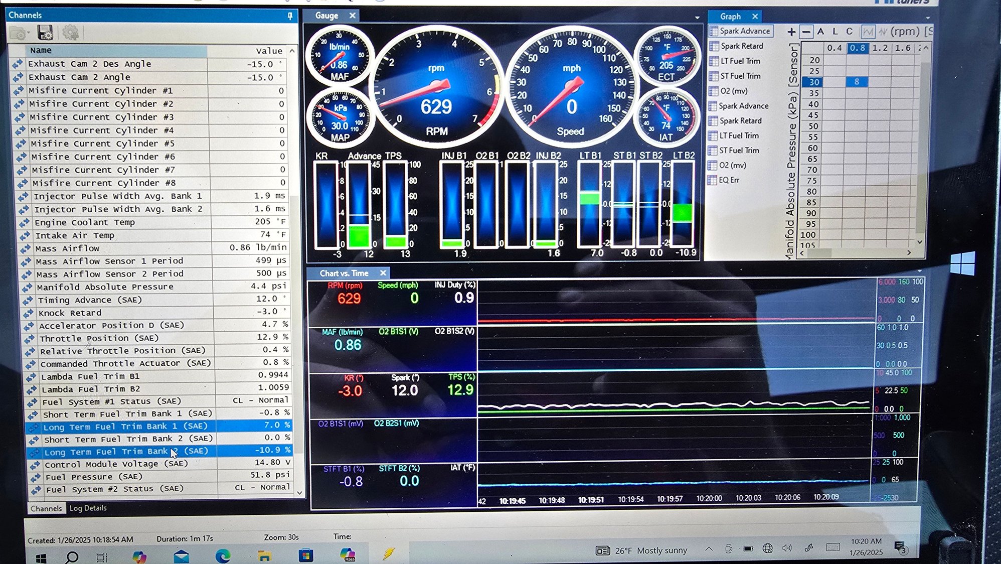

More updates, still no solution.
  • ECU tested fine, but ECUpros couldnt rule out a driver or main board or something being bad. I got my ECU back and continued testing.
  • Checked resistance and continuity on all cam position sensors, solenoids, coils, injectors etc. No issues that I could see.
  • Just got a replacement ECU from ECU Pros. Installed it. Zero change. At this point we can say with certainty this is NOT an ECU issue.
At this point the car has been down for a year. It runs and drive perfect with the cam solenoid unplugged. Im tired of messing with it and it sitting. Drove it all day yesterday and to work today with zero issues. Man its great to be driving it again, even with a check engine light.
I will continue to poke around with it, but i'm done letting it sit. Did take some logs while driving yesterday. it is interesting that the long term fuel trims on either bank are off by 10+% (one in the negatives, one in the positives). Will continue to monitor.

The next thing that popped into my head was I saw you had feedback knock stored at -3. I'm not familiar with this platform enough but on Subarus, which I do know inside and out, if a knock sensor is going bad or if you...for example dropped a bolt into the engine bay and it landed near the knock sensor it can cause similar misfire issues at specific RPMs. Subarus have a knock table that stores knock counts across load and rpm, not just a 1d stored value.
Check the knock sensors. They're on the sides of the engine, under the exhaust manifolds. Unplug them, you'll get a CEL but see if the car improves. Check for debris.

Quote: The next thing that popped into my head was I saw you had feedback knock stored at -3. I'm not familiar with this platform enough but on Subarus, which I do know inside and out, if a knock sensor is going bad or if you...for example dropped a bolt into the engine bay and it landed near the knock sensor it can cause similar misfire issues at specific RPMs. Subarus have a knock table that stores knock counts across load and rpm, not just a 1d stored value.
Good tip. Knock sensors are definitely on my list to check.

Quote: 9103835[/url]]The next thing that popped into my head was I saw you had feedback knock stored at -3. I'm not familiar with this platform enough but on Subarus, which I do know inside and out, if a knock sensor is going bad or if you...for example dropped a bolt into the engine bay and it landed near the knock sensor it can cause similar misfire issues at specific RPMs. Subarus have a knock table that stores knock counts across load and rpm, not just a 1d stored value.
Yep, this was my first thought too. With no real load on the engine you definitely shouldn’t be reading knock retard. Did you do headers on this car? Certain header brands can lead to false knock due to harmonics.

Quote: Yep, this was my first thought too. With no real load on the engine you definitely shouldn’t be reading knock retard. Did you do headers on this car? Certain header brands can lead to false knock due to harmonics.
I can't recall if that knock was when driving or sitting at idle, but i'll check.
Yes the car has longtube headers, but they were on the car for over a year and around 8k miles before this issue showed up.

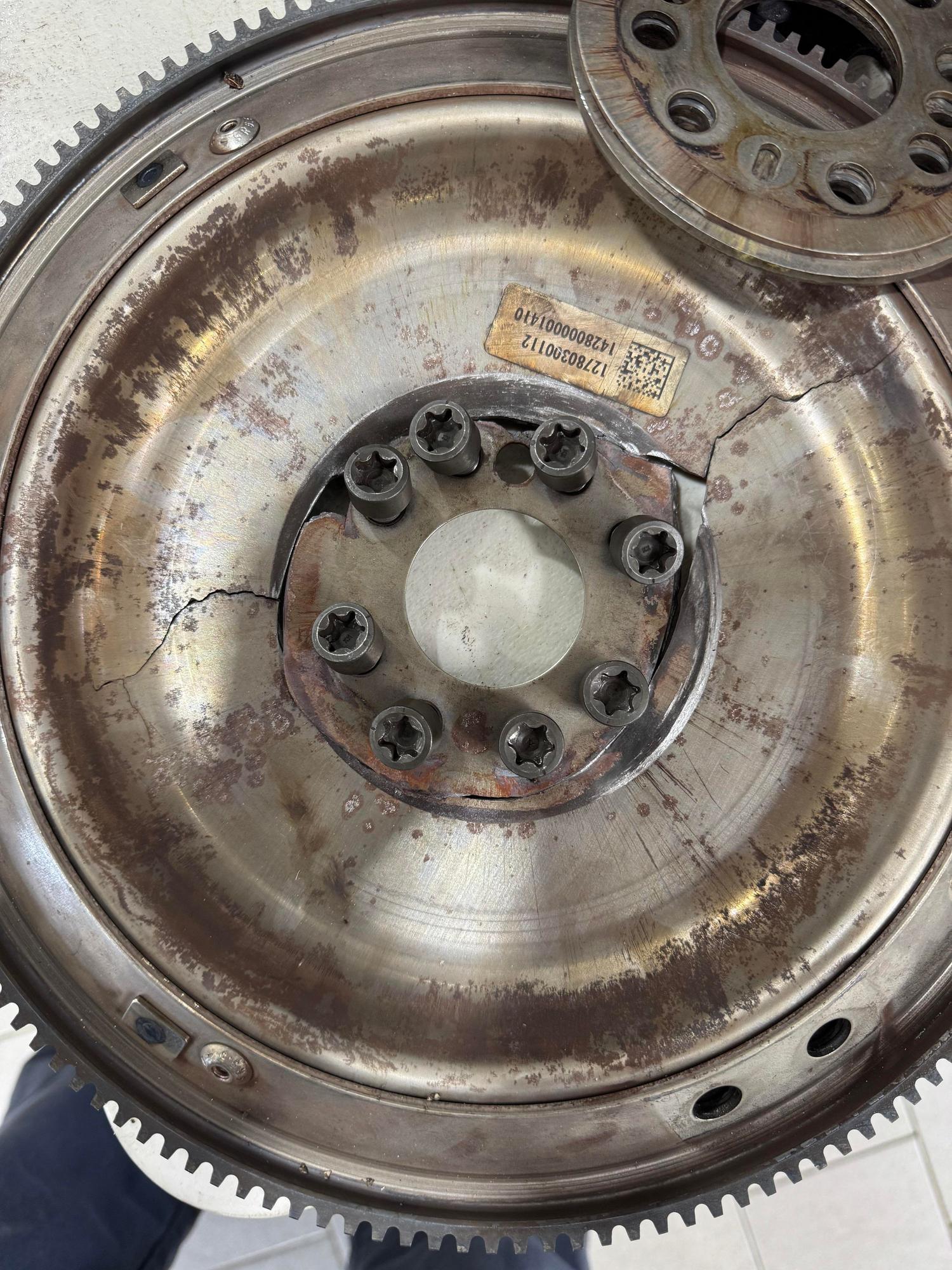

Just saw this on the r/AMG subreddit and reminded me of your ride, @MTBSully
https://old.reddit.com/r/AMG/comment...onths_at_shop/
A closer look:
Now I don't think that this could be your case, I've never seen anything like this before... but at this point, the symptoms he describes are similar to yours and it wouldn't hurt to check it out.
Just a thought, take it or leave it!

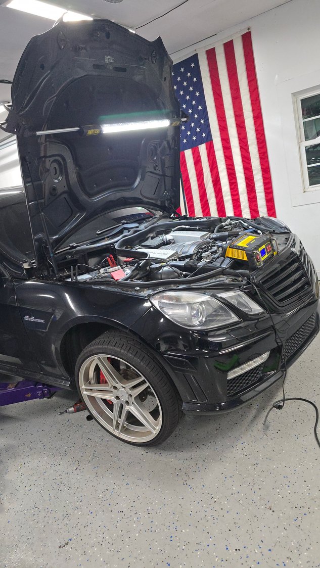

Back at it. I've been driving this thing for almost a year with the cam solenoid unplugged lol. Also coming up on 2 years since this issue first appeared. I think it finally time to figure this out once and for all.
Pulled it into the garage last night, got Xentry installed on my new laptop, HPtuners etc. Also got a new Picoscope so I can try and look at cam/crank signals and see if I have anything weird going on.
Over the past 6 months I have also picked up those new cam adjuster sealing rings, as well as a good used W212 E63 M156 harness from ebay. Im not sure if either of these things are causing my issue, but the sealing rings were cheap enough, and could be considered an upgrade/maintenance item, and the engine harness is not available new anymore, and impossible to find since they made so few of the W212 M156 cars. I jumped on it for a deal, just to have it.
Since its been a while, going to start with the basics: compression test, scope cylinders, maybe scope timing chain see what what looks like, etc. Then probably dive in with Xentry and also try to learn the Picoscope software.
Stay tuned...
