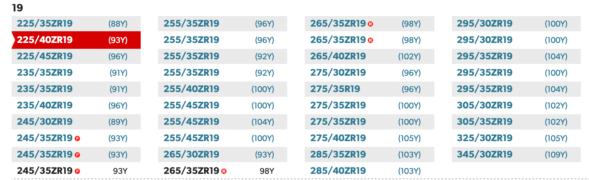

It doesn't seem Michelin makes the PSS or the new PS 4S in 285/30/19, should I go to 285/35/19?

fwiw, stock 19" Dunlops are 35 not 30
I am researching this also as I will need tires soon and will go to the new PS 4S and probably go with a 255/35/19 in front on stock rims.
My thinking on this is that Tire rack charts say the widest tire on a 8 1/2 in rim is a 255. It is .2 inch larger dia. This doesn't mean you can't fit a larger tire in the wheel well but it will not ride flat on ground with proper air pressure. Others have done it but that doesn't mean it is the correct size.
On the rear I am leaning toward the 285/35/19 as they also show it is the largest tire for a 9 1/2 inch rim. Several reasons for this 1). .6 inch larger dia. and will fill the wheel well a little more. 2). It keeps the 35 aspect ratio as this car rides a little rough as it is and I don't want to go with a 30 as it would ride worse even if it was available. 3). More rubber for some better traction we all want.
Maybe the best is to go with a 275/35/19 but it would not have the traction the 285 would.
I know this goes up 1 size on front and 2 on rear but I don't think it will be a problem except on track and maybe not there.
Speedo will show 80 mph when you are actually going 81.8 so watch your speed (2.3%)
Remember these tires are for areas that don't dip below 40 deg F
