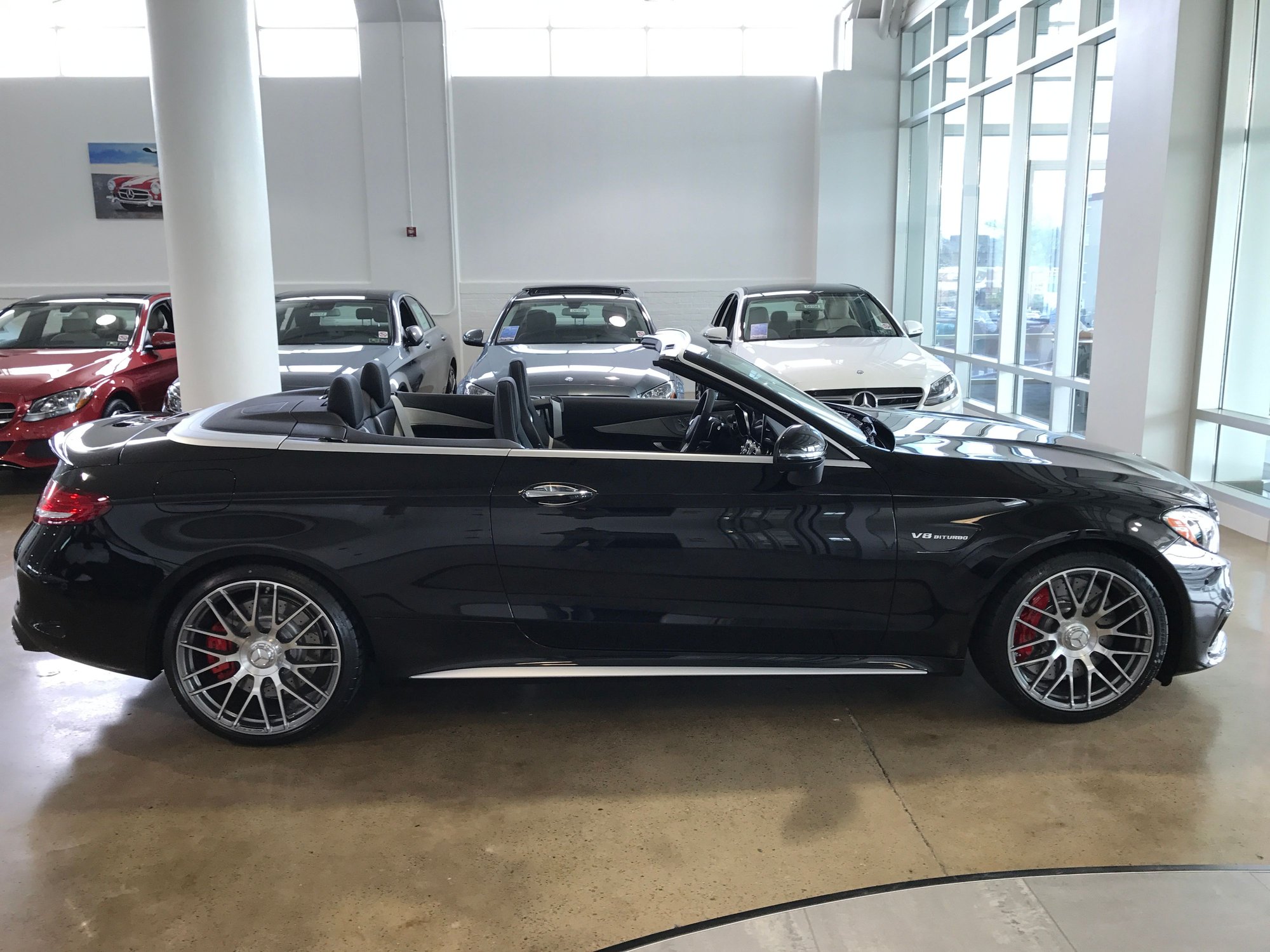

So I picked up my 2017 C63S Cab today and the AC broke in 10 min. Blows hot air. I returned and they ran a diagnostic and it needs a new compressor. The entire motor most likely needs to be removed to replace. Needless to say it was a disappointment. It goes back Monday If the part is readily available. I hope this is not a precursor of things to come.

Engine does not need to be removed for the compressor on those cars. We had a brand new C63s coupe, sitting in the showroom, have a compressor fail. Replaced, good as new.
The variable displacement compressors we use now have a small control valve that sticks, causing the compressor to not activate. That's how they fail, but unfortunately the whole compressor must be replaced as benz does not sell the RCV separately. I just did one on a 204 thursday for the same failure.

Yes I know things happen. I'm pretty easy going. Nice to know they don't have to drop the engine to replace the compressor. now I just can't wait to get 1000 miles on it so I can rip on it.
