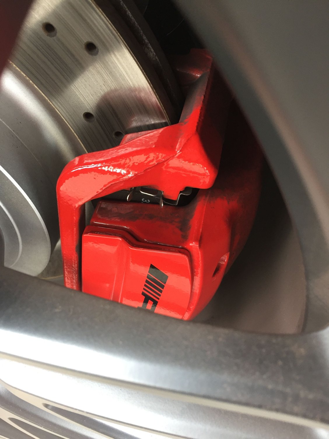

My wife is out with the car this evening. I'll post pics later this evening around 8PM CST. You'll notice the caliper and the pads are different in preventing your pads from fitting.

Here's pics of the 2020 rear brake caliper. Those with older calipers (2018 and older?) will notice the difference.
