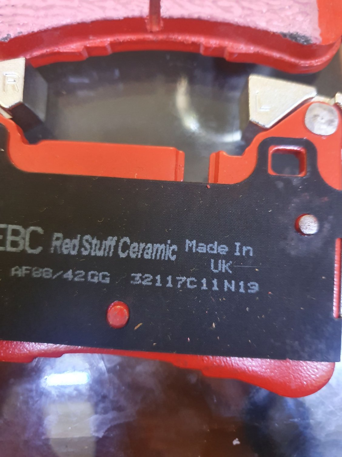

DP32117C are the ones on the picture no? That's what I've ordered and they are incorrect.

Yes they will fit the non- S c63 with silver calipers but not the red ones, its completely different.

This is what i recieved. Note the part number.

here is the correct part number for EBC: DP32234C

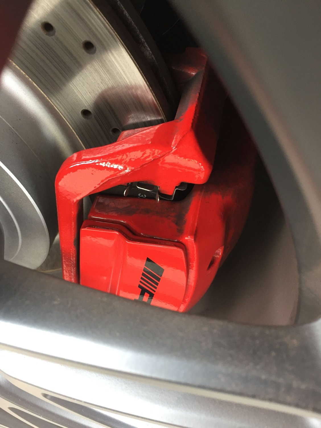

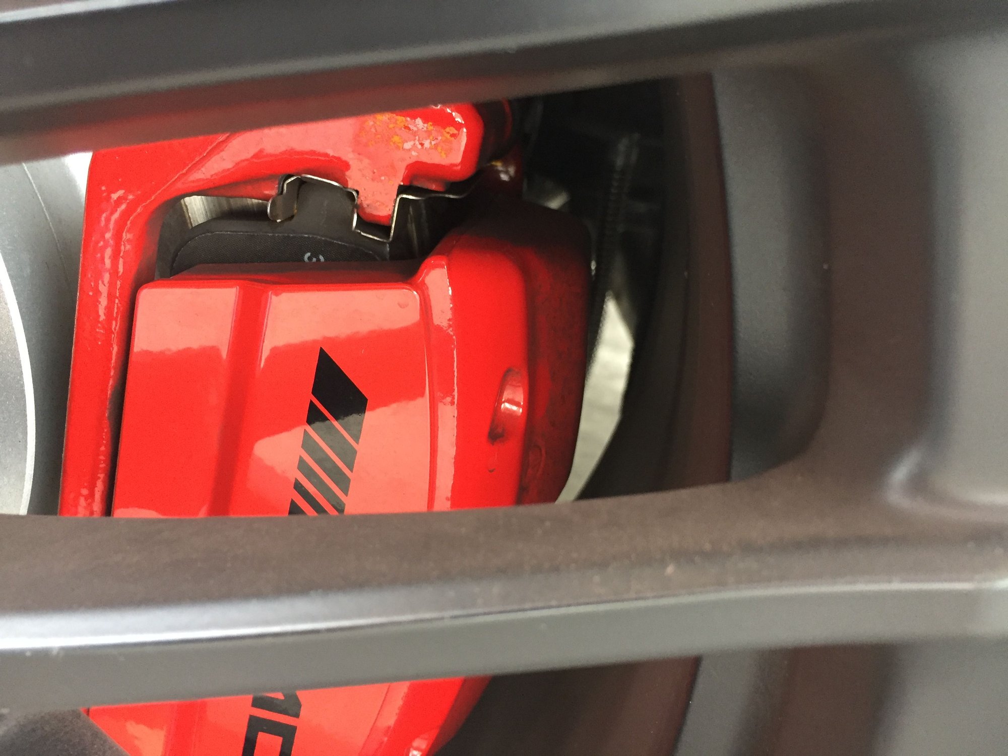

Originally Posted by PaulC63s
Will HB830Z.667 work for the rear? Im returning my rear EBC red stuff as they are completely different than OEM. I guess they send me the silver calliper pads.
PaulC, notice my pics of the rear caliper/pad from two views. We have the same type pad which is different from earlier years. Maybe somewhere in 2019 they made the change? Anyway, I can't find the correct rear pads either. I did notice a very similar setup on the AMG GT class. Maybe the rear calipers are the same as them? For the rear anyway...

Notice the color of my caliper is RED? Notice up close the rear pads have those "old fashioned" side tabs that fit into the slot? Polished metal spring holding it in place?
I don't belive any aftermarket supplier has picked up on this yet. So unfortunately, it's probably OEM for the time being. I did reach out to Porterfield and was told to take a pic and they'd try to match it up. Nah... I'll wait until it's 'official' by a name I trust.

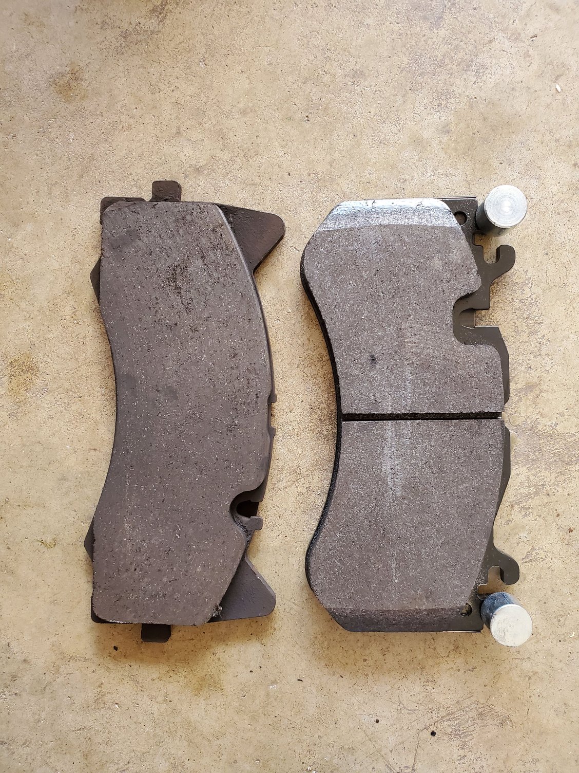

ok so the brake pads you have on top that's how mine are and I have the silver calipers no s c63. The part number I put for hawk fit mine so they should fit yours since they're identical. Now for the front, they send me the brake pads for the s version, 390mm, so I'm returning those since they are completely different than mine.
