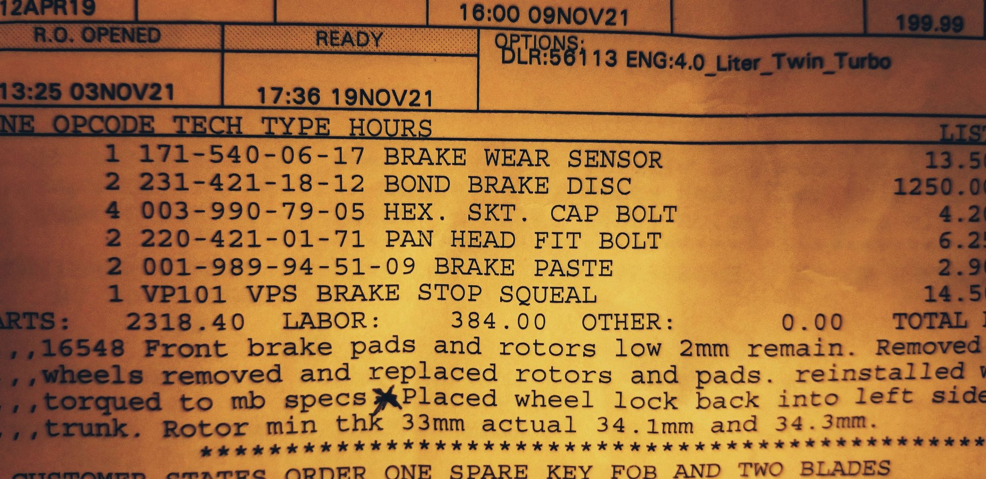

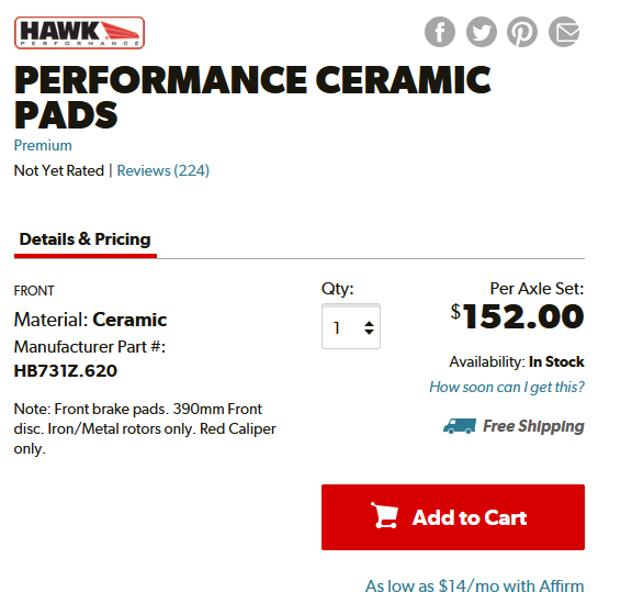

I bought these pads from Tire Rack for my 2020 C63s and my installer is telling me that the front is the wrong size and also the pads should of came with silencers. Also since i have a electronic parking brake that his computer will not mirror up with my car for the command code ?. I verified the part number with Porterfield website as well. Thoughts?
and my installer is saying the front pad is wrong and I also verified the part number with Porterfield. The next thing is that he's saying they should of came with a silencer, is this true for the 2020 C63s ?
Recently I had front brakes and rotors replaced at MB Dealership for 2019 C63s. The 2 Invoice photos below shows what parts were used with Part #. Don't know about a Silencer? Hope it helps.

Appreciate it, yep I had the part number but cant seem to find the size. Im good though, I will just returned the pads and will order Porterfield pads
