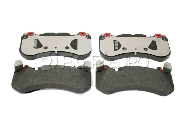

Anyone get porterfield pads for C63S red calipers? I ordered AP1291 as people mentioned above and it seems like they send the wrong one or it does not fit. The NON-S brake pads have the two metal cylinder thing correct?

Quote: Anyone get porterfield pads for C63S red calipers? I ordered AP1291 as people mentioned above and it seems like they send the wrong one or it does not fit. The NON-S brake pads have the two metal cylinder thing correct?
Yeah I recently switched to Porterfields. They prob sent you the wrong ones because I too ordered AP 1291 and 1669 and had no issues with fitment.

  #100
Quote: Yeah I recently switched to Porterfields. They prob sent you the wrong ones because I too ordered AP 1291 and 1669 and had no issues with fitment.
the ones for red calipers look like this right:
