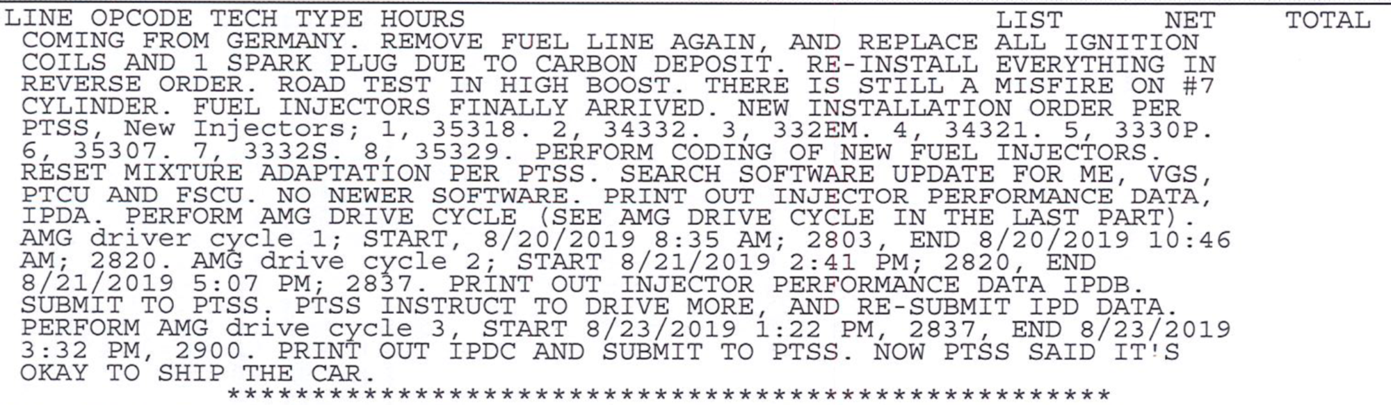

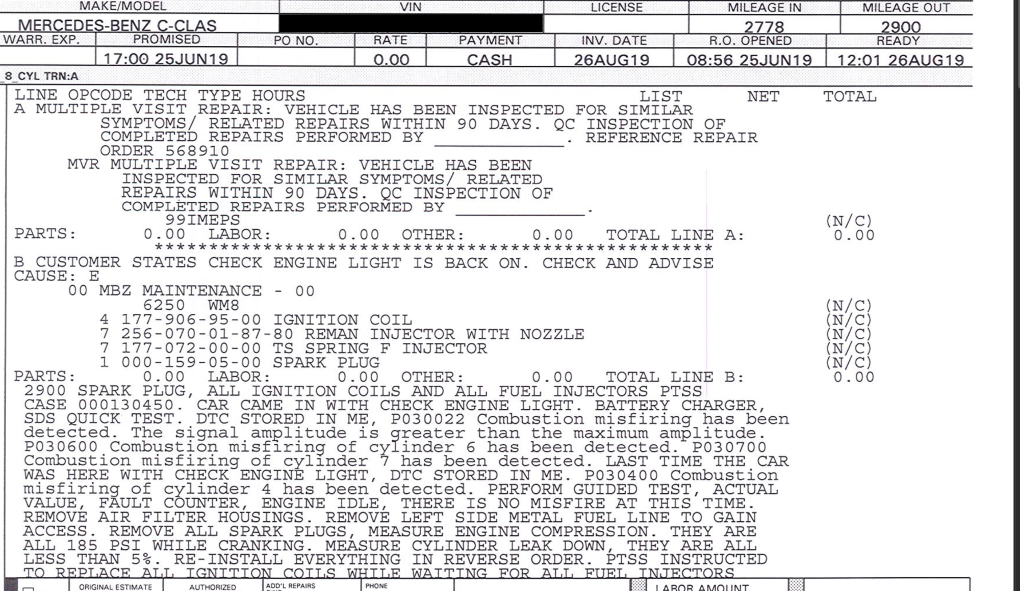

FINALLY!!!!
I was able to pick up the car earlier (after 69 days) and was told by the shop foreman to enjoy the car (no driving restrictions since I've already passed the break-in period) and I did!
I drove the car aggressively for 5 miles to my office and didn't notice anything but lots of joy!
Below are the RO notes in case you're curious. I'll keep you posted if anything comes up with my situation.

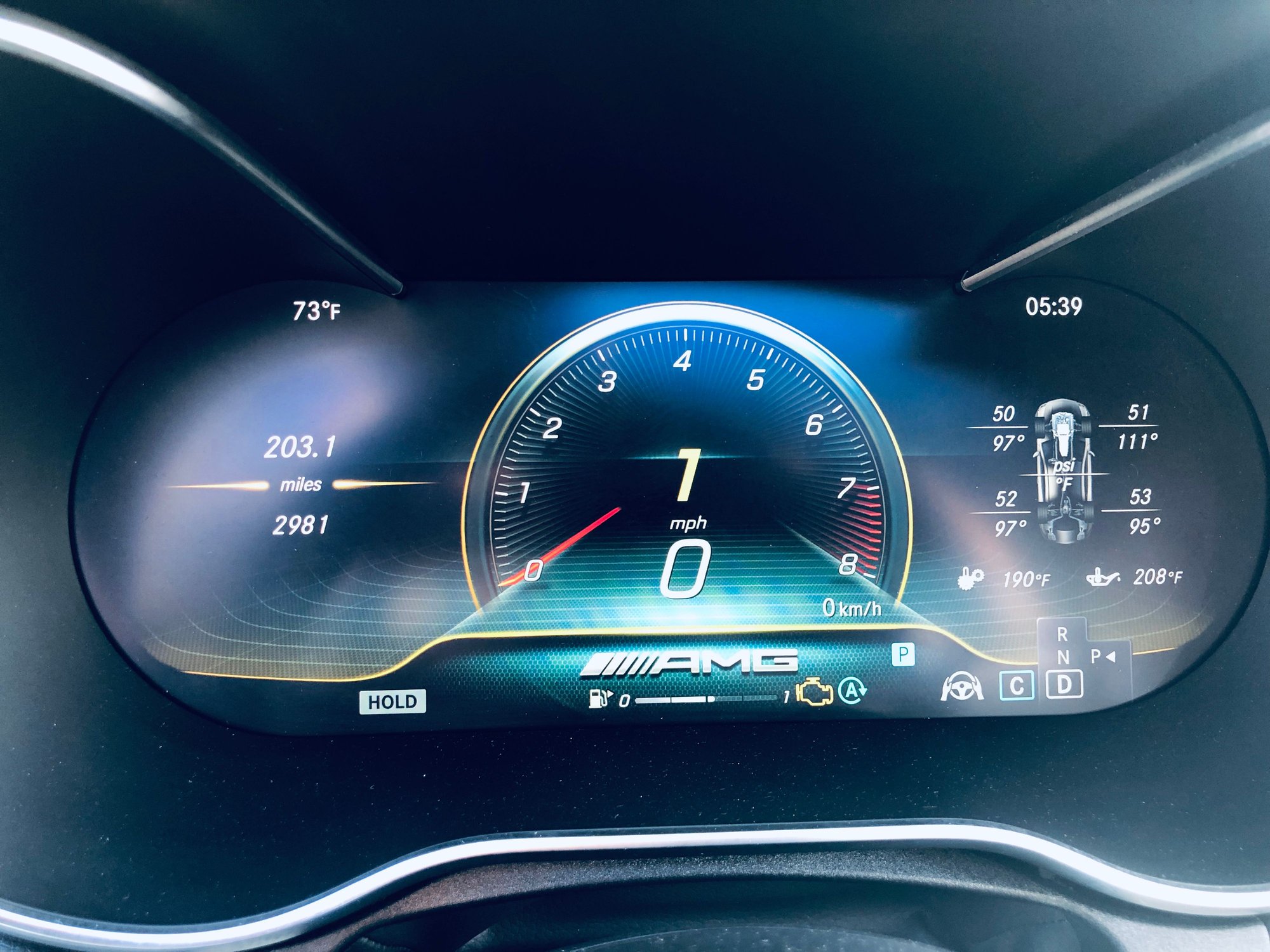

Will you believe if I tell you I got another misfire earlier today?
I drove the car aggressively (for the first time) and got a misfire followed by solid CEL and after rebooting the car, everything went back to normal and CEL went away.
Drove the car aggressively again and no issues. Trouble is, I need to find a better place to avoid obeying the laws and push the car very hard and see if the issue comes back.
At this point, I went ahead and notified the dealer but will drive the car over the weekend and see if the issue comes back. Any suggestions/ideas?
