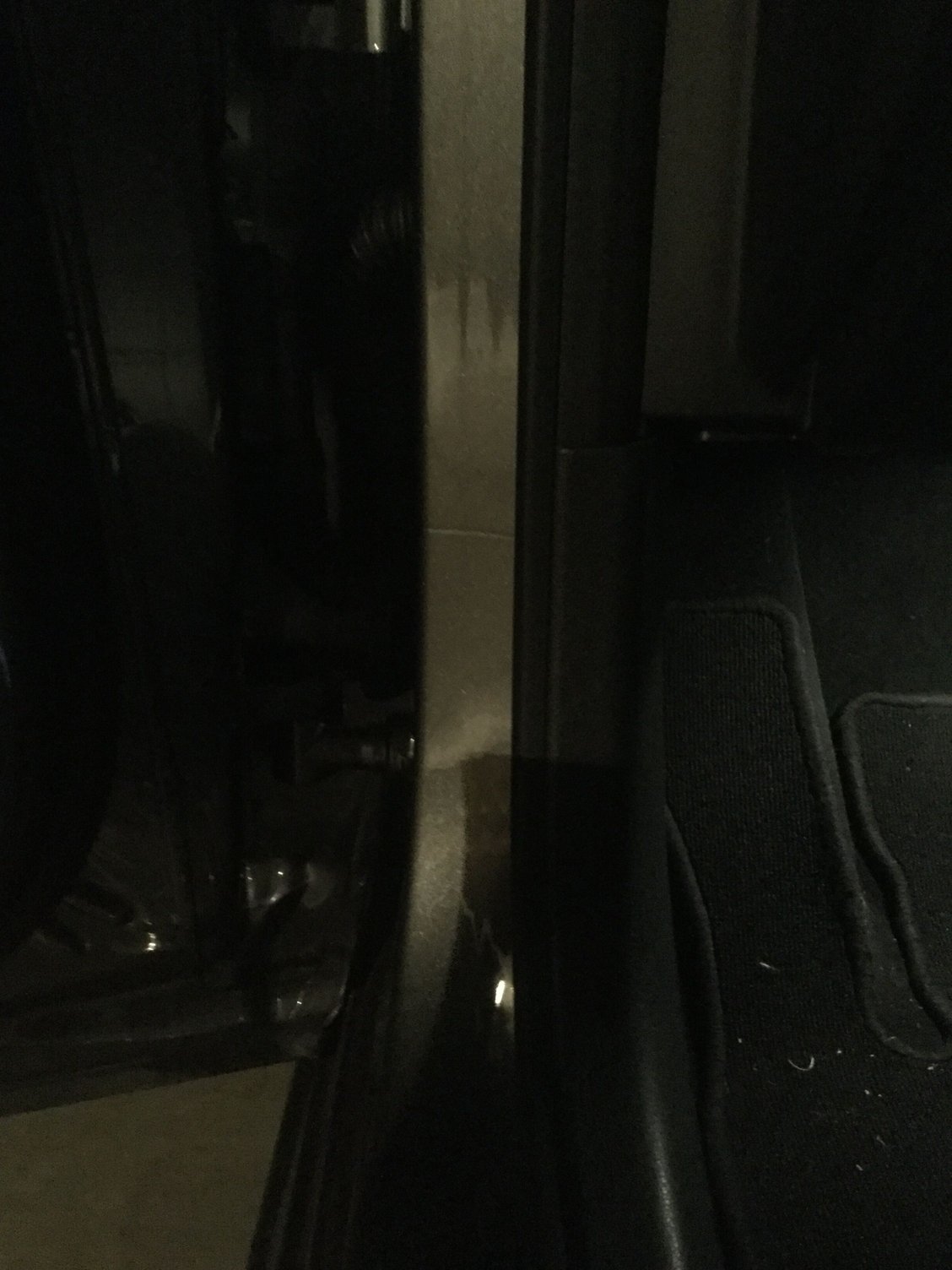

Hey guys,
I'm looking to purchase a 2017 C63S AMG from a CA dealer (non-certified) and noticed this in my inspection. The front pillar frames had seams in them (like cuts). I haven't noticed this in other Mercedes before and would be curious to know if anyone in this forum knows whether this is standard in this car or whether this is a sign that something has happened structurally?
Relevant details:
Carfax is clean, drives well, front hood seems repainted (edges feel a bit rough) but dealer says it isn't.
Appreciate any feedback here.

Definitely looks like something is off. Others can confirm.

For further clarity, this is the pillar that is seen when the doors are opened.

Just checked my 2017 Coupe. No seams on either side.
There you go. Great catch on OP's part. I don't think I would have noticed.

KAHBOOM - appreciate the check. Any chance you could send through an image?
Munis, appreciate the assistance.
Looks like I'll have to walk away from this one.

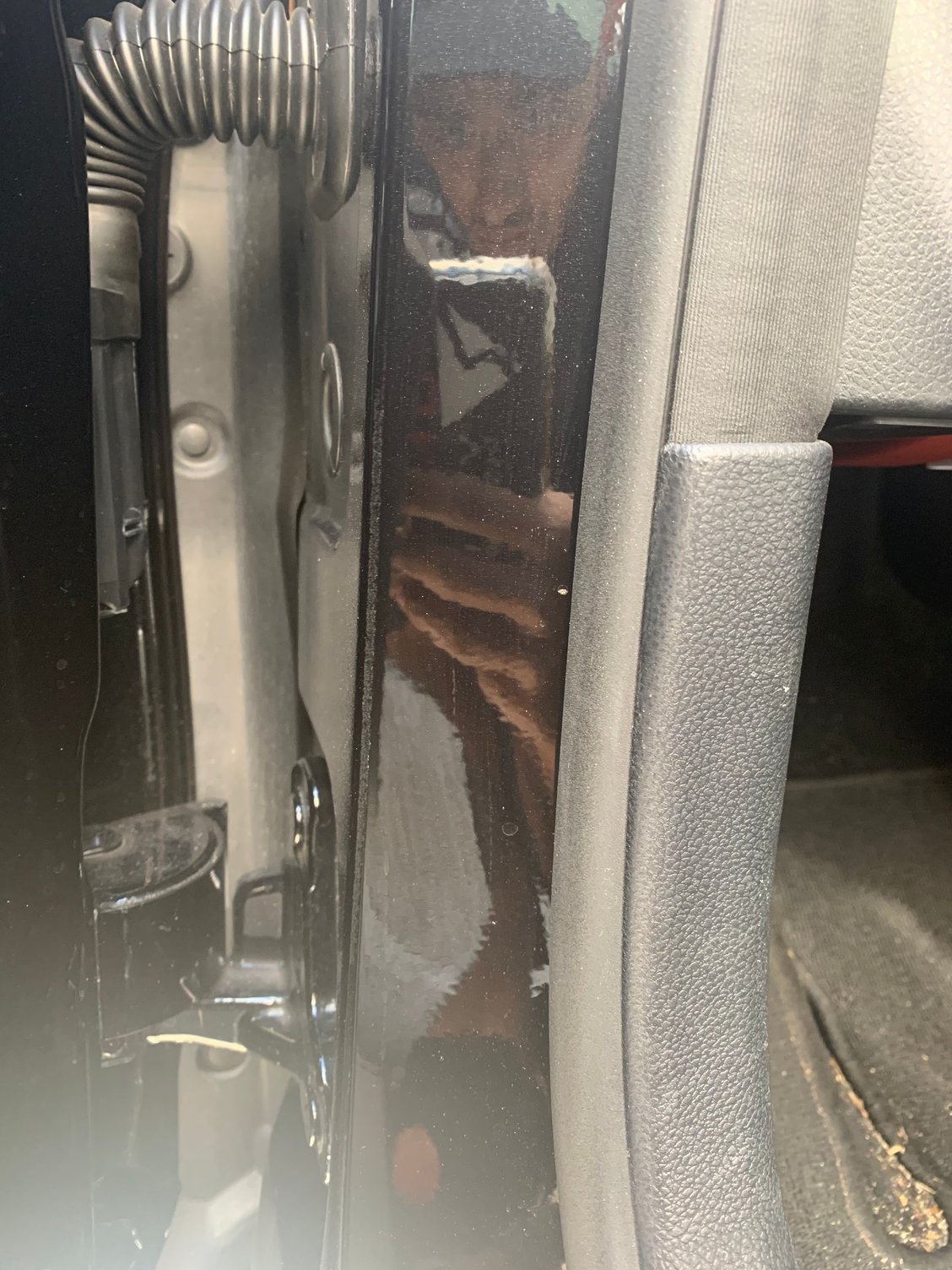

They are hiding something. I just checked my 2016 sedan also and no cuts or seams present just dirt cause i need to clean her lol Pictures attached.

Wow, I though I had a "good eye" for detail!
... and the plastic (rubber?) wire covers look completely un-dusty, likely indicating they're new/replacements.

Sure thing.. When I leave the office I will take a pic and post when I get home.
^ I see that Oliver also took a pic of his Sedan so this will confirm no seams on either configuration
You do have a really good eye for detail. I looked at these pics several times and didn't even notice the pristine wire covers. Run away !!!!

Great eye guys, I didn't even notice the fact that the piping was clean.
And thanks for sharing your car images.
I decided not to pursue with this dealer and got a certified pre-owned from Fletcher Jones instead - problem solved. Suffice to say, there wasn't a seam in the one I picked up!

My 2017 has a seam like that in the drivers side pillar but not the passenger side. Also has no accident damage and it doesn’t appear to have been repainted anywhere.
