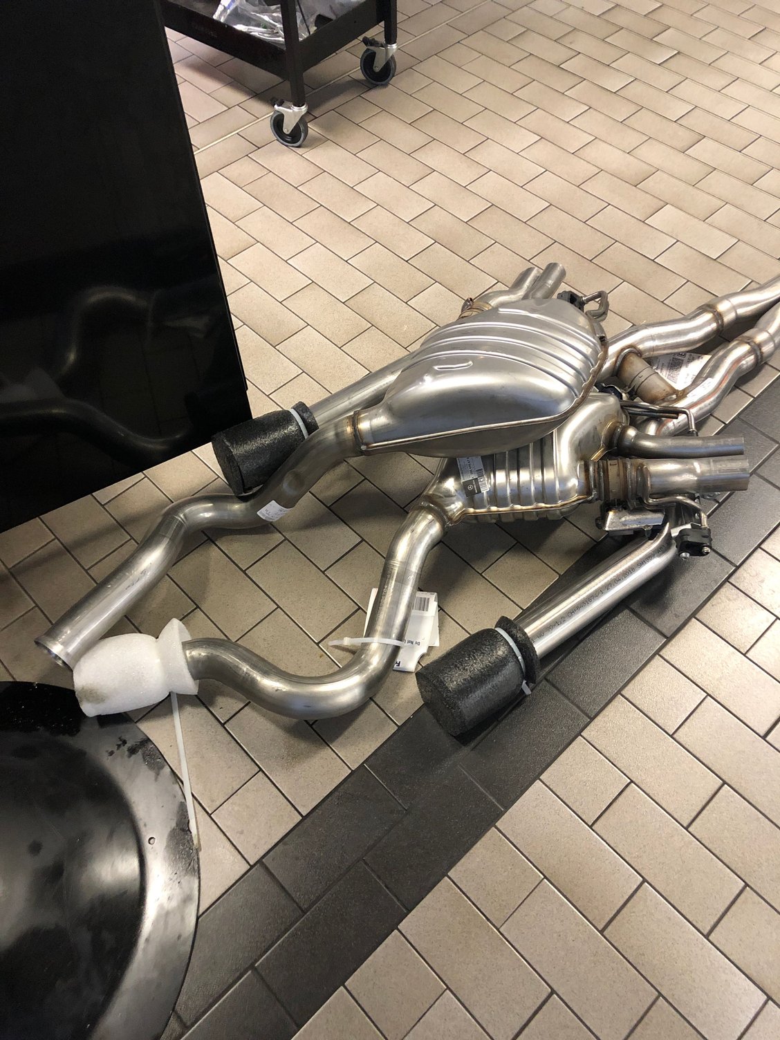

Here's pictures of my replacement exhaust
Only bulge is near the tips at the end

That picture doesn't show the cats at all.
What diagram were you able to find? Any site I can find that shows such diagrams has the same image for the 2018 and 2019 and both show two sets of cats.
I'd be really surprised to know I cut so much out and have had no problems at all.
