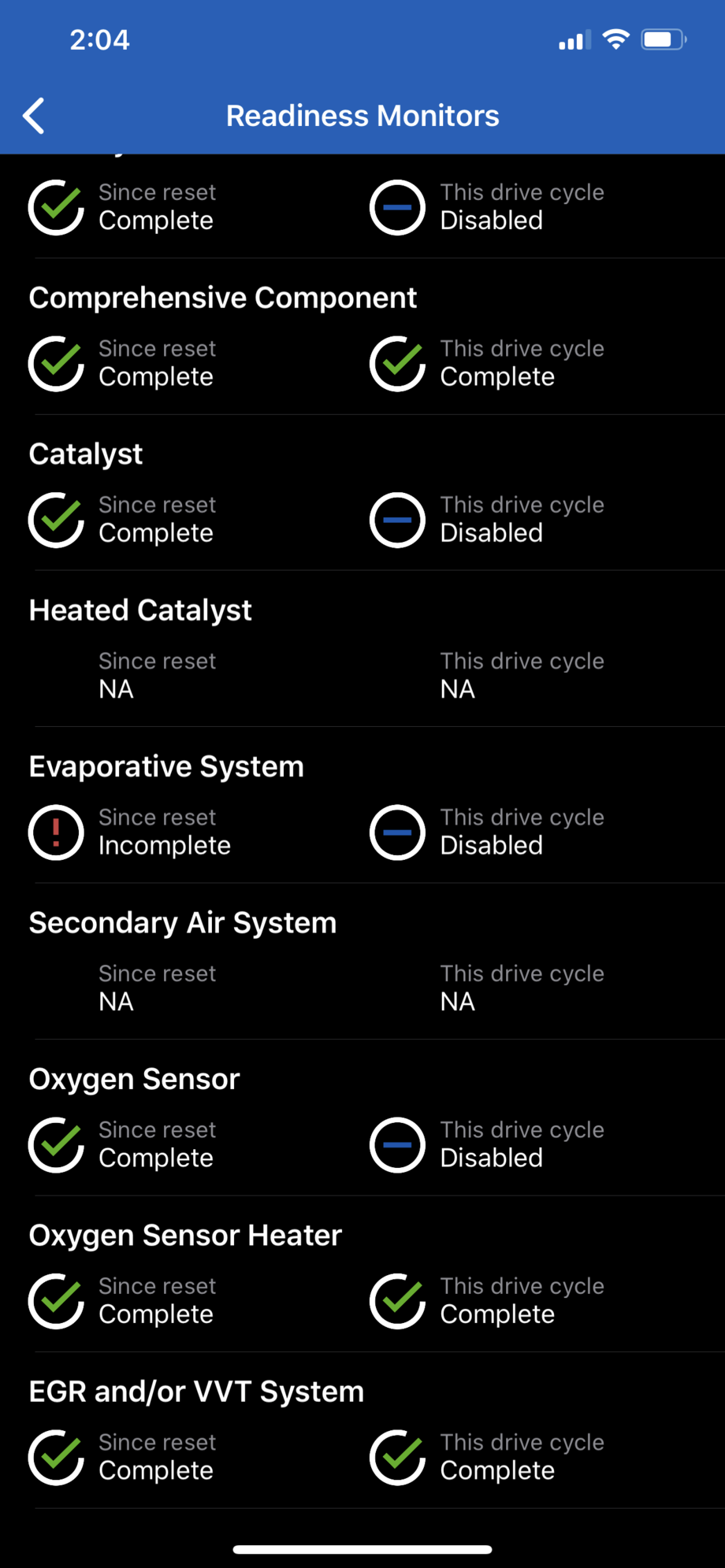

The mini cat spacers did the job, I've driven the car over 300 miles over 4-5 separate drive cycles and no CEL. Before the spacers, the CEL came back on after about 50 miles after clearing the CEL.
This is what I ordered, they are smaller spacers than usual but if you have catted downpipes this should be more than enough: http://www.bigdaddiesgarage.com/mini-cat-cel-fix.html
Order x2 of them obviously, one for each post cat sensor.
The spacers fit well, the installer said the driver side cat was more difficult cause there was less room because of hosing/wires but they got it to fit on both sides. I'd imagine bigger normal size spacers would've been even more difficult. Order x2 of them obviously, one for each post cat sensor.
it was the strangest thing I asked them about the spacers and they canceled my order and told me that their products would not work for me I’m not sure why I’m getting this answer but I’m getting those spacers one way or another
Any further updates? Still good? I am getting mine installed tomorrow.

Hallelujah!!! It worked!

Nice! After 800 miles or so since the spacers were installed no issues at all. Had the car serviced for 10k miles and no issues. Spacers work as advertised.

Got a CEL too with Armytrix catted DP so ordered spacers as well. Can anyone tell me how to install them, please?
most of us that got check engine from Downpipes are going with these from big daddies garage. 2 guys on here so far have fixed their check engine lights with these and I’m getting my set installed on Wednesday. Having my local shop dynocomp throw them on for me so I can’t really tell you how exactly but they told me it should take less than 1 hour to have them installed so not expensive
