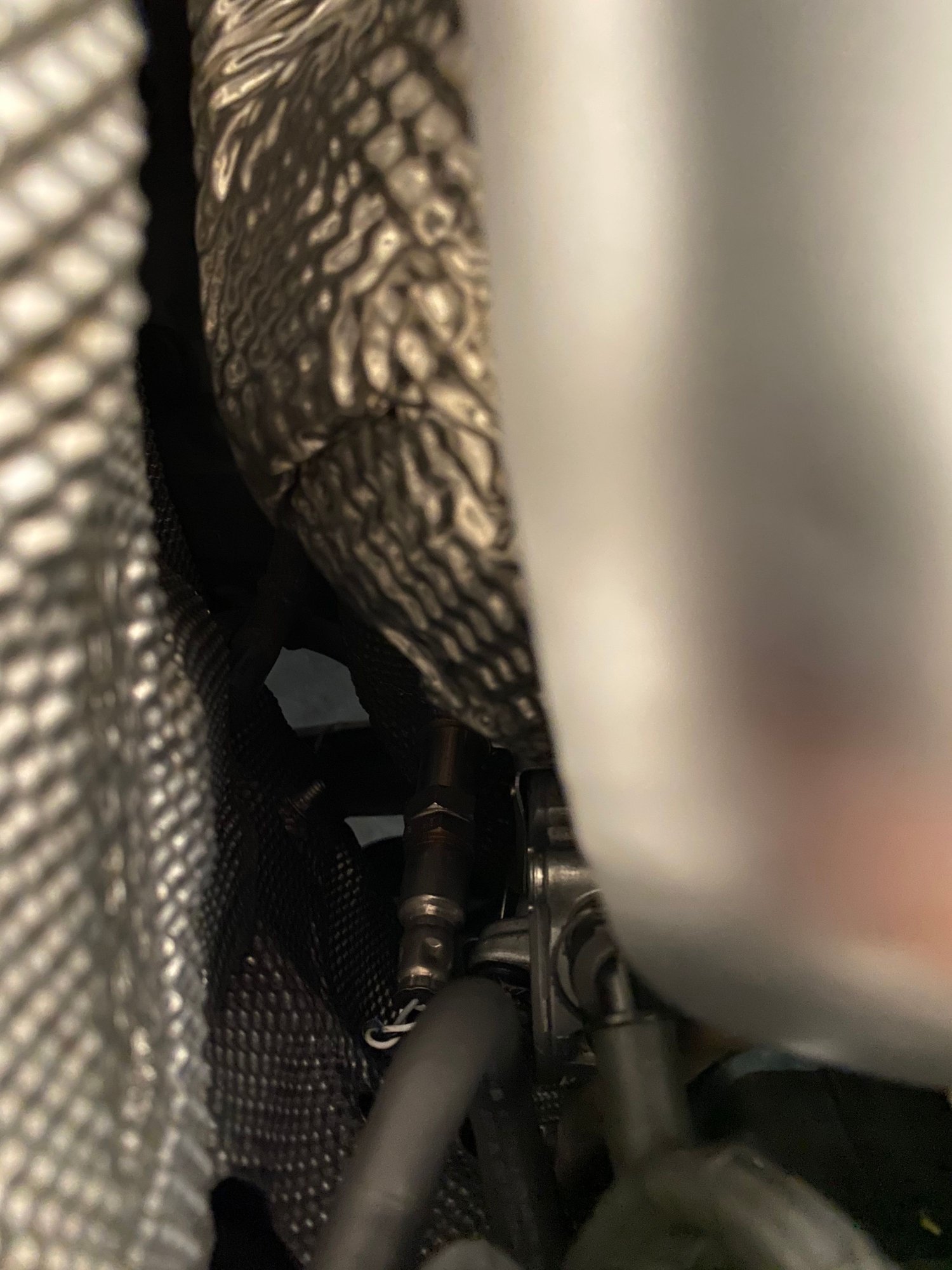

so I have the Modal Catted DP and the Big Daddies spacers and my shop (they have done several W205 DP, just not Modal) and they cannot get one side in. Any ideas? This is what they sent me:
"One thing we wanted to let you know is that the O2 Spacer you provided us does not fit with the limited spacing around the mid-pipes. It is physically impossible to make it fit as it hits a coolant line without the O2 Sensor even installed. We're assuming the forums that you've read must have an aftermarket exhaust or modified their exhaust as there is no way to make these fit."

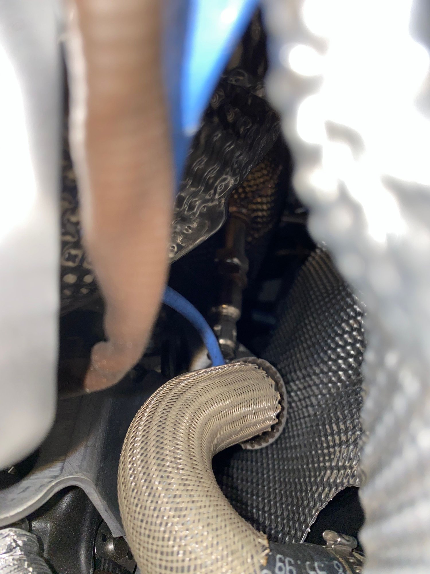

So this is what the shop sent me as to the spacing and coolant line. I don't know how you guys were able to get it to fit.
I don't know if there is value in running one spacer at this point, just frustrated that after going with catted DP and getting the spacers, still have issues.
Pics attached.

So it looks like the O2 sensor is off center from the hard coolant line, whereas on mine it is pointing right at the coolant line.
My shop said that the DP are typically made on a jig, so a little variance on how it is secured could put the bung on a different angle or position.
The other possibility is that my coolant line is different - I have a 2020 C63S, what year are yours?
Regardless, the CEL was off for the drive from the shop to the dyno, but when I had it put on the highway, CEL on. Annoying.
Did pre and post dyno with intake and DP, no tune. The intake gives a wicked induction sound, might even grab the Eventuri CF ducts. Hope to have maps tomorrow. The shop is in the process of transitioning to a new location, hence temp appearance.

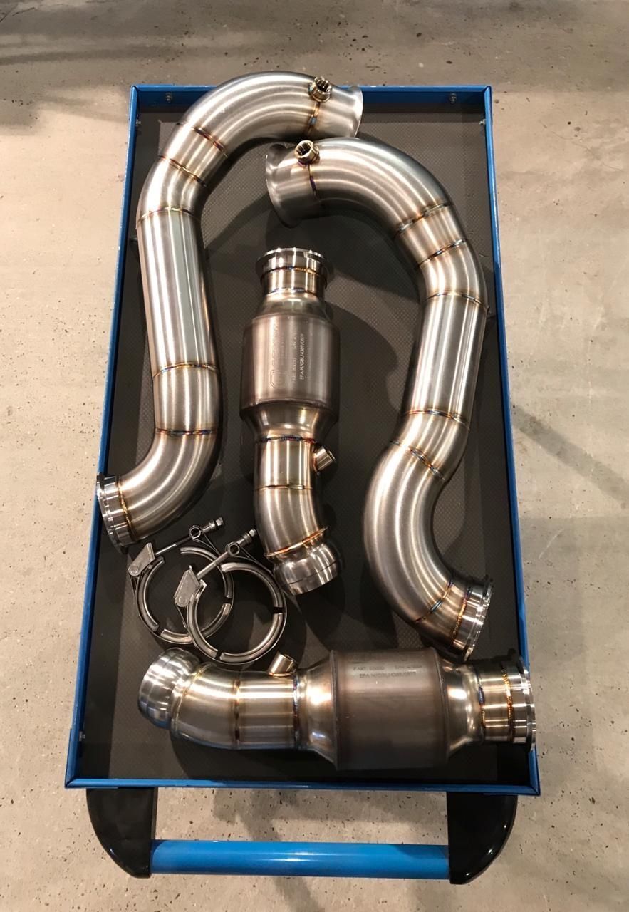

I did some research and found Shardul’s DP offering with Gesi cats might be good choice.
Unlike most catted DP, his has Gesi cats installed on further down the pipe where original secondary cats are placed.
Also, O2 bung location is moved to accommodate new cat location.
I think by having O2 bung moved down, there is going to be much more free space allowing easy install of O2 sensor with spacer.

That is correct. Any downpipe with high flow performance cat in any location will throw cel. That’s why you have to use bigdaddy mini-cat spacer to eliminate cel.
But having high flow cat in secondary cat location instead primary will most likely let you pass California smog visual inspection... but that’s something I only have to worry after 8 years.
