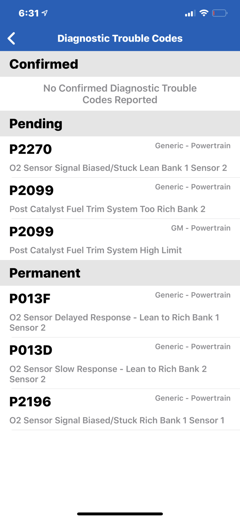

Installed mini cats from Big daddy Garage and still throwing some codes any ideas? Thanks
Give it some time. I did have some pending codes that eventually went away.

hey guys brother I recently got the modal downpipes installed as well with the big daddies spacers and it took care of the two original codes I got PO420/PO430. But now as you said a couple more codes have popped up mine being P2097 and P0136. Was wondering if you had to do anything further or if these lights ended up going away. Please let me know I am very interested

hey there elite I noticed on a previous posting that you had also noticed some further codes after you installed your Downpipes and spacers. The original codes are taken care of but there are new codes that I referenced in my last post (P2097 and P0136). Was wondering if you had a similar experience and if you did anything further to get rid of the check engine. Seems when I have it cleared it doesn’t come up for about a week. Please let me know what you think I’d very much appreciate it
I did notice some pending codes but they ended up clearing on their own. I haven't done anything else to the car. I would say to put more miles to break in both the new High flow cats and the cat material in the spacers.

Originally Posted by elitex
I did notice some pending codes but they ended up clearing on their own. I haven't done adding else to the car. I would say to put more miles in the case to break in both the new HPC cats and the cat material in the spacers.
did those pending codes give you a check engine light or were they just visible when you plugged in your scanner?
Just visible in scanner. No CEL.
gotcha see mine is causing a check engine and I’m not sure why, they seem to be similar codes to what you had but fewer of them I’m not entirely sure.
