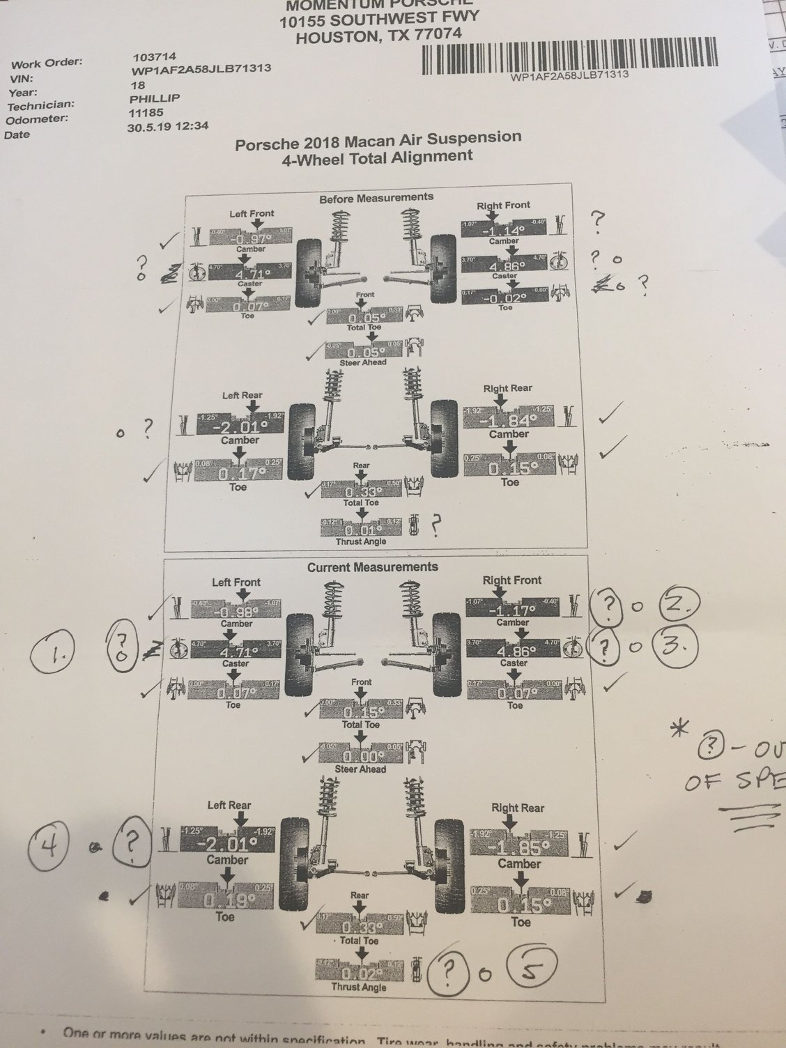

Regarding alignments, what makes you think your cars are aligned correctly from the factory? You think they are? Take a look at my pic. It's the before and after measurements. Note that this is on a brand new 2018 Porsche Macan Turbo which I purchased. Also note that Momentum Porsche of Houston never completed a proper alignment the first time though. Had to bring it back a second time.
Now with a 2020 S coupe and reading this thread, I wonder if I should have the alignment checked on this one as well.
I would definitely recommend to check the alignment after you put some miles on it. I waited too long till the first service. What many don't realize I think is that a new suspension settles over time. The alignment may be fine at the time the car rolls off the production line, but then as it sits and especially as it's being driven the suspension will settle over time and the alignment may be off afterwards. They do have tolerances and one can hope that the settling of the suspension doesn't push the alignment outside of the tolerances, but there is no guarantee.
I'm curious; did Porsche cover the alignment costs given it was delivered with improper alignment?
You can definitely have all sorts of quirks in a new vehicle that need addressing. But in my specific situation, 2 years and 22,000 miles later, my alignment specs were still dead on, and I had to replace all 4 tires (esp the front two) due to the cords starting to show on the inner aspects, with a lot of treat left on the rest of the tire. Aggressive suspension setting wear pattern. Par for the course. And the high end performance shop as well as the high end wheel & tire shop both told me this is typical wear they see due to Mercedes' aggressive factory suspension settings.
Never thought to pursue that. I was actually too pi$$ed. And, at that point, I just put them out of my mind and never looked back. I see them today as a learning experience.
