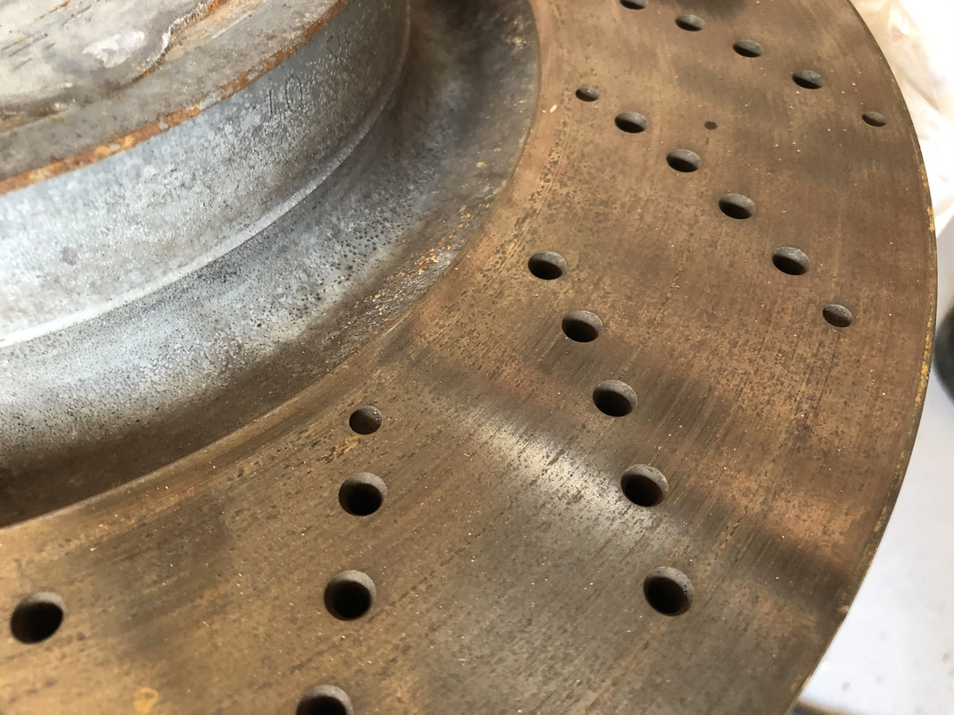

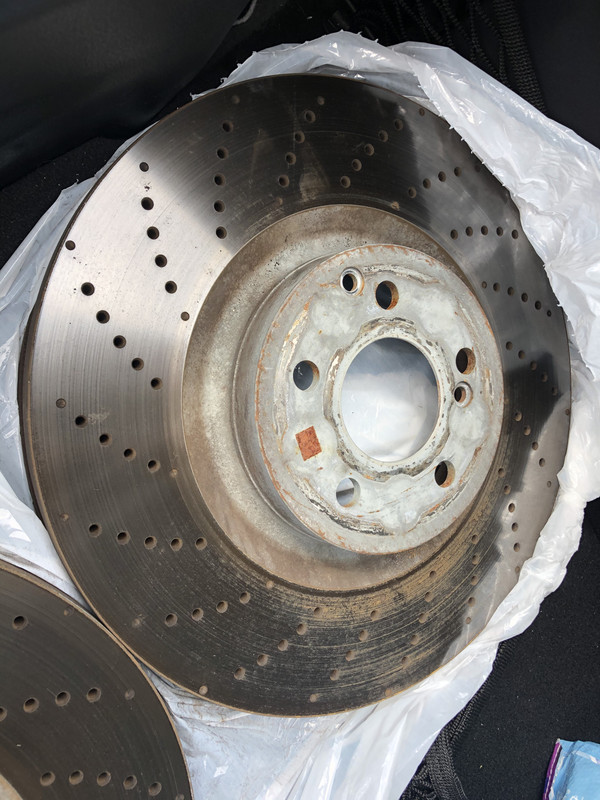

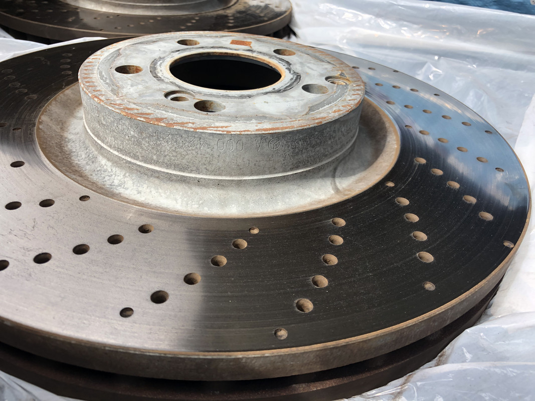

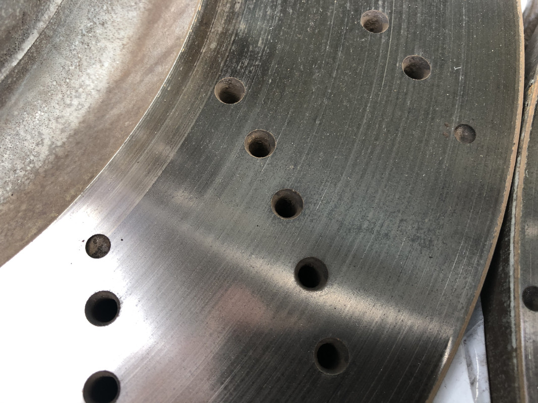

So, cars back with new front discs and I’m £440 lighter ( 50% of normal cost), and no vibration. I think I made the wrong decision saying to replace them but wanted my car back. Merc customer service useless, and I got passed to the AMG CS representative who basically said the decision was final as a wear and tear item, and not covered and under warranty, despite only covering 9k miles and 11 months old.
I requested the original discs and pads to be kept. After I found out basically they hadn’t even inspected the disc with the wheel off prior to replacing, which I’m pretty annoyed with.
Discs and pads look unworn but one disc has what looks like could be pad deposits (?//) on it and are brown when you wipe over it, same colour as the brake dust that drives me crazy. Does anyone know if the brake deposits should be known to mb before replacing? Some pics..
so, next steps? I’m pretty annoyed I’ve just spent £500 if they could have been cleaned up through hard breaking ( break in procedure prev mentioned). Annoyed at my self for authorising replacement. Not 100% sure if this is the issue still?
Anyone have the email of the head of AMG as may ping him an email to see if he would be annoyed if the front discs of his new AMG lasted 11 months subjected to normal road use?
or just leave it and get on with life.....

Im no mechanic or professional but those rotors look fine??? I never had any vibration or braking problems at all and my rear brakes look just like yours but a little more worn.
