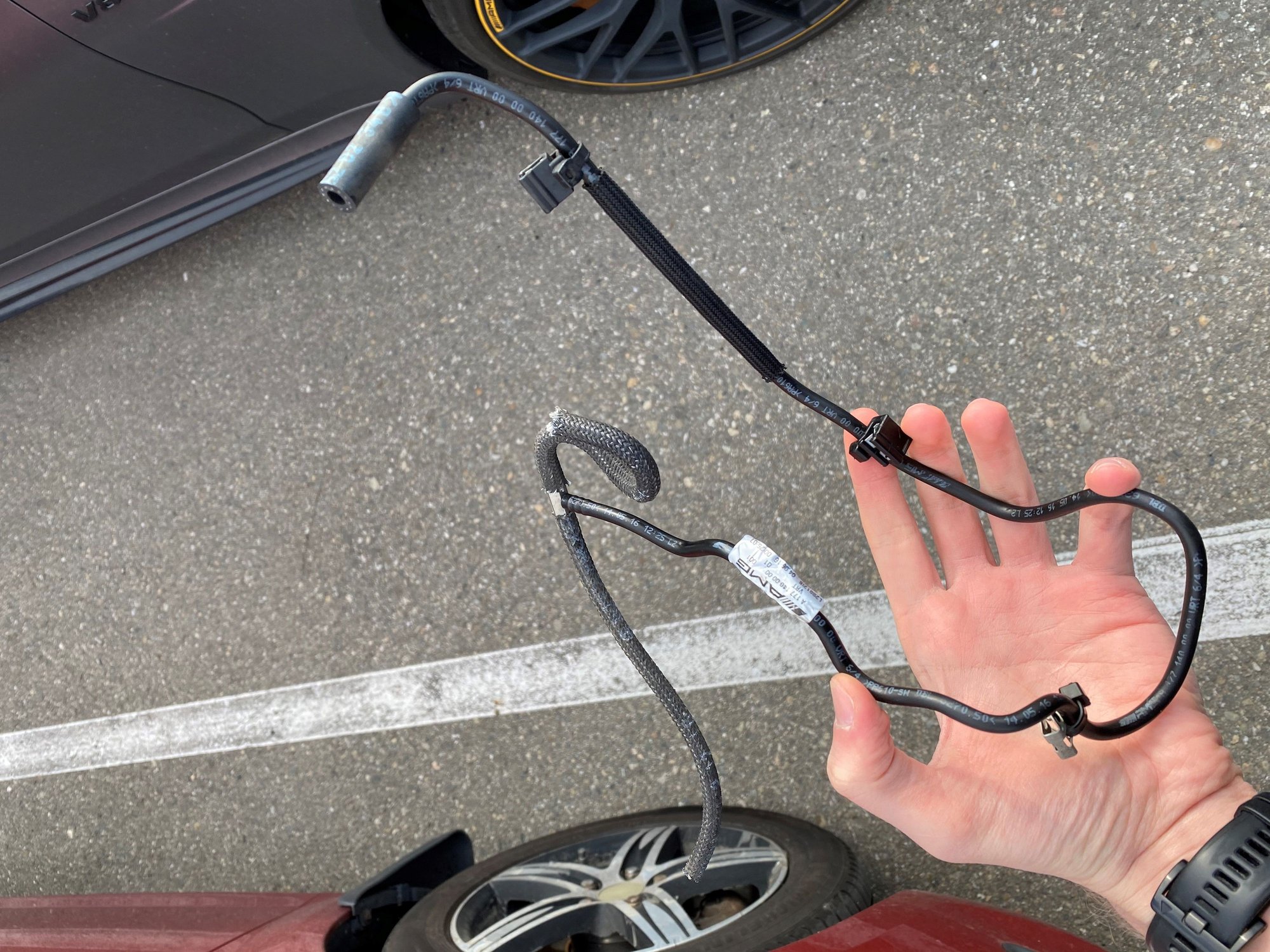

A year passed and about 2 months ago I've faced with the first ever problem with my car. I was driving home from my work as always and noticed that something is going to be wrong with my car. It felt like it has 150hp and do not accelerate, like turbos are not working and the exhaust sound was something like "MUTED". I looked at my dashboard fastly and noticed that the boost scale is not rising when I try to accelerate. So I stopped, shutted down the engine and waited for 5 minutes. After that I tried to drive again but nothing has changed, the problem was still there - no boost and muted exhaust. No codes, no errors, no cels. Just the car was not accelerating.
The next morning I arranged a meeting with our local MB Dealer to diagnose this issue but they only could offer me to come in a 7 days due to queue. So i decided before visiting a dealer to diagnose a car at tuning shop near my workplace (those guys have a programm which could diagnose errors from ECU). So we plugged their scanner in and the only one error which we found was and code for exhaust valve #3, it said that it was not working properly. Firstly I thought that this is about my H-Pipe valve which was plugged off and welded, but I used the car for a year and no problems with it shutted down. We decided to clean that code and try to drive a car to see if a boost ptoblem was still there. I've started my engine, went for a quick drive and BINGO - the car was boosting again with no problems like in past.
After a 4-5 days of driving the problem has suddenly occured again - no boost. I've decided to wait till my Dealer's visit. By the day of visitting the dealer I've read too much in this forum regarding boost problems and found the common problem with a vacuum Hose which could be pinched and that will put a car in a Limp Mode. So when I came to a dealer I told hhe manager my symptoms and adviced to check that Hose which I've read about in forum.

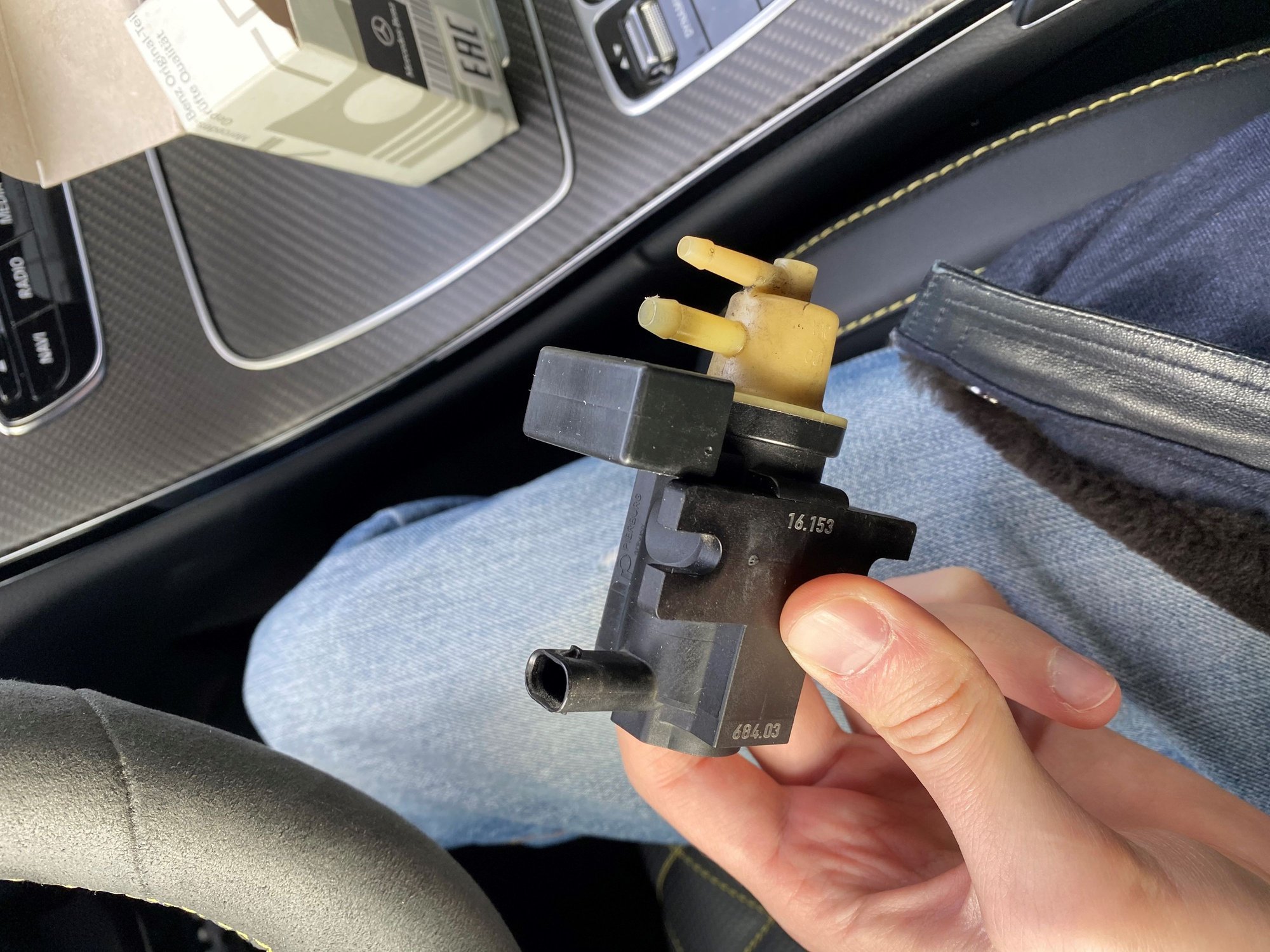

The manager forwarded my car to their diagnost who worked for an hour with my car and in the end told me that the only one error he could find is EXHAUST VALVE CODE but as he said it can't turn the boost off! Also he told me that we shuld change a vacuum hose to a new one and a valve / gate which is connected with that hose (do not know how to call it properly, but the pictures are attached).
2 more weeks passed when they called me again to come and fix that details. So they have done it and called me to come and check if the boost is OK. I took my car, made a shor drive and there was still no boost.... I got back to dealer's diagnost and we decided to investigate together. He plugged in their diagnose computer to my car and started to put a throttle down in various regimes COMFORT, SPORT, SPORT+ for a long time. (I do not have perfromance exhaust with a button so my exhaust valves seem to open when the car is in Sport+ as I understand). After that procedure he told me again that there is no codes and everything should be perfect and again "EXHAUST VALVE CODE HAS NOTHING WITH A BOOST OR LIMP MODE". We've decided to make one more drive together with his computer plugged in. And what do you think?! YES - the boost came again and everything went perfect.... So I left the dealer with an agreement that I'll drive and check if the problem comes back.
3 weeks of perfect conditions passed. I had no problems with my boost in all regimes (COMFORT, SPORT+). But yesterday that issue poped up again. No boost and the exhaust sound is something like a MUTED. From that moment I started to think that the exhaust valve code is the main reason my car has no boost. But the dealer's diagnost told me that it has nothing to do with Boost. So I am confused. I came again to local tuning shop to talk to them. They told me that if the actuator or valve itself doesnt work properly - it COULD tell the ECU to turn off a boost. Also they tried to open / close the valve with their computer and we think it did not open + the valve code poped up again.
From that time we decided to check what is wrong with my valve at the end of my exhaust - but these guys are to busy so I have to wait for 2-3 days. So I decided to make a thread at this forum to collect your opinions.
As I understand there should not be a problem with an H-Pipe valve which is plugged off because I drove a car for a long time (a year) and it did not affect my boost. So firstly I suppose it is about exhaust valves at the end of my exhaust.

The hose we've changed
The gate's box
The gate we've changed

No boost, I have the fualt code exhaust valve and checked the hose and change the Sinoloid for the vacuum and no change like he did, tomorrow I have an appointment with tuning shop for them to figure out problem but I believe after reading this and the guy at tuning shop also said exhaust code may be throwing off ecu to turbos but the car still feels somewhat loud and button for exhaust still works too and also feels like it does get louder I’m not sure tho but hopefully this is my problem! I also have stock exhaust so I’m not sure if bad margile or what is the issue but the car only has 5K miles and this is also my 1st amg 63 I’ve only enjoyed it in limp mode I guess it’s bought it little front end damage.
