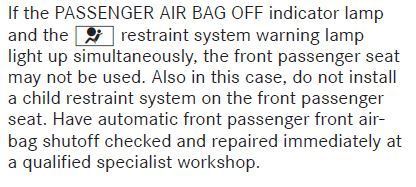

Some info that maybe helpful
http://www.mersec.net/21/status_of_t...nt_airbag.html
Self-test of automatic front passenger front airbag shutoff
When the ignition is switched on, a self-test is performed during which the two PASSENGER AIR BAG ON and OFF indicator lamps light up simultaneously.
The status of the front passenger front airbag is displayed after the self-test:
  • PASSENGER AIR BAG ON lights up for 60 seconds, subsequently both indicator lamps are off (PASSENGER AIR BAG ON and OFF): the front passenger front airbag is able to deploy in the event of an accident.
  • PASSENGER AIR BAG OFF lights up continuously: the front passenger front airbag is disabled.It will then not be deployed in the event of an accident.
If the PASSENGER AIR BAG ON indicator lamp is off, only the PASSENGER AIR BAG OFF indicator lamp shows the status of the front passenger front airbag. The PASSENGER AIR BAG OFF indicator lamp may be lit continuously or be off.
Reply 0

Your friend definitely needs to have this checked. The warning lamp to the right of the AIRBAG OFF light is the restraint system warning lamp. If that is lit, it indicates an issue with the restraining system. The airbag status and functions are all explained in the owner's manual with several consideration regarding child seats and stature of adults.
