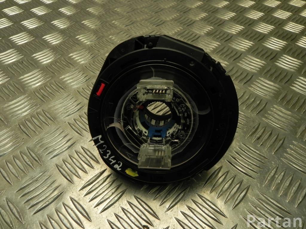

So here I was fiddling around and decided to try something with my old steering wheel and was in a rush last night and accidentally pulled out the clockspring. The taped wires unwound, so I tried to wind it back again but now when I turn on the car I get every "Malfunction" known to man. It's like everything has gone nuts.
Also, my AMG Ride Control suspension is stuck in "ultra stiff" mode
No idea what I did, the car drives but the suspension is mega stiff.
Going to limp it to the workshop in Sydney tomorrow but does anyone know what I have done? I didn't know that the clockspring could cause so many malfunctions appearing and keeping the suspension STIFF.
This is the part the I pulled off

Sure thing man, thanks for the helping hand.
Unplugged battery, took the steering wheel off and as the steering wheel came off, I had yet to unplug the brown plug from steering wheel that leads to the plug on the clockspring (clear plastic socket) tugged on the whole piece and the entire clockspring face (transparent clear face) popped off.
The pink flat wiring inside the clockspring unwound and came out. So I attempted to wind all the flat pink wire back like before but forgot how to center the clockspring.
Installed the steering wheel again and then all the dash lights came on as well as on screen "malfunction" pictures in the center of the gauges like "differential inoperative, front parking sensor, suspension, ABS, ESP and a few others.
Drove the car and the suspension was locked with the red light illuminated on the suspension button in the center console. Ride was stiff as sh*t like I had lowered the car or something. Very bouncy but drivable!
Have you experienced anything like that before? Be careful of that clockspring man. Apparently once you unwind the cables in it, you need a new unit. Flimsy little thing it is bro!

Yup it was my fault because I was fooling around and rushing. This never happens when changing our steering wheels so don't worry. I've taken the steering wheel on and off at least 8 times now (tried different steering wheels over the past six months), but this time my confidence got to me and I ended up wrecking the clockspring 😓
All because I didn't unplug the brown plug that connects to the clockspring from the steering wheel contact plate and I tugged on the whole steering wheel, and that's when it broke off.
Thanks for all the helpful and funny replies fellas, managed to get the car to the shop, and now I wait for the bill. Will post again on what exactly was replaced and how much it cost in case anyone else goes nuts 😅
It's incredible how just one part can cause so much issues.
