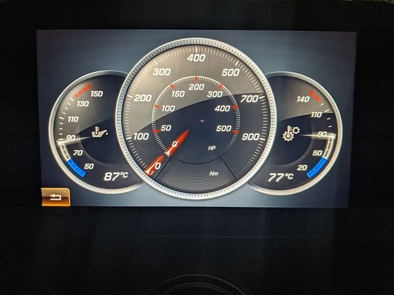

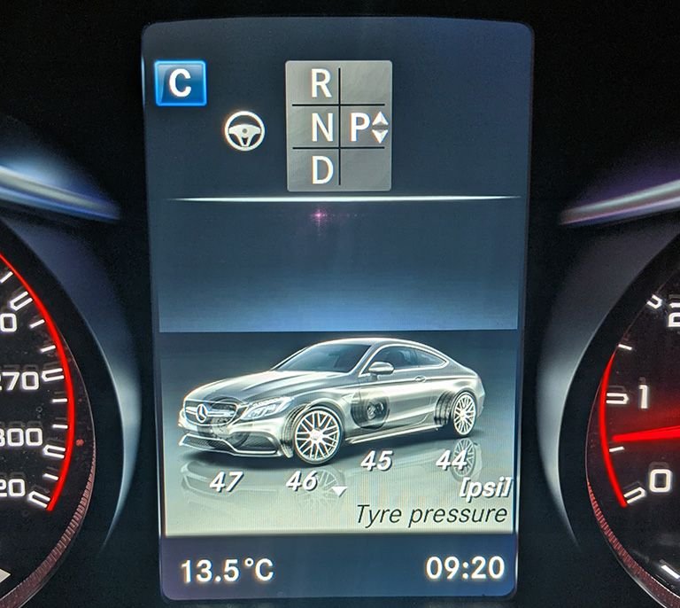

Old May 28, 2022 | 08:25 AM
Jimmy_c63s's Avatar
Joined: Sep 2016
Posts: 1,723
Likes: 613
From: Australia
Thumbs up RJautomotive Kpa to PSI coding done
Originally Posted by Eaton
Ask RJ too, he does remote coding as well: https://rjautomotive.net/
Never heard back from MB House so they're duds, but RJ Automotive did mine and he's the best coder I've worked with so far. Guy changed my tire pressure KPA to show PSI and also the KW to display HP in no time via remote coding and even checked some other things on the car without hassles or mucking about.
Honestly the real deal - thanks Eaton for the recommendation.
Other coders I've contacted/used like Sonic Racing in Singapore and that Vlad guy from this forum f*ck around too much.
Sonic Racing my God, please avoid those guys - biggest nightmare story with them promising the world and then attempting to code my facelift multibeam headlights but in the end completely disabled my front turn signals then telling me to go to the dealership to borrow a Vediamo laptop to continue was the worst - avoid them at all costs or get reamed in the a*se).
Glad I found RJ Auto in UK going to use his services from now on. Forget these other jokers RJ is your guy.
