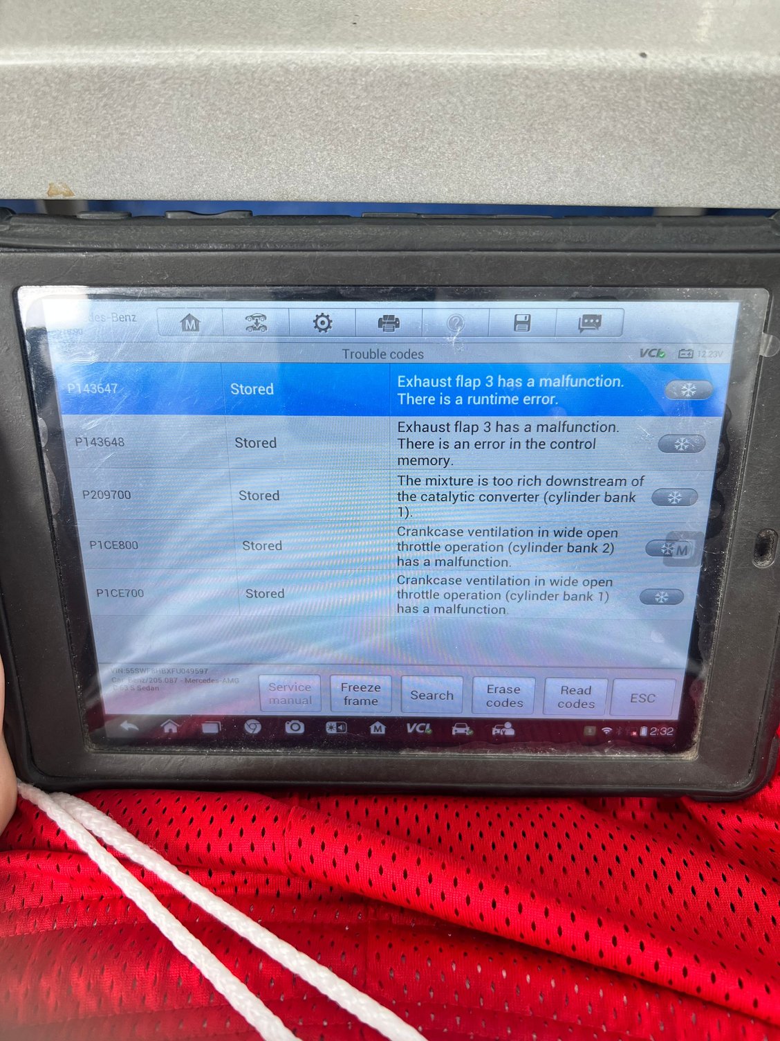

I plugged in scanner and received two codes,
1) Exhaust flap 2 has an electrical fault or an open circuit.
2) The exhaust flap has an electrical fault or an open circuit.
Now I’m dealing with severe power cut top end past 5k rpms where it’ll drop to 350hp on gauge.

I had a similar issue when I purchased my car used. I took it to the dealer, and the technician found that the wiring was damaged (from rubbing against the body). I got a similar code and experienced soft limp mode (with no check engine light).
My symptoms were that once the flaps opened during full throttle, they would stay open. It was obnoxiously loud in the garage.
