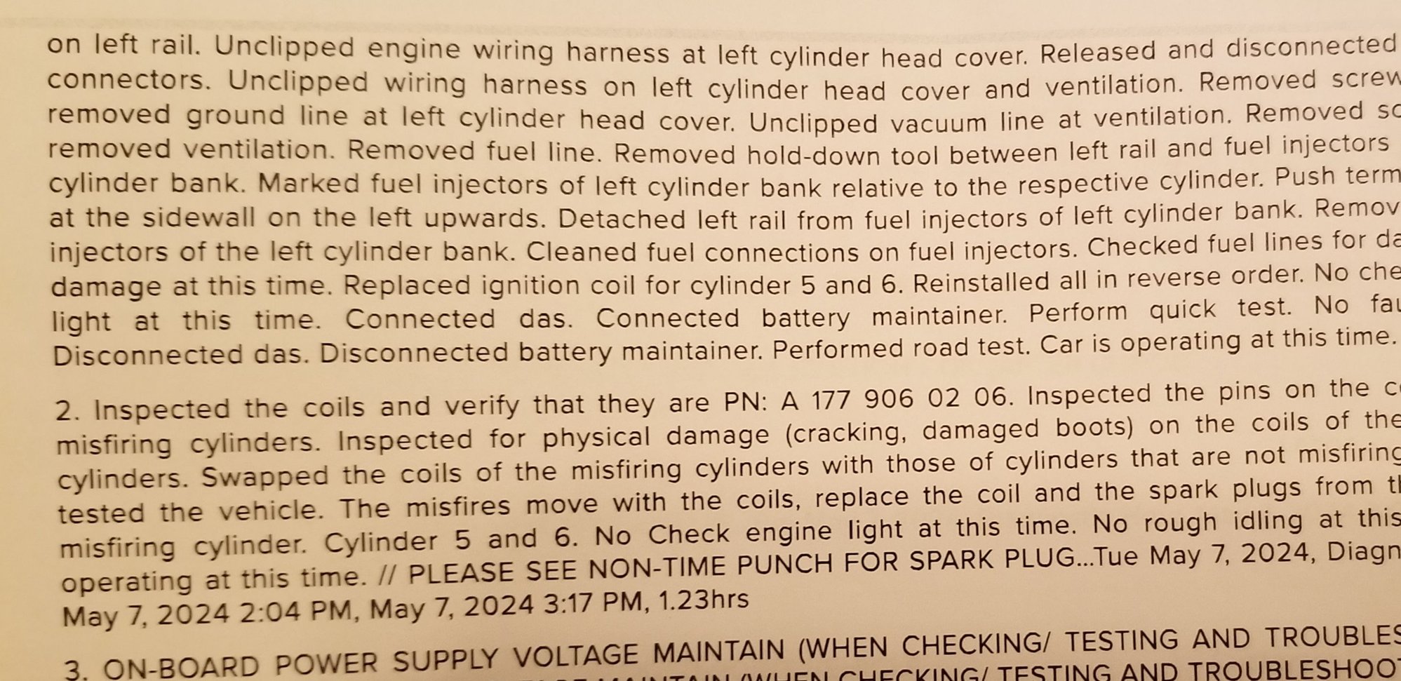

Don't know if this will help. But last month and after having my MB 5 year Service that included Spark Plug change suddenly on a perfectly running car the check engine light came on (30,000 miles). Initallly I believed these misfires happened right after I gassed up.
Drove to the MB dealership and initial diagnosis cylinders 5 and 6 misfired. They had my car for 2 weeks and did a overnight road test to insure the Check engine light did not come back on. see photos below what steps were perforned. They replaced ignition coils and spark plugs 5 & 6.
Note: MB will replace ignition coils regardless of warranty up till 100,000 miles.
Currenty my the car is running great.
. Maybe a MB Dealership AMG tech.will have a different approach. I have the MB extended warranty but SM
stated all will be cover by the 100,000 mile ignition coil coverage not my extended warranty.
