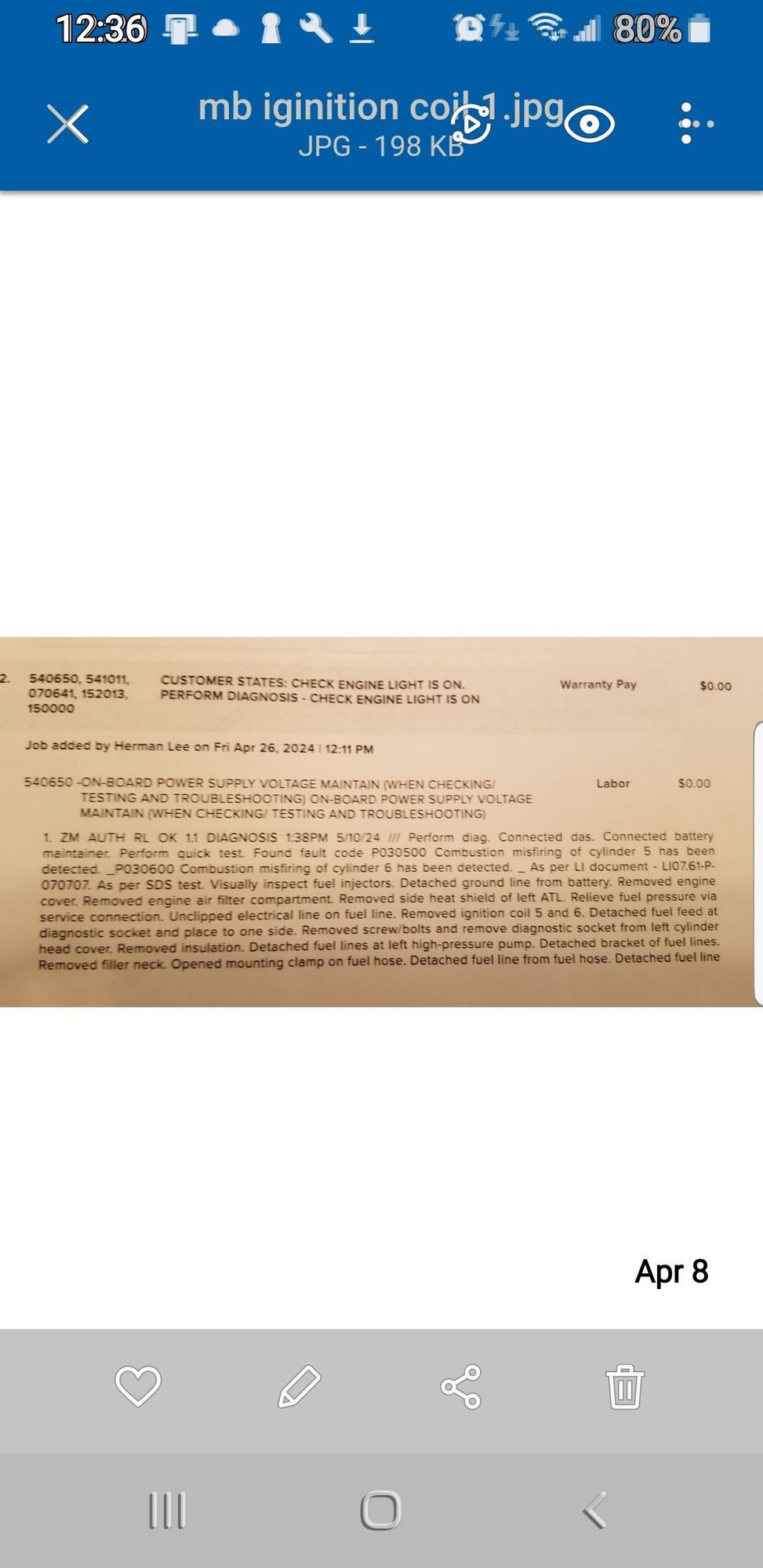

Last April my engine stalled and vibrate with engine light came on. Restarted after few minutes with no engine light. Next day to MB Dealership where initally found 5 and 6 misfired. Had my car, 2019C63s coupe for 2 weeks and work invoice below it was coils.Originally Posted by Barbalatte
Last week was driving normally in "C" mode all day.All of a sudden the car starts to shake and vibrate. When I got home i Did a quick scan and found a misfire from cylinders 7 and 8.
Left the car in the garage for 1 week. Turned it on the day before I was supposed to bring to the mechanic and car ran fine. The day of, was still ok. Mechanic scanned and confirmed a misfire on 7-8. He said let's clear the code to see if it happens again we order parts to fix. A few minutes later started to misfire again.
car is. 2019 C63S AMG. 47,000km.
Anyone had this happen? If so, was it the plugs or the coil?
. SA said it covered under MB Extended warranty for ignition coils 15 years or 150,000 miles. Believe they also replaced the 2 spark plugs for 5 and 6.
* side note: a few weeks earlier had 5th year Service which includes Spark plug change completed at Dealership. Wonder if plugs were I correctly installed?
But here is the invoice what step by step was completed to ensure it was the coils.
https://cimg6.ibsrv.net/gimg/www.mbw...e900ff5d93.jpg
https://cimg0.ibsrv.net/gimg/www.mbw...f624f8b9a5.jpg
Oh the coils not the injectors. I see. Originally Posted by jj18
Last April my engine stalled and vibrate with engine light came on. Restarted after few minutes with no engine light. Next day to MB Dealership where initally found 5 and 6 misfired. Had my car, 2019C63s coupe for 2 weeks and work invoice below it was coils.. SA said it covered under MB Extended warranty for ignition coils 15 years or 150,000 miles. Believe they also replaced the 2 spark plugs for 5 and 6.
