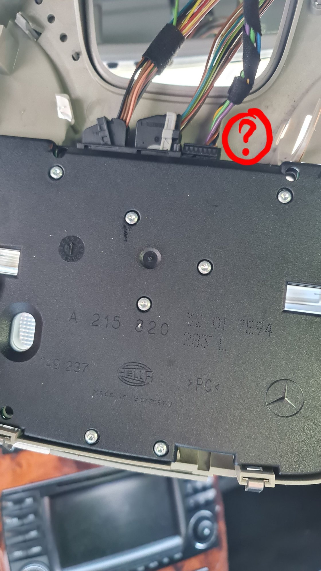

After this winter i have a problem with power drain(over 2A)
I already know that 0.6A comes from the command unit( took out the fuse) and i have located another drain, of over 1.2A that stops after unplugging one of the plugs in the dome lamp( i have marked it in the picture).
Can you please help me, what can cause the drain?

Yes, but after the battery was empty the command was turning on but with no sound, after some time it was normal.
The lights are working normally.
Now after unplugging that plug, i can't use the remote, the dome lamp doesn't work and the PDC doesn't work. After plugging it, everything works fine, but it drains the battery.

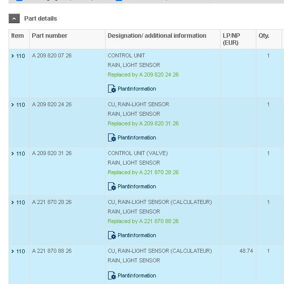

You've missunderstood me, the plug is out there and after unplugging it, the drain stops. My question is, what electronic devices are in the dome lamp, because one of them causes the drain. After unplugging i can't close the car from the remote, and rain and light sensor does not work.
this
to get you the correct part number you need to give me your vin
price is euro and dealer price not public
Thanks a lot! I will check it.
