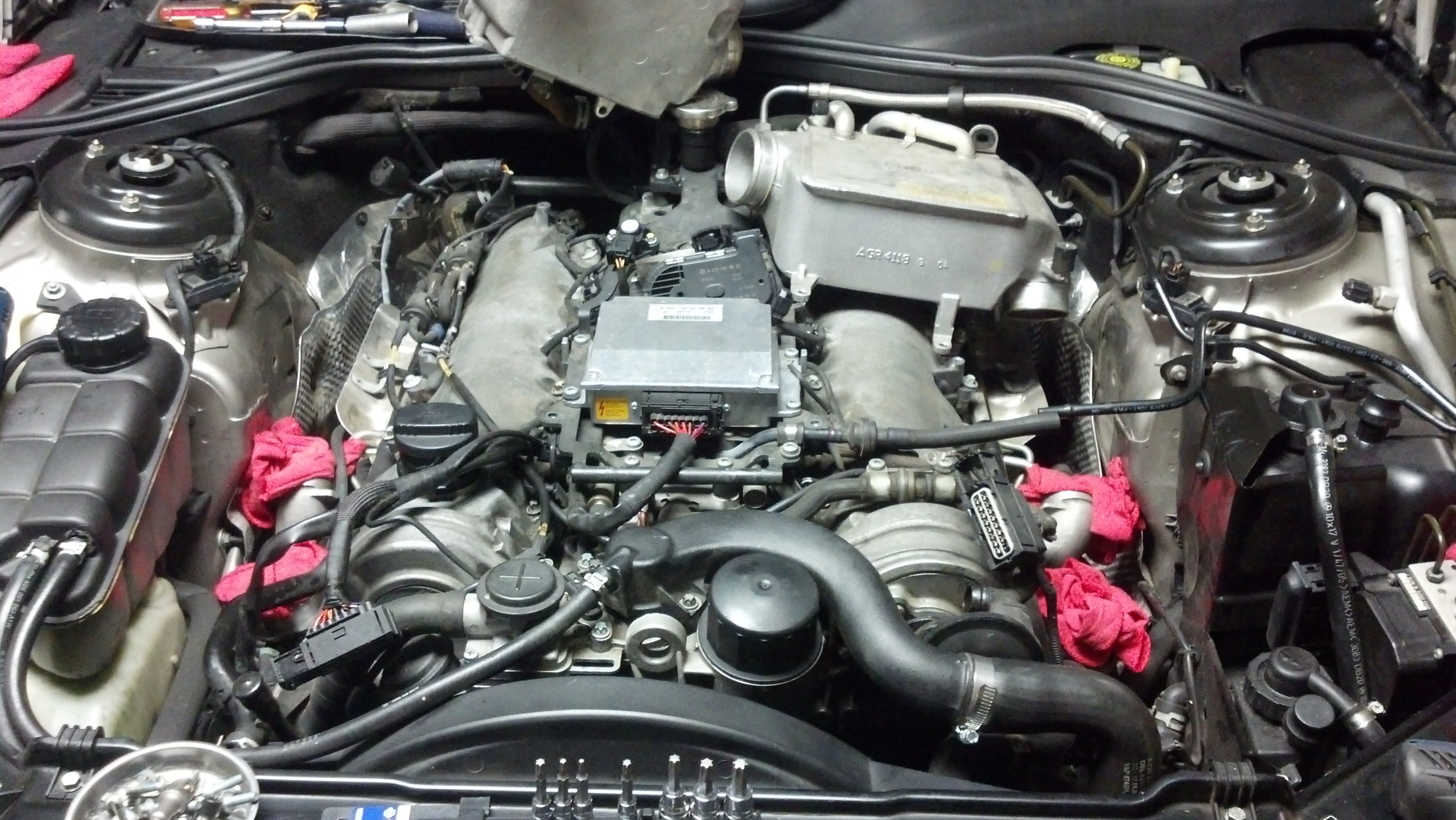

I removed the coil packs and plugs this evening. The biggest PITA was when the rubber insulators (or whatever the heck they're called) get stuck on the plugs when the coils are removed. I think I spent more time removing them from the rear most plugs on both sides than I did on the teardown.
Install spark plugs when coils are changed??-img_20140523_212841_669_zpscfb4a1bf.jpg

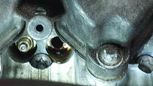

After finally getting the insulators out of the way, all the plugs were removed. The plugs appear to be the stock NGK's. Some were cracked along the porcelain and the passenger rear plug has some type of buildup on the electrode.

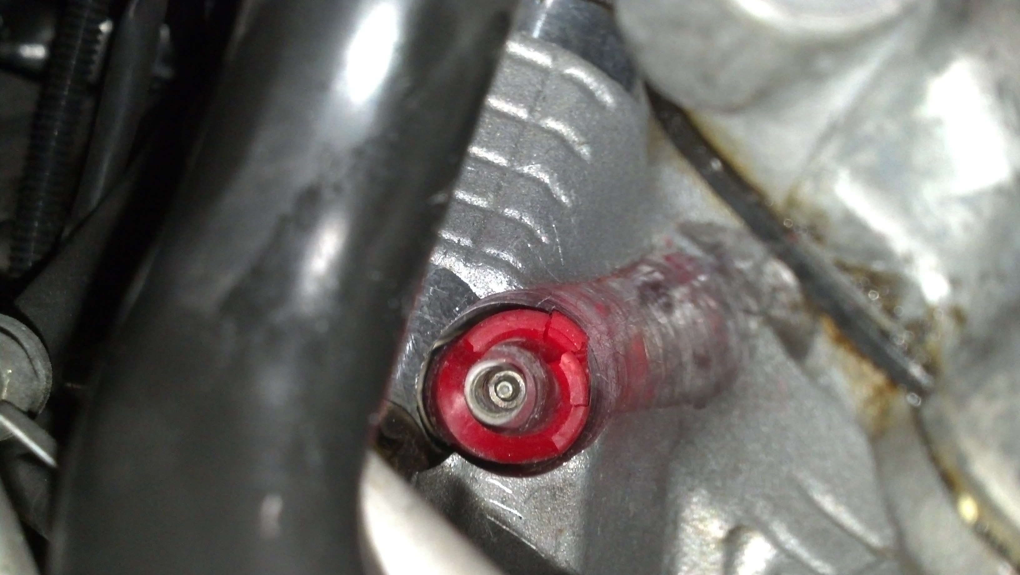

Plugs and coils will be replaced tomorrow. I'll wait until winter to repair the suspected valve cover leaks.
Here's a photo of some engine oil pooling at the passenger front plug.

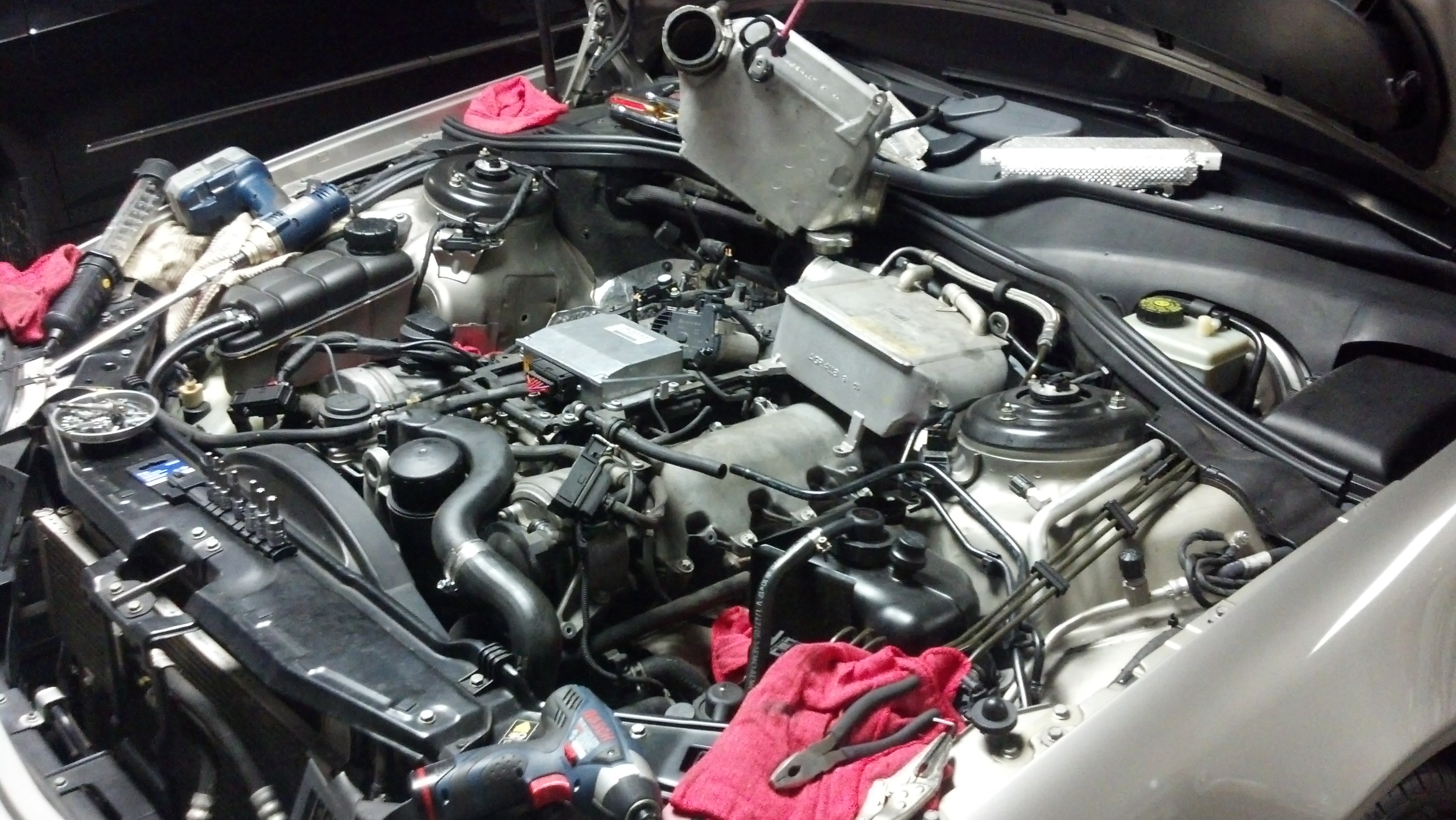

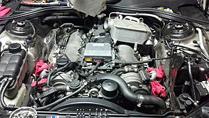

Here's some photos of the stripped engine.

That plug looks like it is covered in aluminum. You may be suffering from extended detonation that could be caused a lean condition.

I did a little research, and I belive it's calcium buildup from the car burning a little oil. The ST and LT trims look good, so I think the A/F is probably fine. I really need to install my wideband and other sensors.

Look for oil coating the Red insulators..
The front passenger side of the engine near the oil filler / cap area is where the oil will drip right into the coil holes if you accidentally miss and spill the oil when filling it.. all it takes is a tiny bit and it'll flow down right into the spark plug holes.. almost a perfect path for the oil to go.
The oil will make its way coating the red insulators and eventually cause it to arc..
