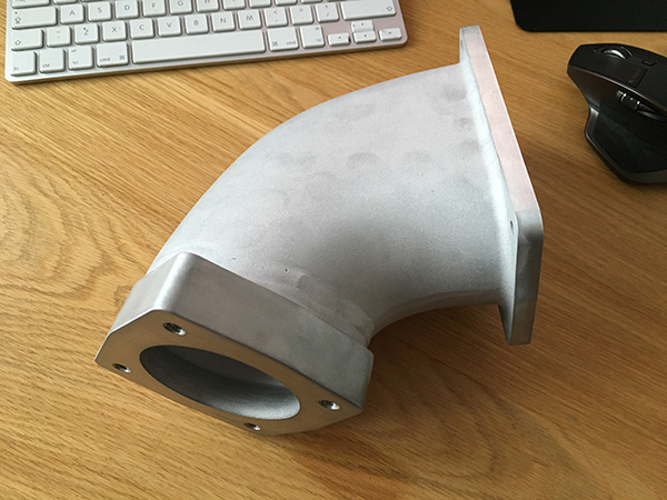

ITG Air Filter, S/C Elbow (flipped 180deg from Weistec design)

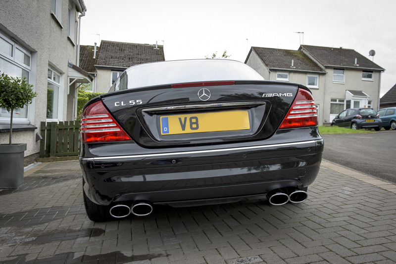

I have a few photos but I'm going to give her a wash and wax tomorrow or Saturday and get the SLR out but here are some poor iPhone pics...
Before:

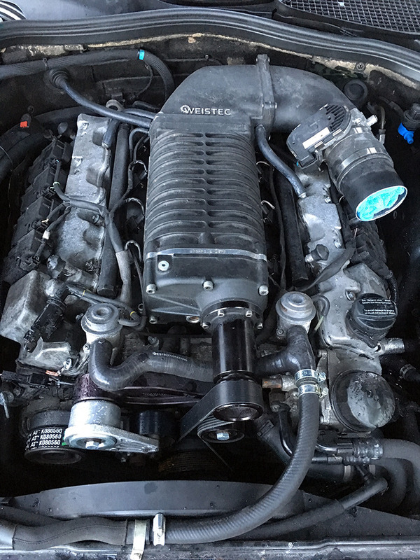

Engine Bay (Air filter is in the house & it is normally fully covered up):

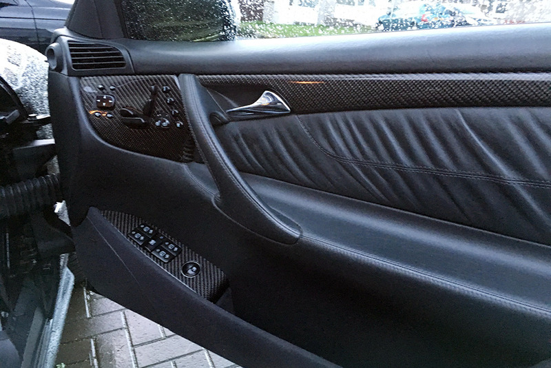

Interior:

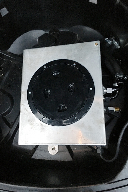

Ice Tank:

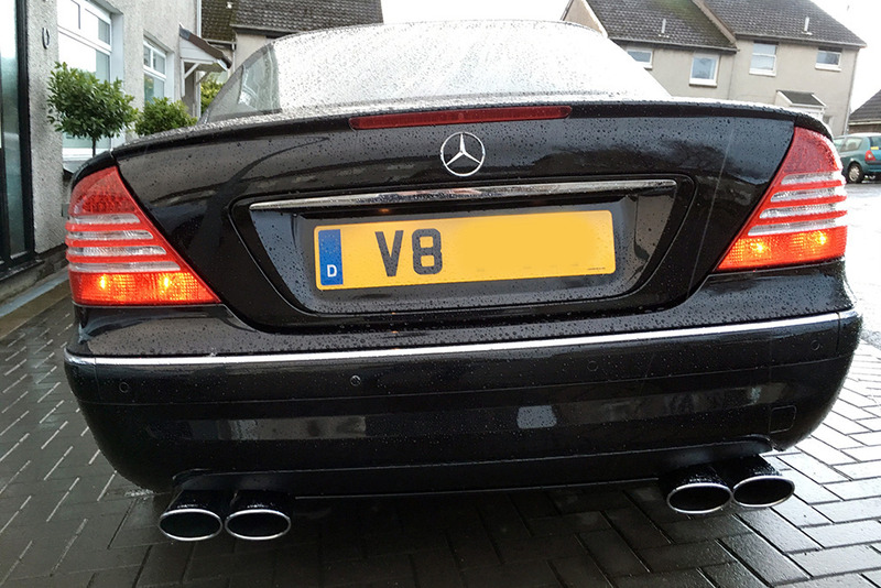

Rear End (fully debadged):
Eisenmann Exhaust:

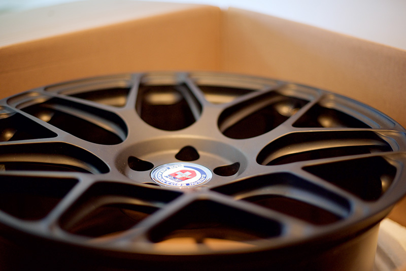

Her Christmas present arrived in a UPS truck yesterday though... Nice set of HREs, considering they are 20" they are stupidly light.
Note, suspension is at the highest setting to help clean the wheel arches - just never bothered dropping it.

New shoes...

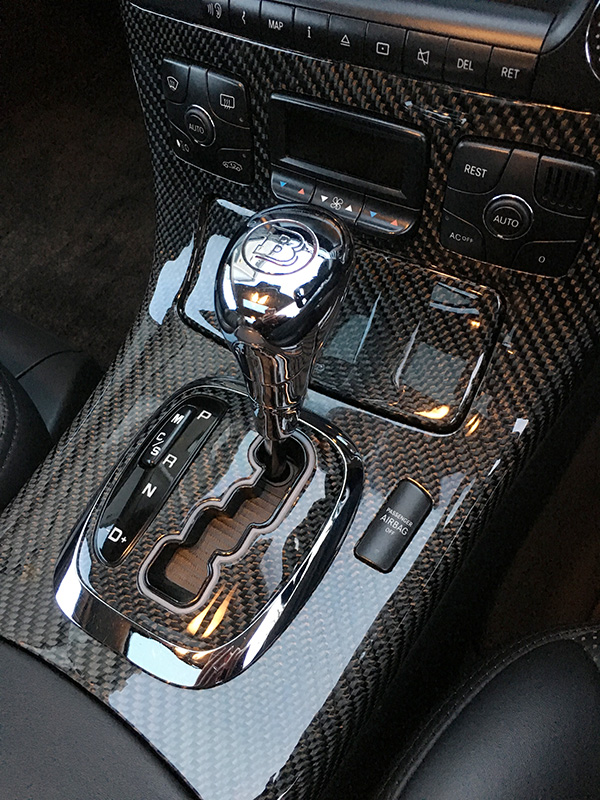

Oh and a Brabus shifter knob, still need to fit the door pins shame the door cards need to come off for them.

The interior trim isn't a kit, the factory trim was removed and sent off to oCarbon who removed the wood veneer and layered CF onto the original pieces. The finish is incredible, its a mile deep and they also layer the CF at different angles for different sides of the car as you'd find in a car with CF trim installed from the factory.
If you can live without the trim for a while then it is the way to go, otherwise hydro-graphics would be my other choice which is quicker although not quite the real deal.

Remove and replace Weistec elbow and TB plate with supplied parts
Remove and replace TB with 82mm
Fabricate intake tube, heat shield and CAI system for new ITG filter

So, on comes these two custom machined parts. Essentially a flipped version of Weistecs' original elbow and TB adapter although the internals are completely smoothed out unlike the cast finish inside the Weistec parts.
New Elbow

The new 82mm AMG throttle body simply bolts onto the adapter.
From there it gets a little custom...
The CL has a washer bottle and expansion tank in place of the SBC pump. The expansion tank isn't a problem, Weistec supply their own mini tank which is a easy install. The washer bottle isn't quite so straight forward, however, the shop have a heated W203 bottle with remote filler cap which will be installed in the wheel well so that takes care of those two items and we will end up with a nice big hole.
Within that hole, the filter gets a bit of an upgrade to a nice big ITG filter, this will allow the engine to breathe properly.
So essentially the only two parts left to fabricate is a pipe to run from the filter to the TB and a heat shield to seal off the filter from the engine bay.

- Air pump for warming CATs relocated and installed at new location in engine bay - looks very OEM
- Full pipework of ice tank removed, pipe bender arriving Mon to do it properly. Pipe was just resting on suspension work previously so not good...
- Weistec S/C elbow and TB adapter removed and new custom parts fitted.
- ITG air filter located in engine with a custom bracket to secure within compartment

Engine bay
Air Pump Relocation & very tidy pipe work
Air Filter & Remote windscreen filler cap
Awaiting air intake pipe & heat shield
Inlet and Outlet hoses for S/C routed up wheel well, behind firewall and directly into S/C (sorry, can't get a pic of the hoses behind the firewall)
