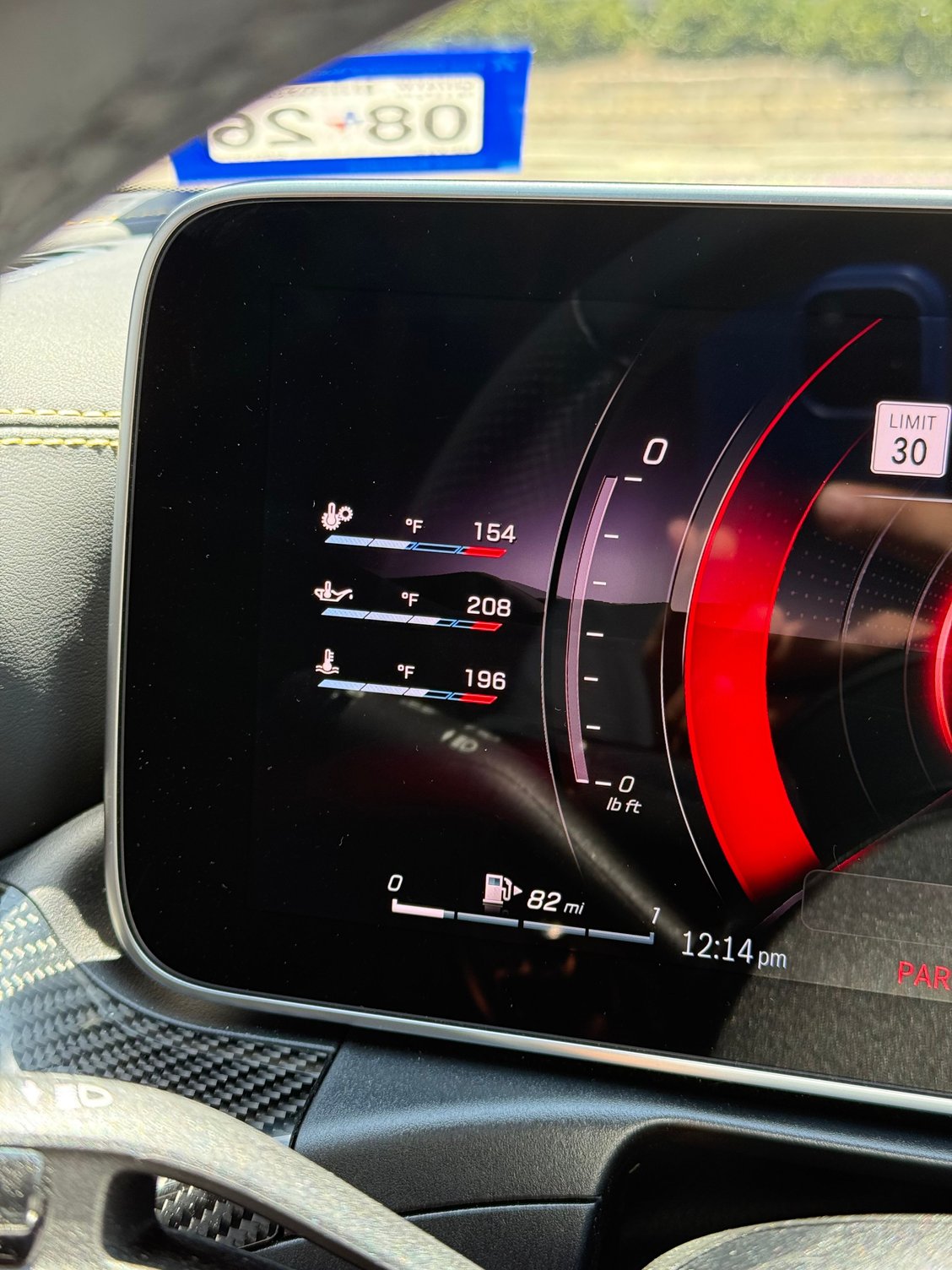

So I haven’t had an issue with overheating or performance, but do you feel these “normal” operating temperatures are kinda high? See the photo below. I wasn’t even doing spirited driving and the coolant was just under 200 and the oil was over 200.

They're fine.

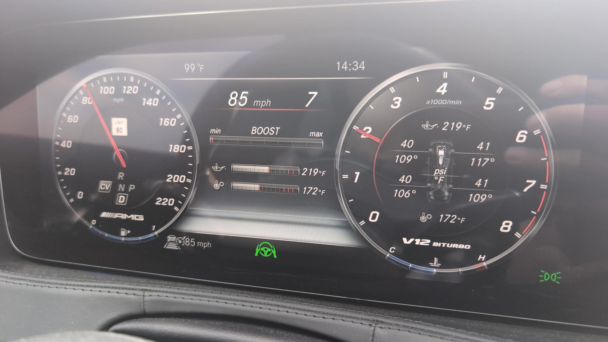

I know the one in mine is a slightly larger engine vs what's in yours, but these are my cruising temps at ~99° F ambient temperature.

i regularly see those temps in various cars, MB or not. You're ok

Oil is maybe a little low...
This looks like my CLE53.
Transmission somewhere between 150 and 225F.
There may be an int er cooler between the transmission fluid and the coolant.
This would stabilize the temperature.
Engine oil between 200 and 250F.
Unburned gasoline gets past the rings on a cold start and ends up in the oil.
Water from combustion allways drips past the rings and into the oil.
To evaporate these, you want the oil to run about 212F.
There may be a slight vacuum in the oil pan wich would help.
Coolant between 185 and 230F.
Most current cars have a 195F thermostat that regulates coolant flow.
In addition there are fan(s) that may be activated to blow air through the radiator
and air conditioner condenser.
Old Jul 28, 2025 | 10:22 AM
jerrya's Avatar
Joined: Sep 2013
Posts: 64
Likes: 14
From: Massachusetts
CLE53 Cab
There may be an inter cooler between the transmission fluid and the coolant.
(A 50/50 mix of Ethylene Glycol and water under 15psi of pressure has a boiling
point of 230F.)
