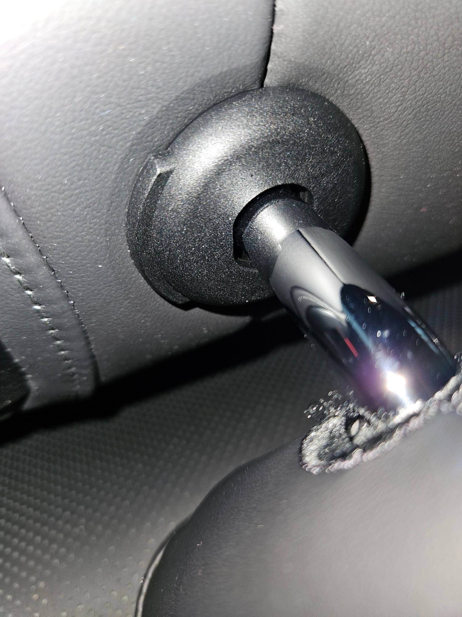

On the coupe there is a semi-circle button at the base of the headrest where the chrome shaft enters the seat. One on each of the two chrome shafts. Press to raise lower and if you pull far enough they come out at least on the coupe.

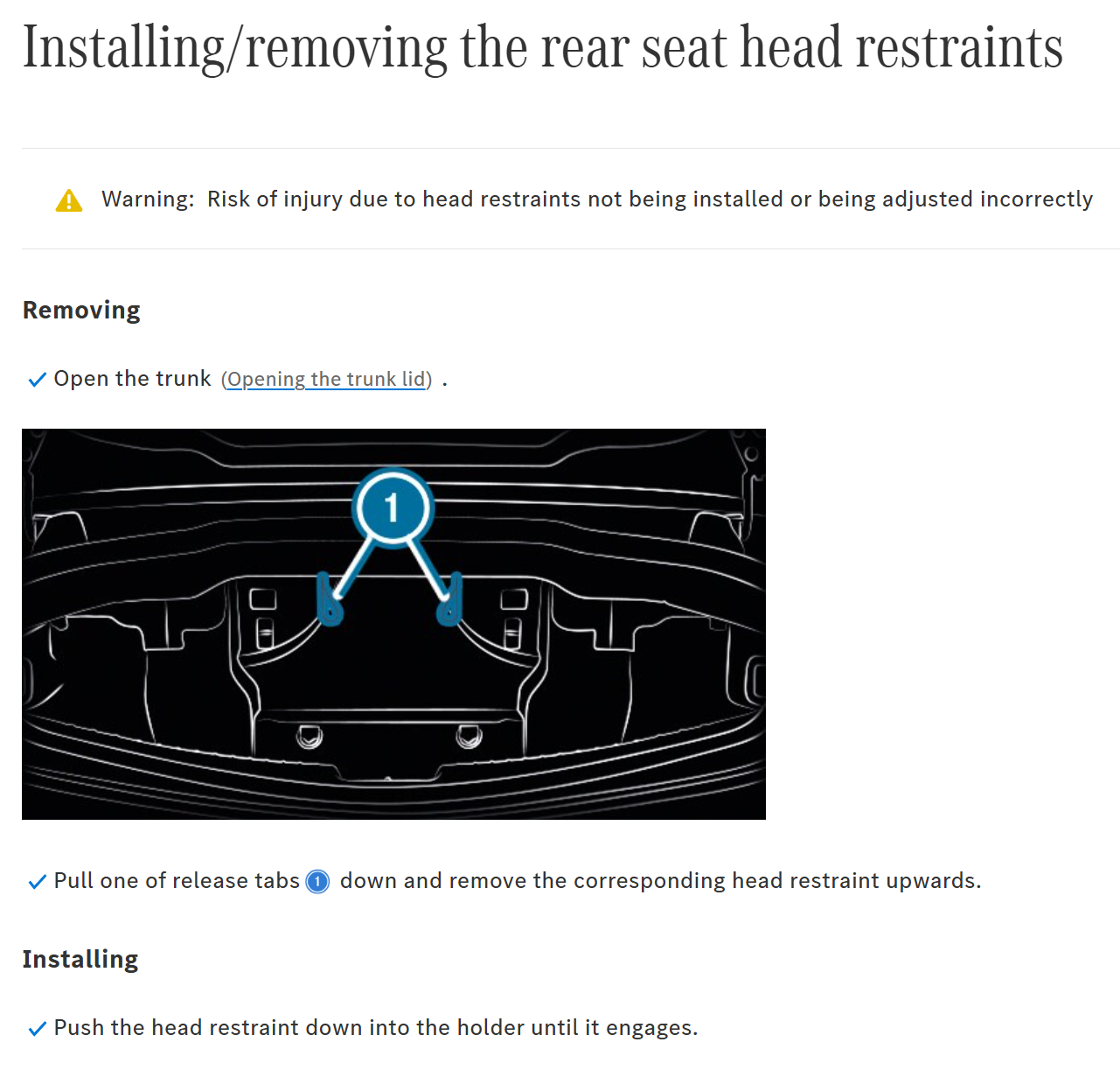

Yes, there is way. I have them out of my cabrio. The real visibility is much improved. The instructions are in the owner's manual. They are in there very tightly so you may need two people, one to pull on the headrests and the other to keep pressing the tab which is accessed through the trunk.

This is what I found in the manual. Any chance you could take a picture of what the rear seats look like without the headrests and post it here?

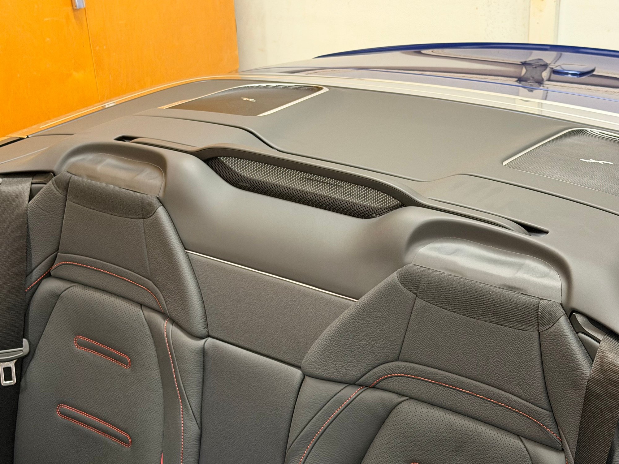

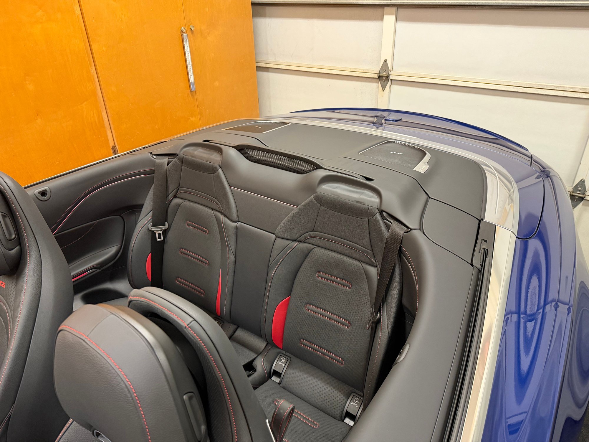

Here are some before and after pictures. If I'm going to keep them off, I need to find something to cover the holes that were under the headrests

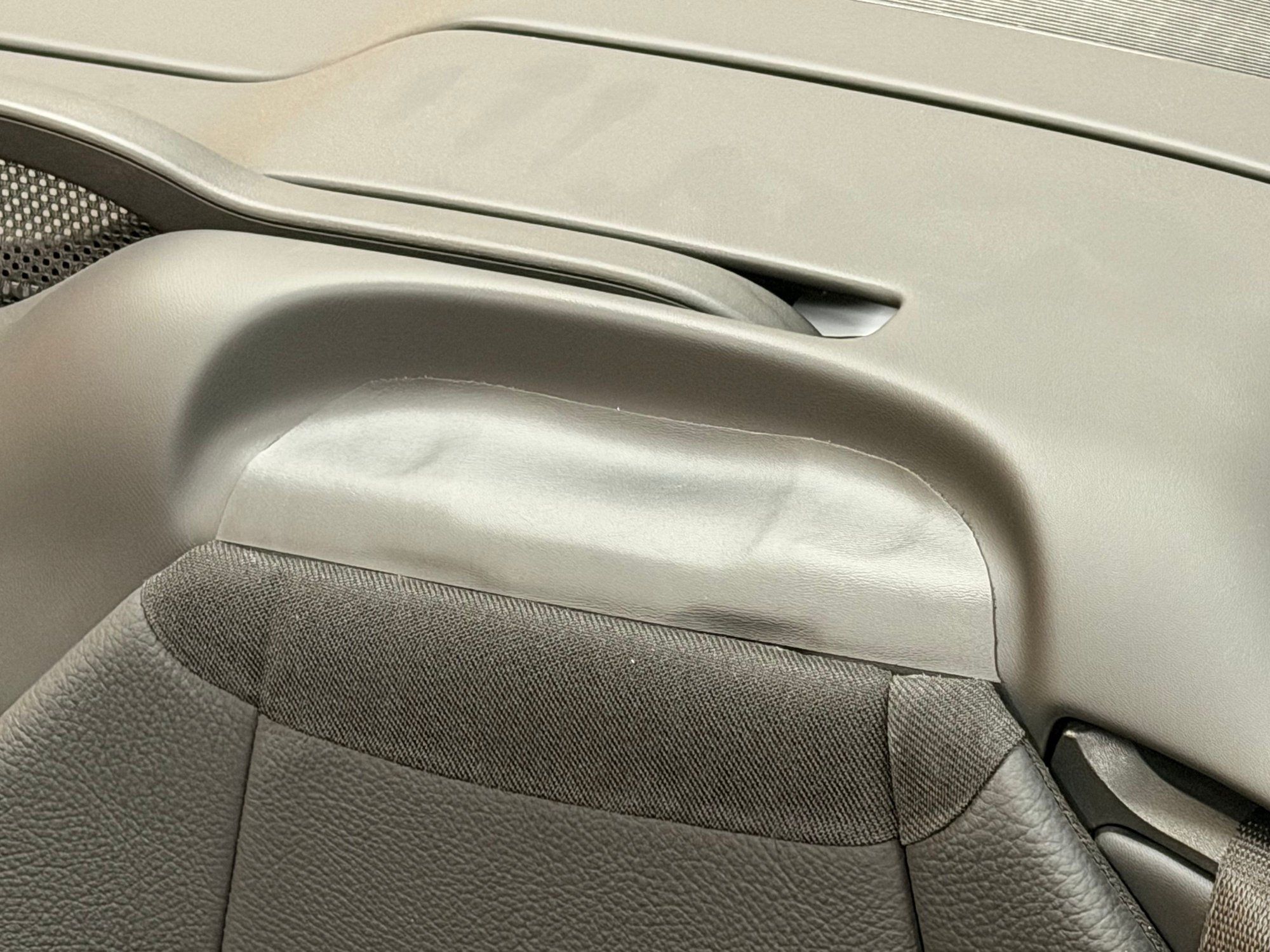

I looked at a ton of options, I could not find anything that's perfect so I decided to buy some leather repair tape on Amazon and cut it to cover the holes. Does it look perfect, no, does it cover holes, yes. I will continue to look for a better options but for now, it does the job and I like the car without the rear headrests as the view out the rear window is a million percent better and I haven't, and don't plan on ever having anyone in the rear seat. Maybe I will at some point, but they just won't have a headrest.... Something more stiff/rigid would be better as you won't see the indentations, but like I said, I haven't found anything that like that as of the moment.

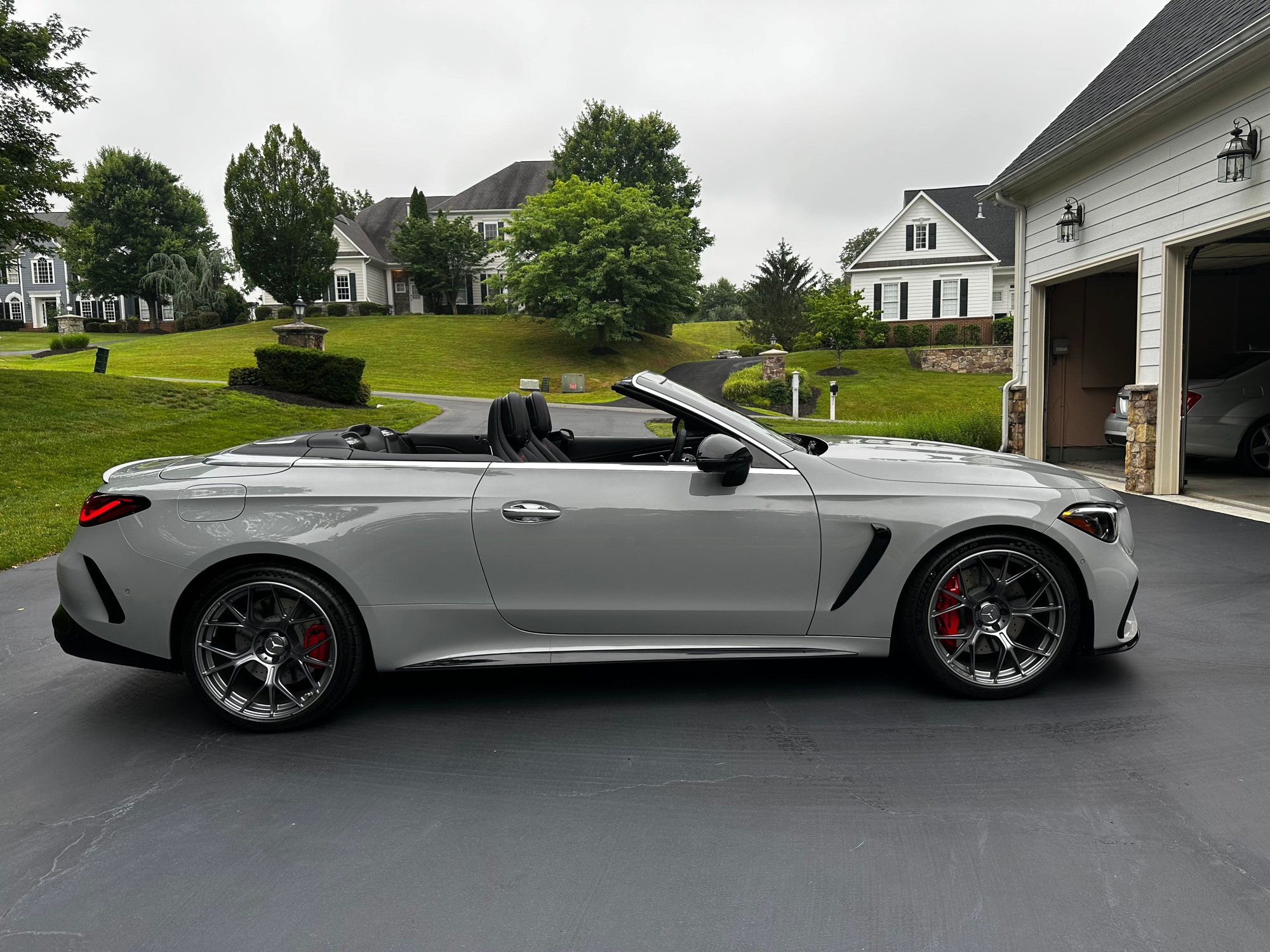

Excellent, I also removed my 2025 AMG CLE 53 cabrio rear headrests. Covered it with black scotch tape while looking for a more elegant solution.
