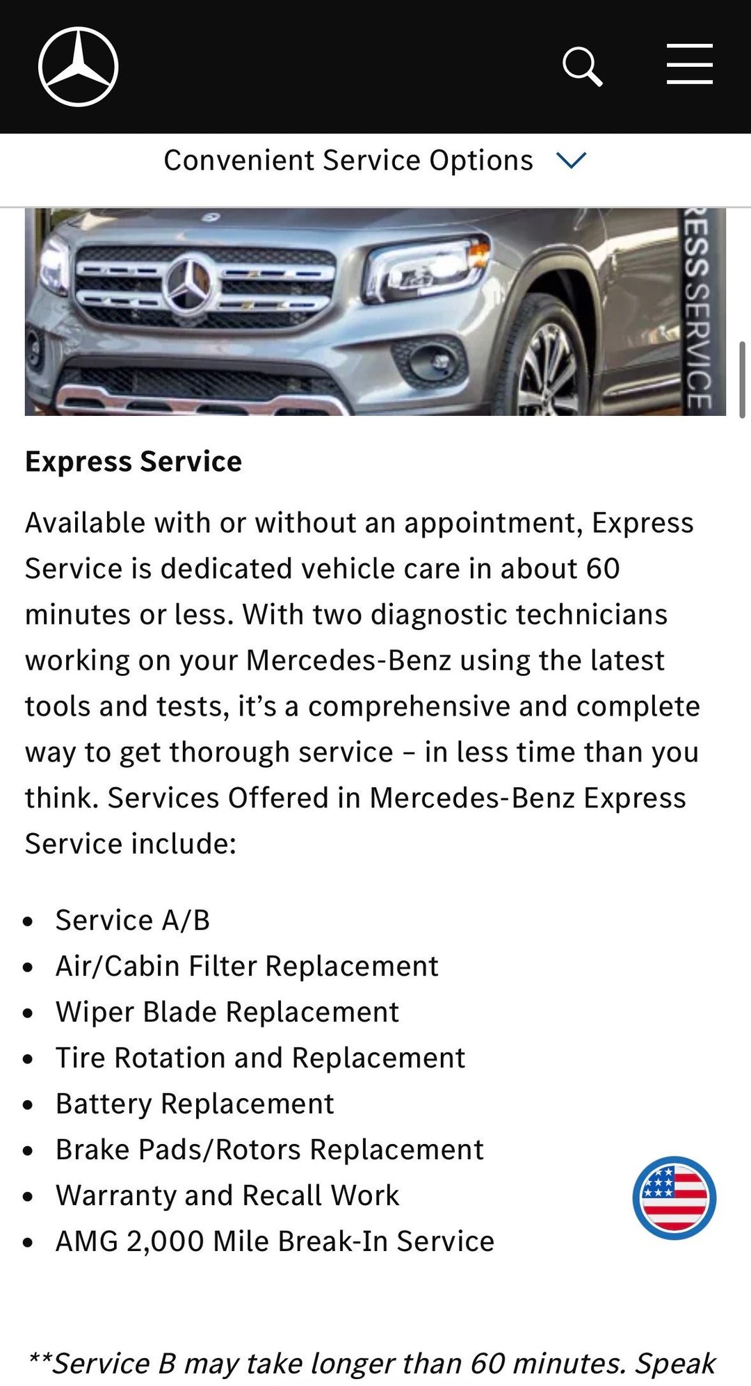

The manual doesn't mention anything about a break in service, but the MBUSA website does show a 2k mile break in service, should I be doing this on my CLE 53?

Where does the website show a 2k mile service for the CLE 53? The 63 models used to have a 2k mile service to replace the fluid in the rear locking differential. The 53 just has a regular open differential and AMG did away with the 2k miles service for the locking differential in 2019. They revised friction materials or something and a break in service is no longer necessary for the locking differential. Nothing else ever needed a break in service. BMW M models historically were using break-in engine oil that needed to be replaced after the break in. Don't know if they still do, but AMG doesn't use break in oil in any of their engines.

Thank you so much for speedy response. I saw it here on the MBUSA website but not to a specific vehicle.
Here is the link and it’s under Express Service: https://www.mbusa.com/en/owners/service-maintenance

Ah, that's outdated language, but there might still be some very low mileage specimen out there that haven't had their older diffs serviced after break-in. So this part only applies to select models.

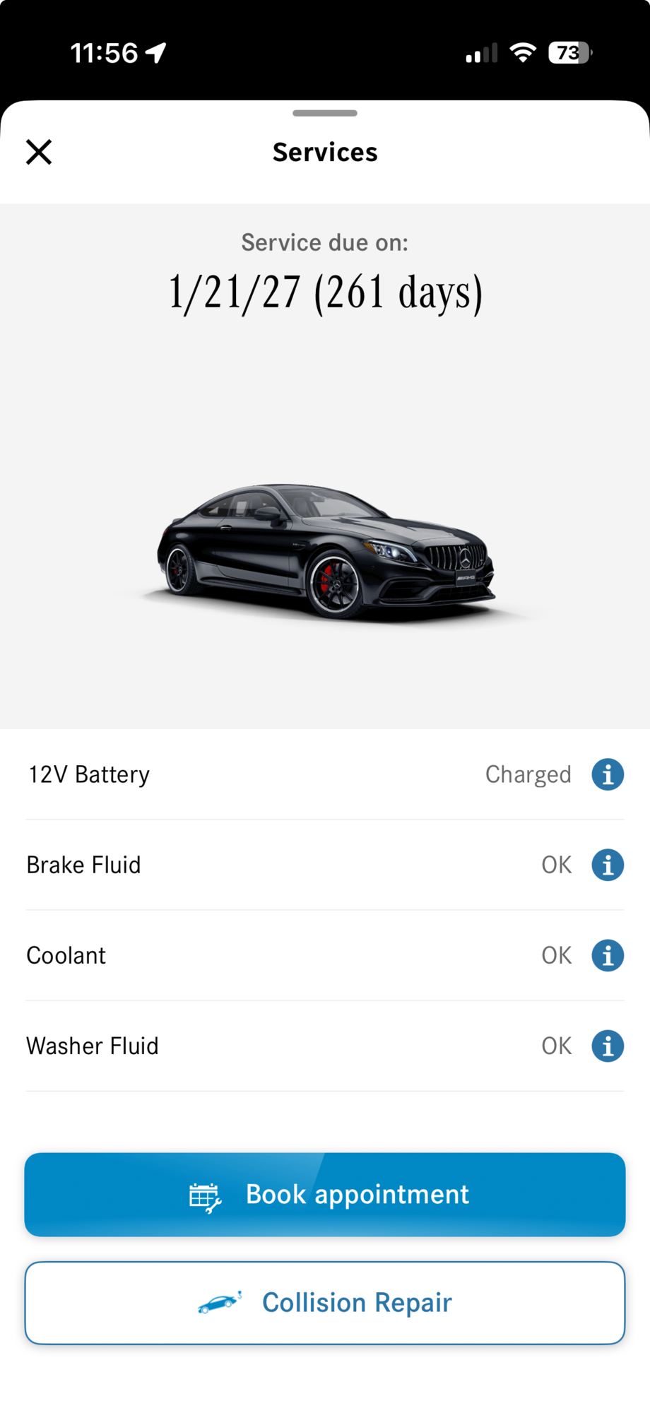

Service is due every 12 months or 10k miles, whichever comes first. Low mileage cars need to be serviced every 12 months. The car will tell you in the instrument cluster when it's due for service. As has been said many times, oil degrades over time, whether you drive the car or not. It's almost more important to get the oil changed on low milage cars, because short distance driving and not running the engine frequently can accumulate moisture and fuel in the oil and dry out the seals. Moisture and fuel in the oil normally evaporates when you drive long enough and get the oil properly hot, but if you only drove 600 miles in 5 months I'm assuming that's a lot of short distance driving where the engine barely reaches proper operating temperature. That's the worst kind of driving you can do for a modern combustion engine, so the last thing you wanna do is delay the 12 months service. Another item is brake fluid. Brake fluid is hygroscopic, which means it absorbs moisture over time, even in a closed system as no system is 100% airtight, so a brake fluid flush is part of every B service. That ends up being every 2 years with low milage cars, which is the general recommendation for flushing the brake fluid. Or the spark plugs are due after 5 years or 50k miles, whichever comes first. Again, even if you don't drive the car, the plastic on the spark plugs degrades and you don't want a piece of insulator crack and fall into the combustion chamber due to the age of the spark plug. If that happens, you are looking at getting a new engine. FWIW, I drive my C63 only about 4000 miles per year, so I service it every 12 months as is recommended.

BTW, the app also tells you way in advance when it's due for service based on your actual driving. Initially it may bounce back and forward between mileage and time, but eventually it will settle on one based on your average daily mileage. Mine has already figured out that I'm due for service next January and gives me the exact date.

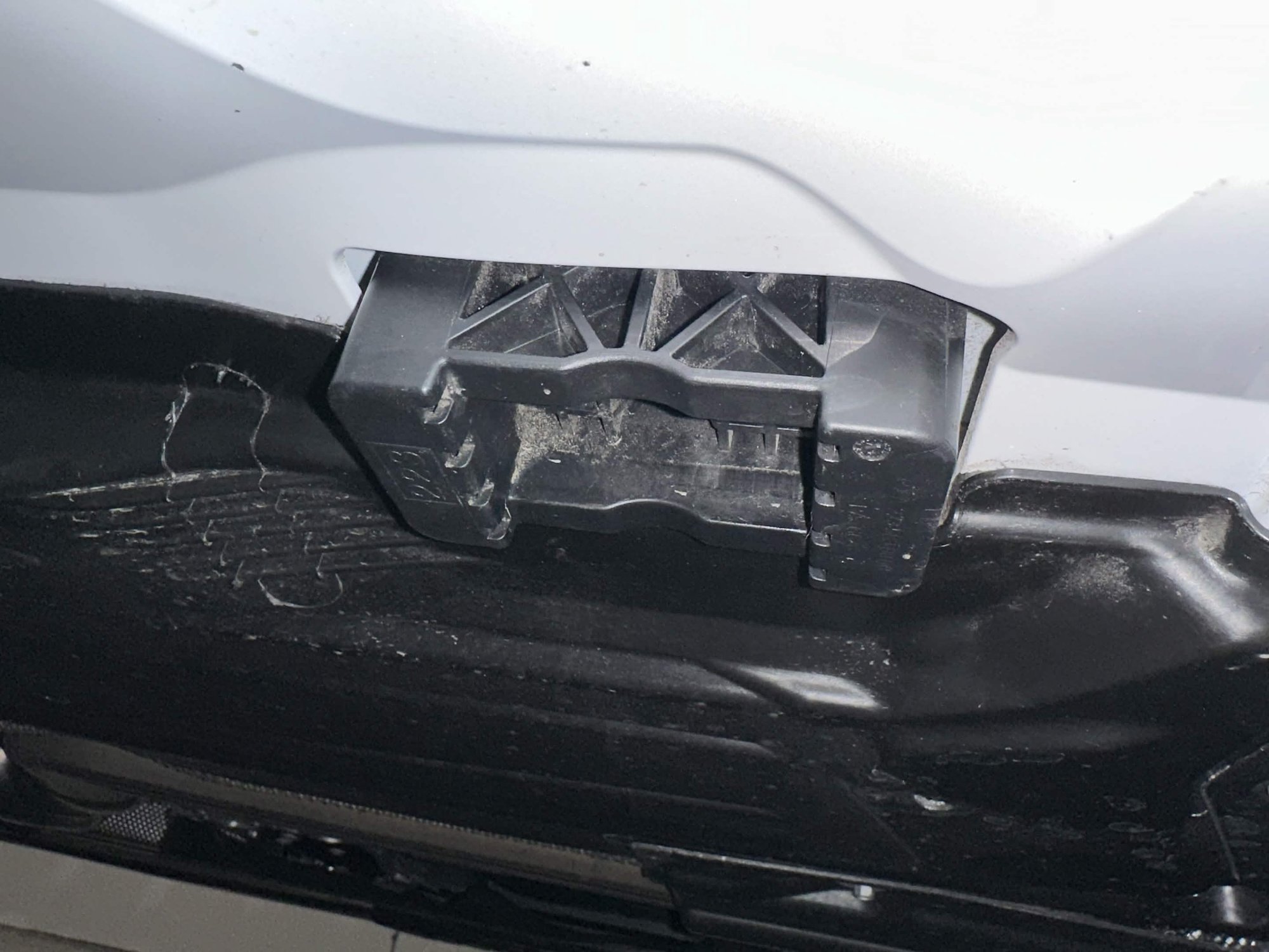

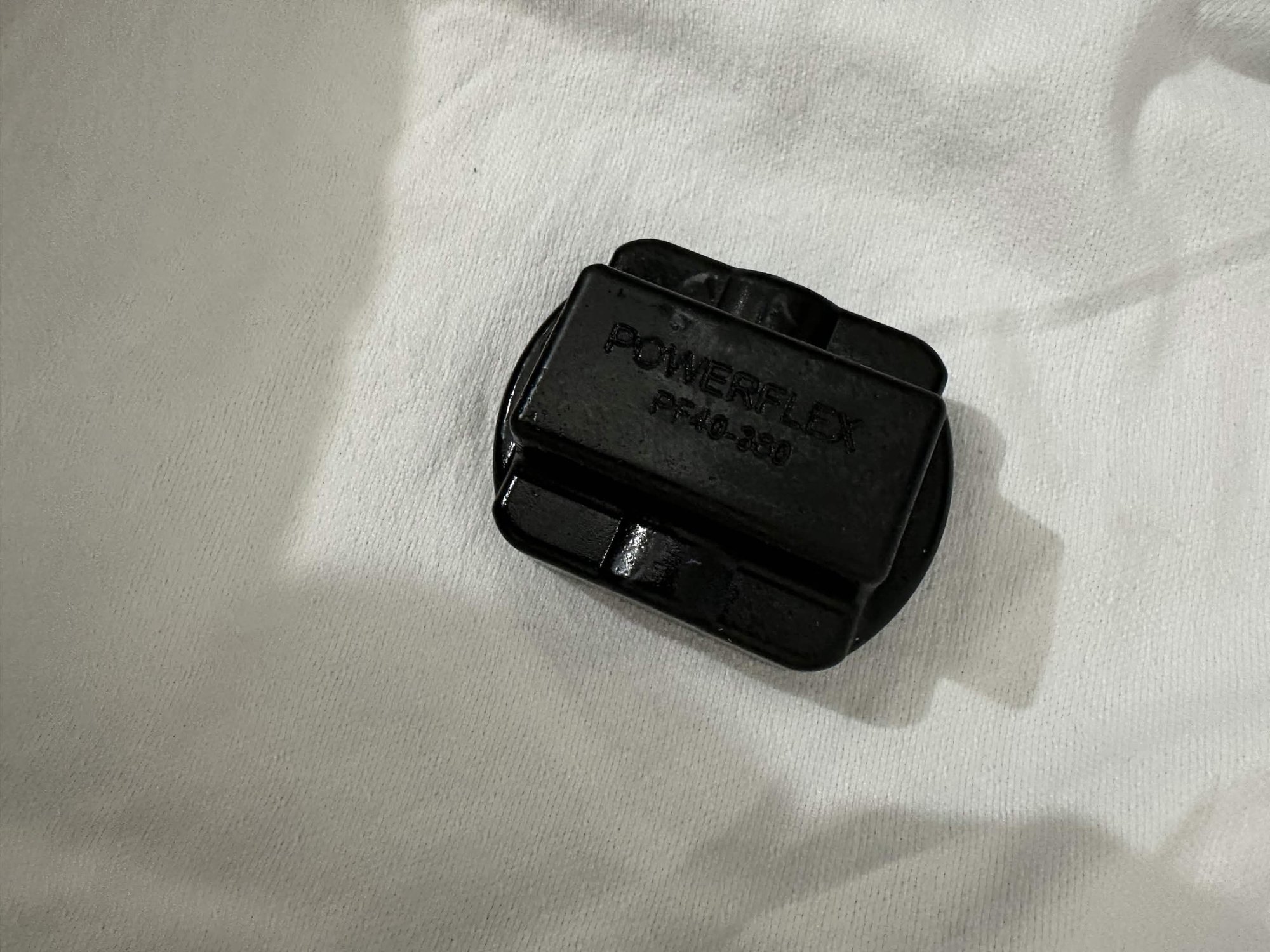

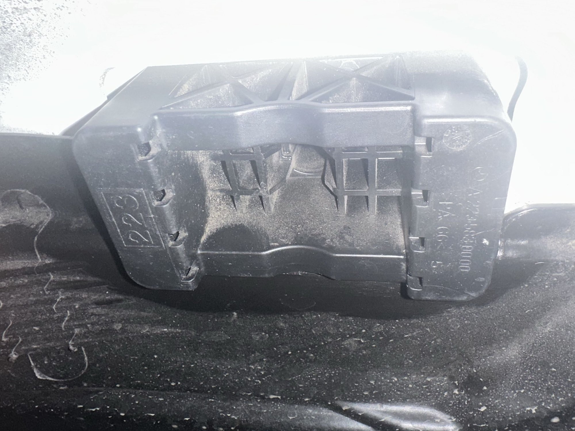

I'll do my oil soon in another 300 miles once I reach 1k. I've decided to change my own oil and will probably just get the MB oil for this car. I looked under the car for lifting points and figured I need some sort of jack/lift pads.

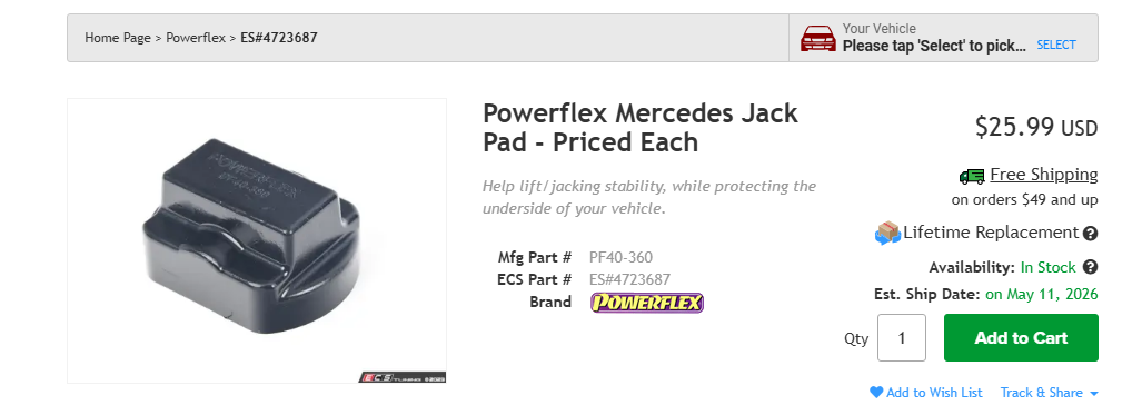

I ordered one of the PowerFlex Mercedes Jack Pads to try and see if it fits. I also found a pottential other option, some genuine mercedes pads, Ill the genuine red ones if the PowerFlex one doesnt fit but I think it should.
This is the genuine pads someone recommended.
My lift point looks like this.

I ordered the lift pads
Amazon.com: PLANGER® - Daimnd Pad - Rubber Jack Pad for Mercedes Benz (Special CAR Brands from Germany) Trolley Jack, Vehicle Lift and Axle Stand - Protects Your Car, SUV : Office Products Amazon.com: PLANGER® - Daimnd Pad - Rubber Jack Pad for Mercedes Benz (Special CAR Brands from Germany) Trolley Jack, Vehicle Lift and Axle Stand - Protects Your Car, SUV : Office Products
for tire removal/rotation.

The ramp is cool I may get on eventually, my dad has a shop lift and that’s what I need the pads, the Planger ones you have on Amazon do they fit your CLE53?

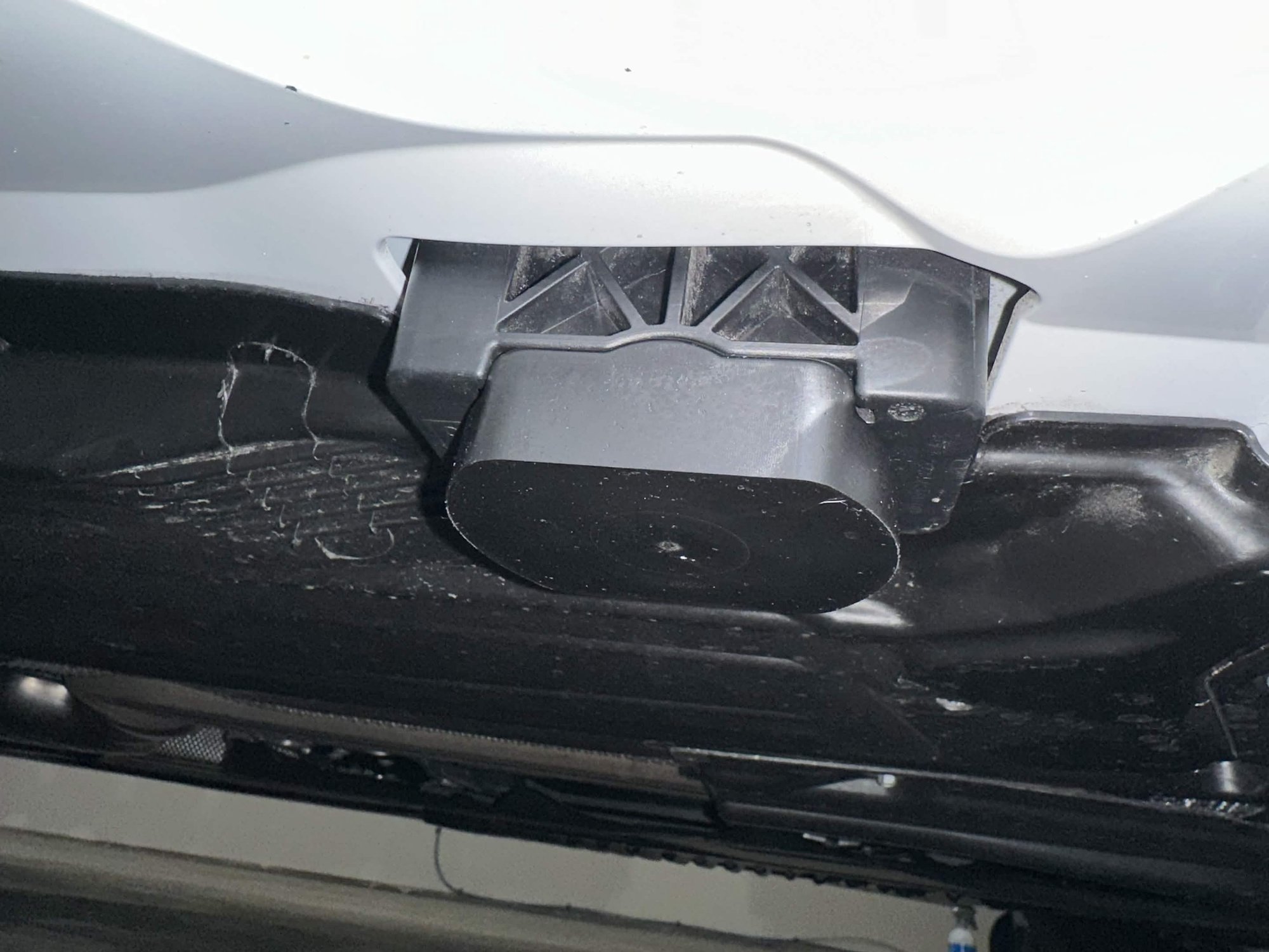

The Amazon link no longer has the option for the 'flat version'. See the following picture which fit my CLE 300.

The one I just ordered arrived, it fits perfectly.
