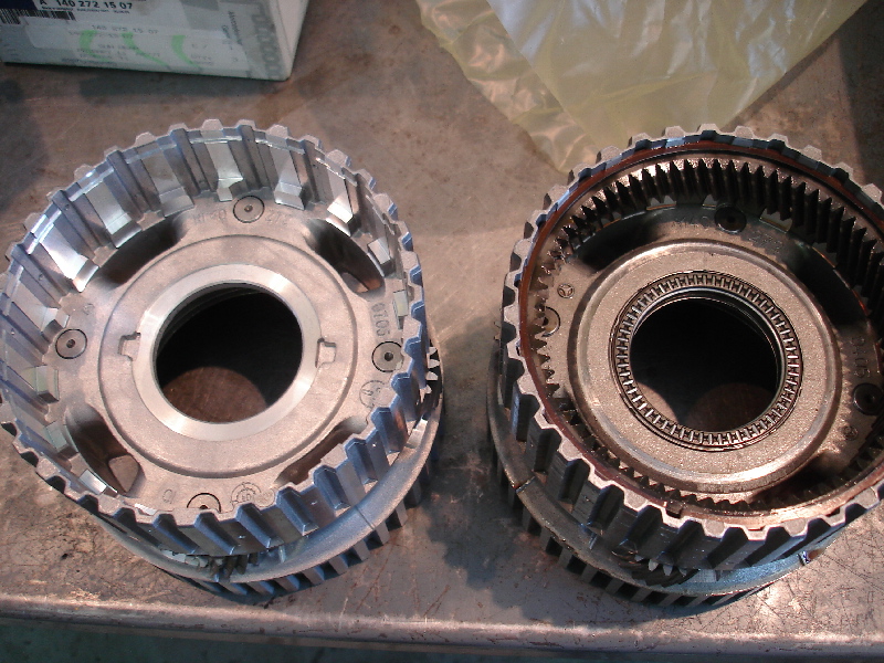

Well after a couple of weeks of thinking what to do with my car I decided to
take it to another Mechanic.
He has worked on my car before and I needed a second opinion.
He called me and said that yes, it was the transmission, and he thinks he
has found the cause of the problem with Mercedes transmissions.
The problem is the bearings that come apart tearing down gears.
Here are some pictures of his findings that I took today.
Also I have some pictures of the damage.
He also mentioned that the new bearings have been redesigned.
I will take pictures of the new ones as soon as he gets the parts.
Does anybody know if there is a class action suit over Mercedes
transmissions?
I am just dissapointed that they would use crappy bearings in this expensive
car.

Originally Posted by Netgato
. . . . . He also mentioned that the new bearings have been redesigned.
New bearings like the 2001/2002 430 transmissions, or new bearings like the W209?

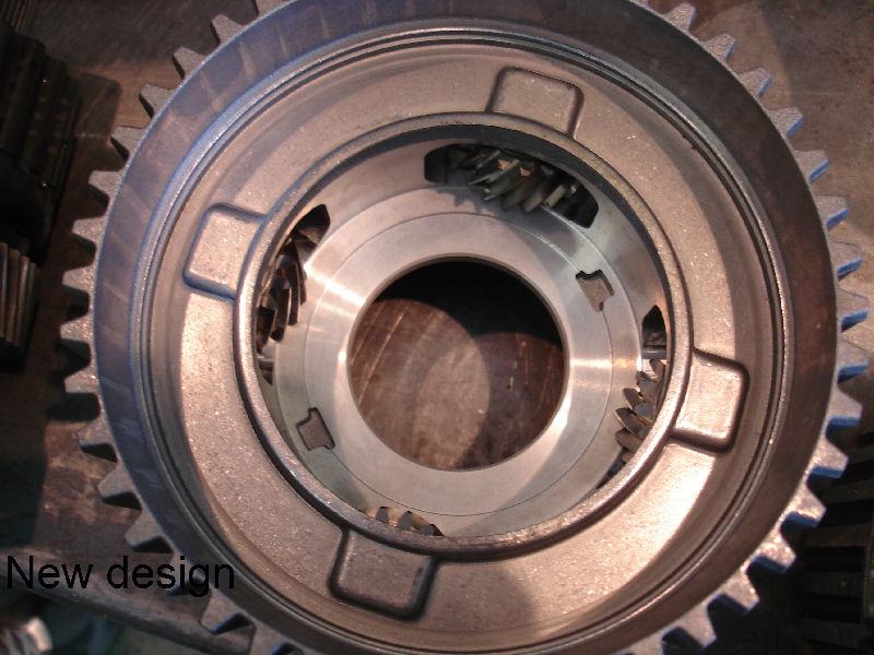

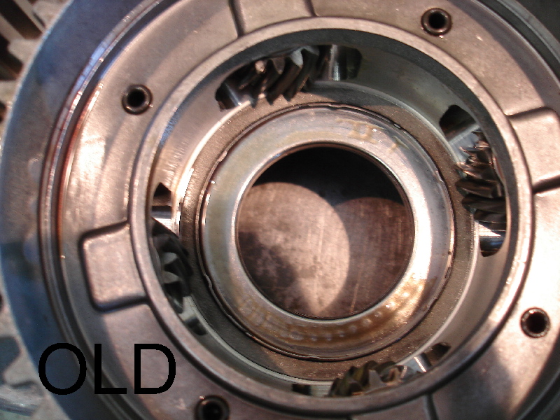

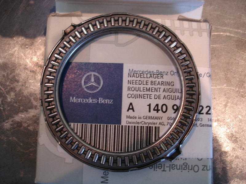

These are the replacement parts for the 208's

Do you know if the design change was made while the 208 was still in production, or was this a post production upgrade (after 209 production had begun)? Thanks.
SO were you able to fix your transmission without replacing it?
