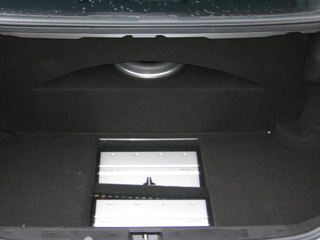

here are some pictures of my rear speakers...... w/just popping off the grills

nice install....but your pic doesn't show how the grill just "popped off"
also, that's a nice W7 woofer. Have you tried firing it to the rear of the car instead of upwards?

ya ive tried all diffent things with it had use to have it set up like this picture then i went with the second set up for a while and now im gonna probably try something new and mayb get 2 jl 10w6's
