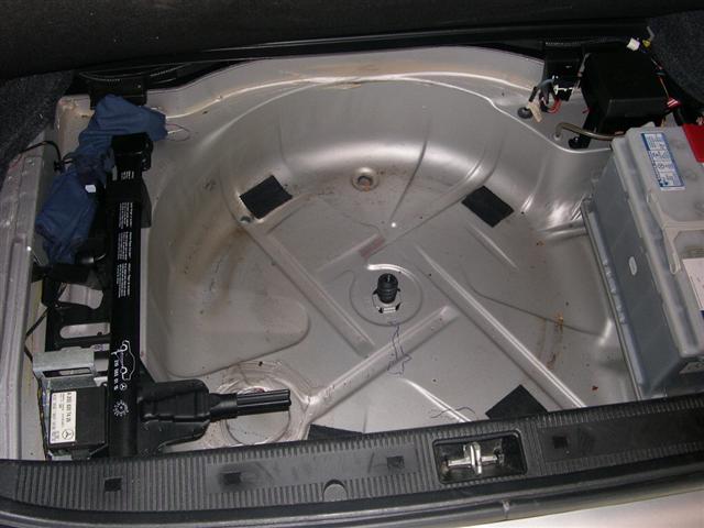

There are three fuse boxes (or maybe more). One under the hood, one on the far left side of the dash (the door has to open to see it), and the one you want – the one in the trunk next to the battery. Fuse number 23 is for the cigarette lighter.
