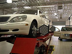

BTW, I bought my car at a Southern California MB dealer called Walter's. They regularly email me info about their specials. I got this from them about a month ago:
As the summer months arrive, and we start going on our vacations and long drives, it's time to make sure your Clk430a is riding safely. Having a properly aligned suspension and good tires that have proper air pressure, are wearing evenly and are balanced properly can improve gas mileage, improve braking and handling capabilities, reduce pulling and vibrations and help prevent potential tire failure. To help you prepare, we would like to offer you the following special.
Complimentary Tire and Alignment Inspection Service*
  • Check front and rear alignment specs on factory approved M-B computerized alignment rack
  • Check tire tread depth
  • Check and adjust tire pressures
  • Check for even tire wear
  • Road test vehicle to check tire balancing and tracking
  • Free carwash included
All this for Free!
Consider the following:
  • We use only factory approved wheel alignment and tire balancing equipment - most independent shops do not!
  • Our alignment and tire technicians are factory trained - independent shop technicians are not and they work on all brands!
  • We sell only factory approved and tested, original equipment tires!
  • Our replacement OE tires come with 2-year road hazard coverage at no additional charge!
Don't delay! This special expires on June 30, 2007! For more information, or to schedule your appointment, contact our Service Department at 951-688-3390. To schedule an appointment online, click here.
Sincerely,
Rob Deck
Service Manager
Walter's Mercedes-Benz
P.S. Don't forget to print this email and present it at time of write-up!
*Not valid on previous services. Cannot be combined with any other offer. See Service Advisor for complete details.
