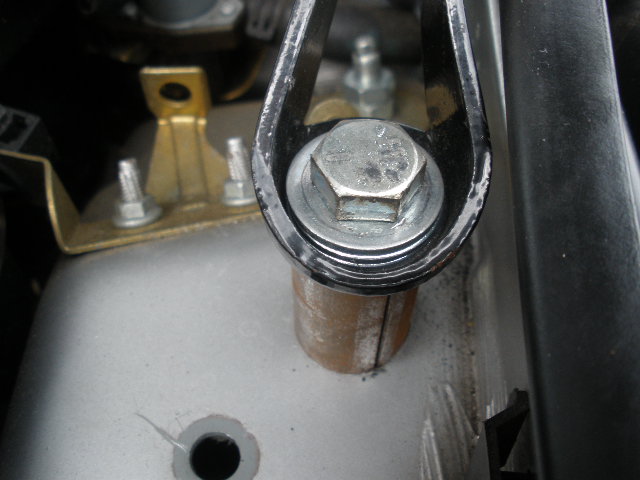

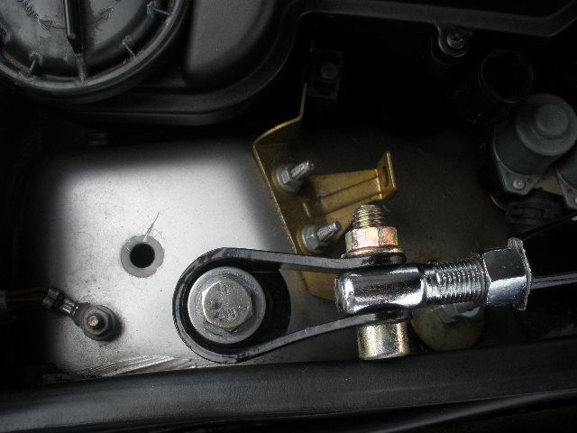

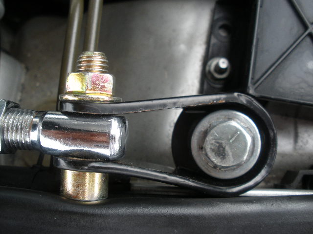

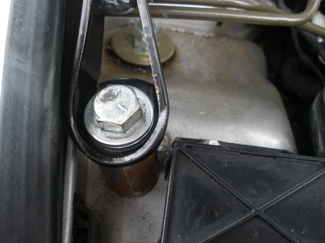

u move to that lil black box too, just remove one bolt from it and turn it

once u install em, u have to cut between the fire wall and where u see that big bolt , i had to hammer it down like 3 times so it does not hit the hood (when u try to close it), otherwise, it wont close.
if your ride is low as mine, you haveto cut teh bolt underneath the fender once you installed it, otherwise it will hit the upper arms
