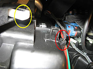

Good news. If it is the evaporator temperature, the dash doesn’t come out. The sensor is accessed by removing the cover under the driver’s side foot well. The first photo (neither photo are mine) was shot looking straight up while laying in the foot well and is what you would see laying on your back.
For orientation:
The yellow circle is the top of the accelerator pedal arm.
The red circle is the part in question.
The part is displayed in the second photo.
Autohaus AZ has the sensor. $36 for the OEM part or $26 for a non-OEM version.
I hope that helps.
