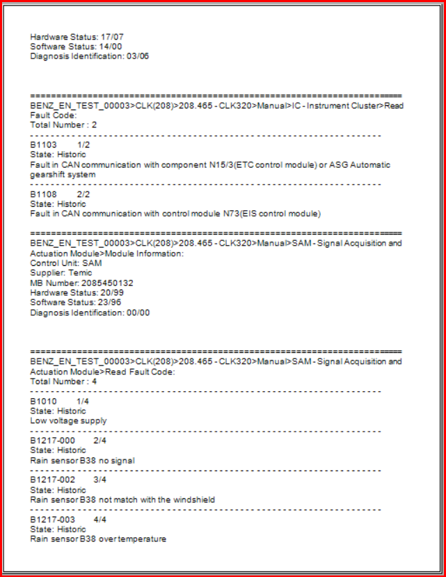

Question W208 Trusted Electrical Engineer here I quoted. Wish I knew. No to Carsoft & icarsoft
Seems to use icarsoft MB 2.0 you need to know what the values that are brought up are supposed to be. In the quote below at the bottom is a link for details of these issues on our W208. This link doesn't work anymore, mbcluster.com/Old_Website/Media_Diagnostics.htm. Does anyone have this info? Intel wanted help! Attachment Is the Test and Freeze Frame Report with all supported items from icarsoft MB 2.0 on a W208 With the icarsoft ODB2 to 38 pin adapter. IDK how the report
pages got mixed up... Could it be the rain sensors? Lol, I tried to Clear Every Code and Reset Everything Possible Before the test... It looks like Its only showing Historic Faults, not Active ones. It used to have a Dead Battery, How do I Reset the Battery? Historic. ASG N15/3, Somewhere in EIS N73, what test is for that? How did my Rain Sensor used to overheat? How far is the ABS diaphragm supposed to travel? Maybe a Chilton Repair book would help? Okay, probably. Bad Speed sensor, brake pressure sensor works, Stop lamp switch No Contact - OFF? Double negative. Didn't notice the steering wheel thing till afterward. Most importantly I think maybe, Why in the ABS & ESP(ASR, ETS) Test, did supported items 4 & 5 Switch from OFF & ON to ON & OFF in Frame 18 & 19 Only? Does that mean my gear shift unlocked? Is it Salvageable?
Also, If the Transmission Module has to be reset after, maintenance, changing the battery?, examining the TCM? (Disconnected, looking for leaks of Transmission Fluid)?
(BETWEEN WICHITA, KS & KCMO 2 HOUR TOW EITHER WAY TO DEALERSHIP AND BACK, SO IF CLOSER TO MANHATTAN, KS AREA WITH STAR 3(I think for 208 Cab) or the V12 System and know it will help, PLEASE HELP ME, i do charity and only get paid $12ph for now ugh. I'll gladly match what it would cost at the dealership, quick and clean. I only got to enjoy this car for a Month and it's been sitting a year)
If I'm wrong here about V12 System, please let me know. I'll get a multiplexer and all. It doesn't have an ODB2-38 pin Adapter, so maybe. But I'm heavily leaning of trust in what Serndipity says in my Quote below. About Carsoft Mercedes V12 System. Although ODB only has 4 wires to it, but a Craftsman ODB2 on the ODB2 connection did give me a Specific Transmission Code, not just a generic one p0705 along with p0600 (Same generic code the icarsoft gave me).~https://mbworld.org/forums/clk-class...de-p0600.html~ Serndipity Clearing things up here as well. Another problem, icarsoft can't access SAM. "CANBUS issues are very difficult to troubleshoot, diagnose and repair. Especially true for controllers that use voltage encoding (e.g. multiple voltage levels on a single wire to control multiple functionality)." -Serndipity
Thank you Serndipity. Aspiring to Self learn to be a General All-around Technician have bought the MB 2.0 icarsoft. With 38 pin Adapter. to reset my Transmission & ESP, BAS. I can't see how this helps. It doesn't access or reset a few things it says. Only gives values of modules it can access via live stream. What are the values supposed to be? Where are all the answers? If someone knows, please help. I know a wheel speed sensor isn't supposed to read 6kph and quite a bit. BUT these values being even a little off can shut stuff down. So I read on here about the Carsoft Mercedes V12 System... The pdf is amazing, Haste to Ebay bought from Belgium even though they have a Canada office. I got an CD and a flash drive. Ops! Then I find out they are the same people, got me twice, Ugh. Okay now I need an old laptop, multiplexer, adapters, wires. I actually have an old desktop that has IDE & SATA HDD Connections (Dual Boot Win 7 Ultimate 64 bit, Win 10 Pro, Super cool) with Serial connection.
Brake Lights don't work sometimes, I'm going to check that ground and all wiring back there bro.
ABS, ESP, BAS lights Most of the time.

Full Smart Scan and Test with icarsoft Multi car MB 2.0
Here is everything My iCarsoft Multi Car MB 2.0 could access and Test in Smart Scan mode, sometime in the next week I'll do all Manual Modules Scans and Testing. Also, my car is stuck in park, It's not the brake light switch replaced or the left front wheel speed sensor replaced it... But it still says 650kmph. Could it be the other sensor there, ABS? Then shifter?
