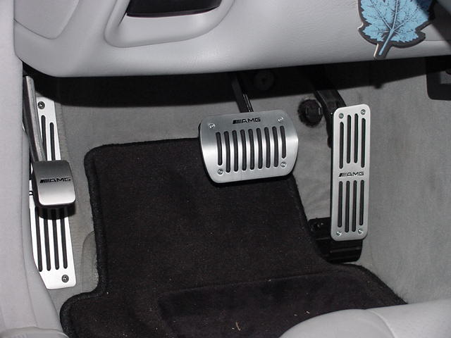

I used the ones off e-bay. Had to drill 4 small holes in each pedal. No big deal. The amg alum. pedals looks great.
pedals $65 shipped
drill free
look priceless
I want my vehicle to look nice but I don't think I should have to pay crazy prices on parts.

No instructions. Very simple.
Gas pedal..... removed 2 nuts that holds it on the floor
remove rubber pedal
drill holes in plastic support
install alum. pedal
Brake pedal...remove rubber pedal
drill 4 holes in metal support
install alum. pedal
E-Brake........ remove rubber cover..install new cover (no drilling)
Foot rest...... screw the alum. pedal to the floor.
Est. time @ 30-1 hr.
The pedals should come with screws.
