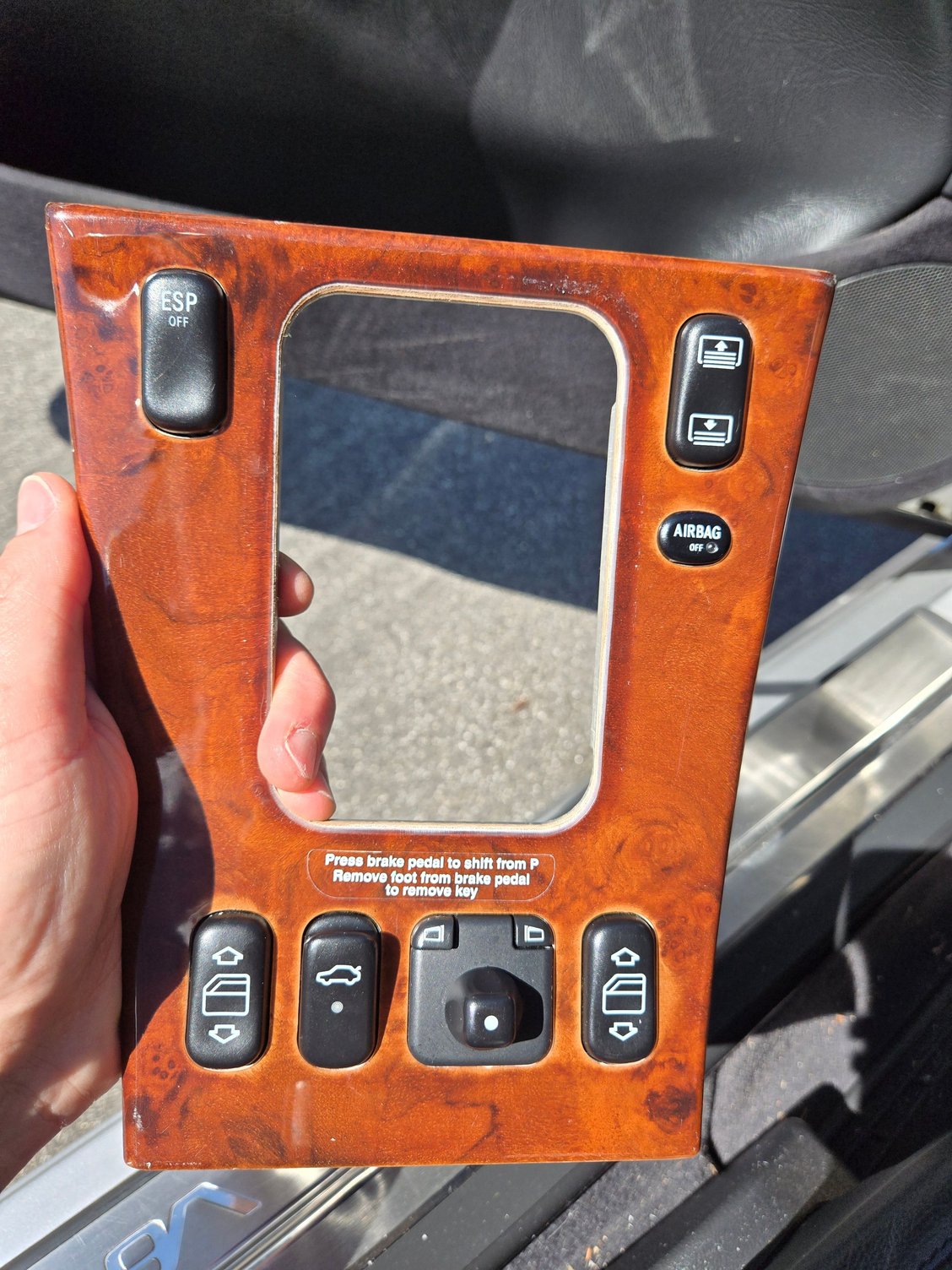

Step 4: Reassembly. Just push the buttons into your new trim! Oh and I hope you remember what spots they came out of on your old cracked one. Like I said, it's an easy job, but if your IQ is mayonnaise then put the screwdriver down, walk away, and cry in the shower hoping you have 45 minutes worth of hot water.
Old Jul 6, 2025 | 07:49 PM
Uranium238's Avatar
Joined: Feb 2008
Posts: 224
Likes: 24
1987 Porsche 928 S4, 2009 Mercedes E350, 2011 Mercedes GL450, 2003 Mercedes ML350
Step 4: Your new wood trim should look like this! Fancy right?
German engineers making the w208 were sipping their Hacker Pschorr and Warsteiner admiring the beauty of these burlwood veneers before popping them in, and popping their flaureins after a couple drinks during October fest.
