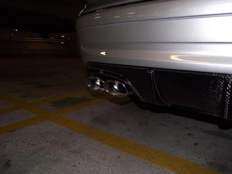

Hey guys,
For the exterior of the tailpipes, I suggest using a non-scratch scouring pad - one that you'd use in the kitchen. This is to prevent you from putting fine scratches on the polished outside of the tailpipes.
For the insides of the tailpipes, I used a fine grade sand paper to remove all the bonded on crap.
Then I hit the tailpipes with some autosol (polish).
Now I just wipe the tailpipes out after each time I drive the car.

damn they are clean! I see you finally got your diffuser, looking good! post more rear pics

Hey buddy,
Thanks for your kind words! Very much appreciated.
You can see a couple more pics of the car and diffuser in my album on my profile.
