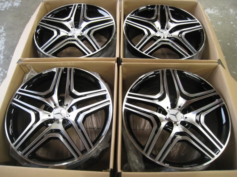

Quote: Not bad Morgan... although i like your previous setup better
Care to experiment with these wheels? I've always wanted these on the CLK!
They're off the GL and ML
I was thinking of trying those! But they are 21" which is way too big. I think there is a similar one from the CLS that would work in 18".

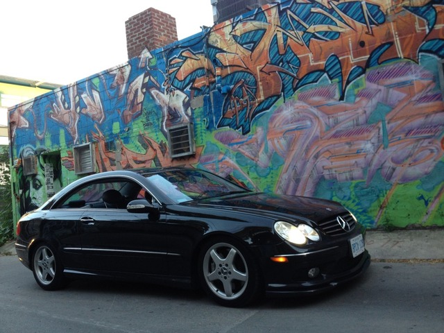

contemplating on selling my clk500 but if I end up keeping it, I want to throw these 20s on my car. now just wondering how it will look and fit.
http://www.car-parts-accessory.com/2...+Wheels+/3862/
20x9.5 all around .45 or I've seen 20x10 as well. I wonder how it will fit in the front. I know that theres camber kits for the rear but not for the front (correct me if I'm wrong). and also I like the slammed look on my car and is little concerned that these will raise my car substantially.
this is what it will be going on.. its currently on stock 17s
***Official Wheel/tire/stance Fitment Thread***-photo14.jpg
Reply 0
Jan 8, 2013 | 12:53 AM
  #668
They wont raise the car at all as long as you go with the correct 20" tire height, I think they would look pretty good, massive upgrade as to the wheels on the car now.
