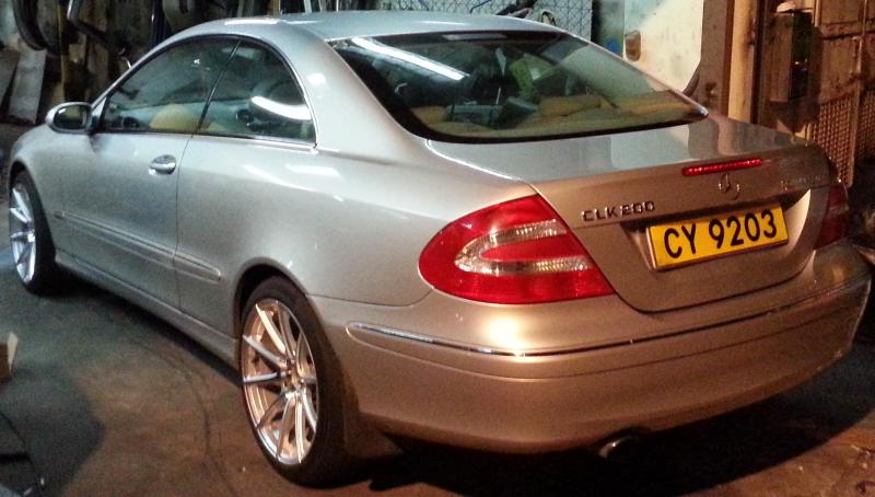

Trial setup with the offset above, I know it looks like a jeep now, drop is pending after wheels setup all good
ADV10, picked 18x9J on all corners for its deep concave.
F - 10mm spacers > ET30
R - 20mm spacers > ET20
235 40 18 at the front now, inner clearence is scary tight, but they are clear, will swap to 225 soon anyway.
Attached Thumbnails ***Official Wheel/tire/stance Fitment Thread***-20130917_194329s.jpg   ***Official Wheel/tire/stance Fitment Thread***-20130917_184300s.jpg

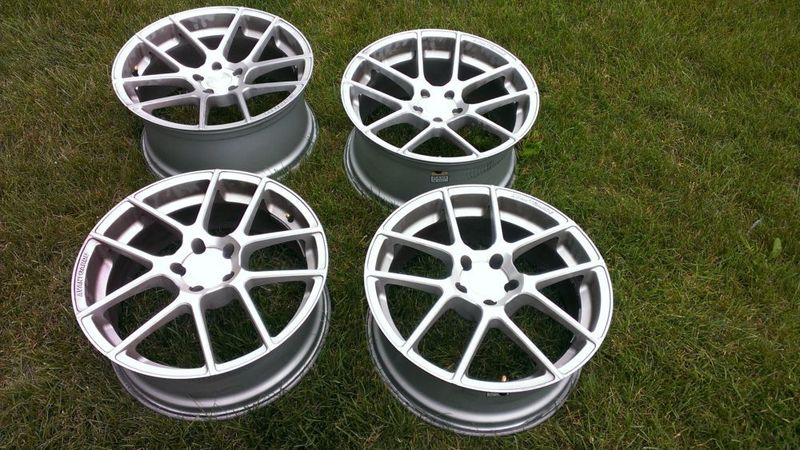

So i was searchibg my local CL when i stumpled upon 19 chrome madrus manhilliem wheels at a pretty decent price. I would like to know if there is anyway i could get these to fit. If so, how?
Heres the specs he gave me...
5x112
Rear 19 x 10 1/2 backspacing 7 3/8" 35mm offset
Front 19 x 9 1/2 34mm offset backspacing 6 1/2
Thanks for the help!
