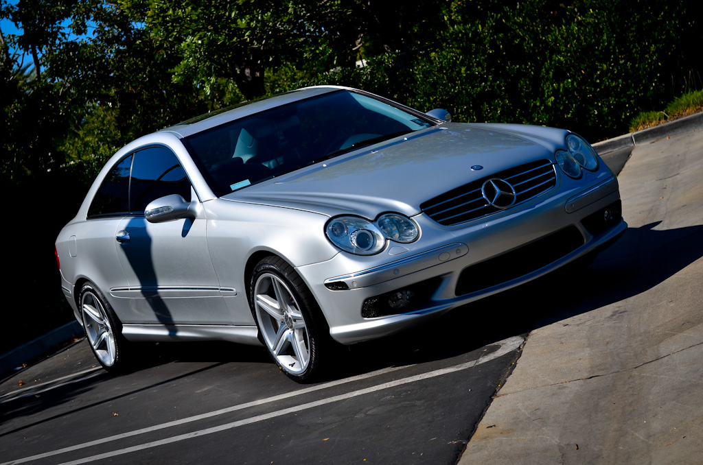

w209 clk500 (stock height) on oem w219 wheels.
- 18x8.5 et25 | 235/40-18
- 18x9.5 et28 | 265/35-18
- 12x1.5mm lugbolts | R14 ballseat | 26mm shank
***Official Wheel/tire/stance Fitment Thread***-dsc_9965_zps2c662421.jpg
***Official Wheel/tire/stance Fitment Thread***-dsc_9982_zps9d76b175.jpg

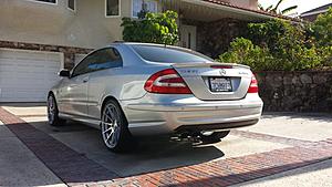

sweet jones's Avatar
Joined: Feb 2009
Posts: 678
From: Seattle

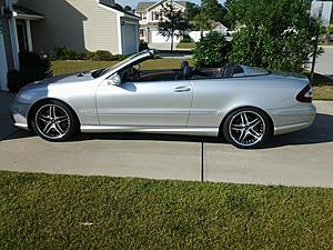

W209, E46 M3 (dead), S54 swapped E46 Touring
19x9.5+20
225/35/19
***Official Wheel/tire/stance Fitment Thread***-img_20130823_195920_zps69dba259.jpg
Attached Thumbnails ***Official Wheel/tire/stance Fitment Thread***-forumrunner_20131012_222929.png

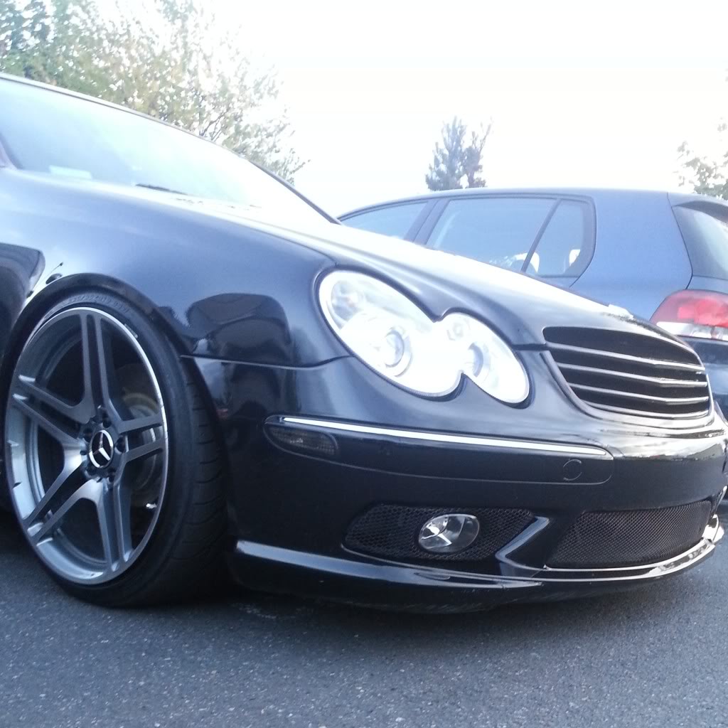

Old Oct 20, 2013 | 03:52 PM
  #785
Gary C's Avatar
Joined: Aug 2012
Posts: 158
From: Myrtle Beach SC
2004 CLK 500
new wheels and tires
18x8 32et and 18x9 35et Roderick rw2. Michelin Pilot sport as3 tires. 225/40r18 front and 255/35r18 rear

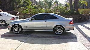

Originally Posted by sweet jones
19x9.5+20
225/35/19
wow thats a low drop. I had to raise my fronts by .5 inch (Bilstein PPS9) as I ran in to trouble. Hit a pothole while turning and the wheel hit the bottom of the fender banding it out a bit. Lucky its not so bad and I banded it in by hand, mostly. Tire was fine as well.

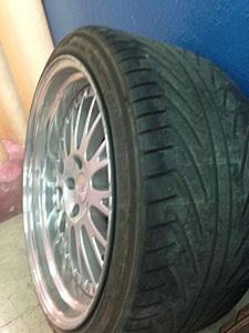

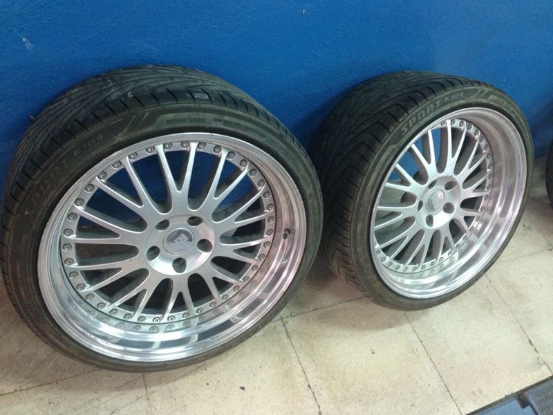

2005 E55 AMG

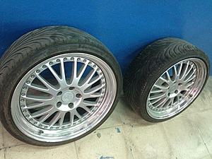

Anyone run a 10.5 wheel in the back? I will be stretching the tire a tad bit.. with a 265 30 19 on a 10.5
with offset of 37+..
Old Dec 5, 2013 | 08:30 PM
  #793
DiceCedes's Avatar
Joined: Jul 2006
Posts: 322
Likes: 11
From: NorCal
21 AMG GT Stealth Edition
I did
I did run 10s on ET32 with a 10mm spacer for ET22. It was a stretch that I was not real comfortable with. But looked sick! So, 10.5 would be really stretched.

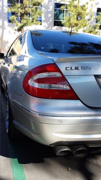

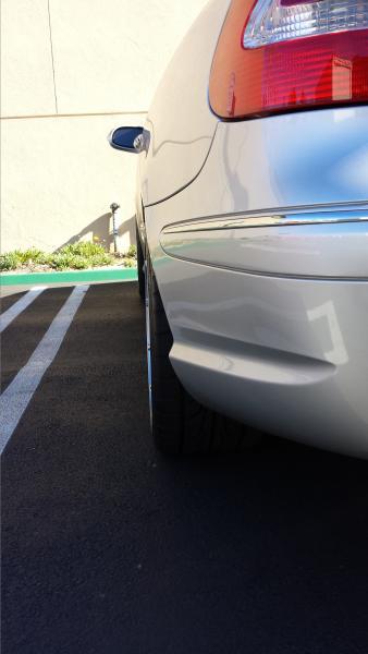

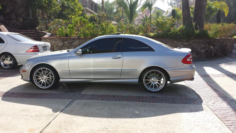

From: Orange County
2005 E55 AMG

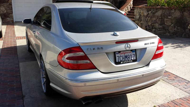

w209 CLK55 Fitment
w209 CLK55 Stock Height (Needs Drop ASAP !!)
Wheels: MRR GF6
Size: 19x8.5 225 35 19 ET25
19x9.5 265 30 19 ET25
Tires: Nitto N555
I wanted to be as flush as possible without rubbing. The fronts should be good.
(With Camber from lowering Id imagine the Rears will need 10mm to be "Flush")
So if you want to be flush and play it safe, Id say 25 et in the front and 20 et in the rear.
Will post pics once its lowered on coil overs.

sexy clk with this et you went i suppose you wont need spacers for any reason right?
Wheels: MRR GF6
Tires: Nitto N555

Thanks!! I didnt have to use spacers, however the rears I will probably add a 10mm to make it sit more flush once its dropped
