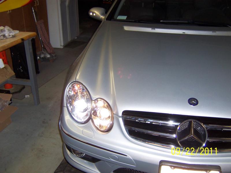

The pics are great but none show the function of the inside reflector lens. When do these come on? The outside lenses are bixenon. The inside are brights only?

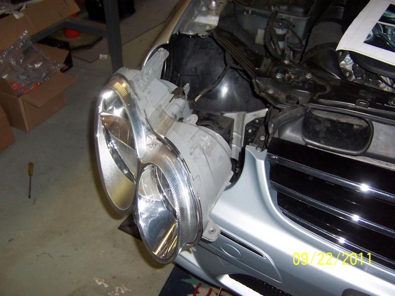

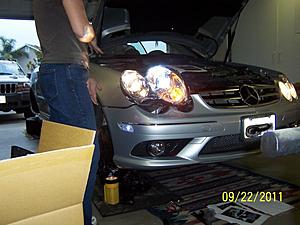

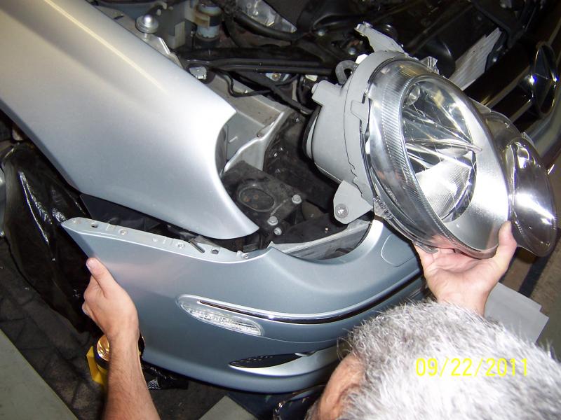

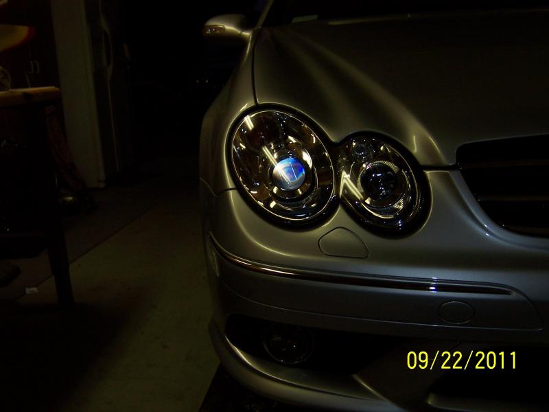

I took the one for the team, the above PDF file that someone posted works. I got the passenger light done with help from my wife a little over a hour with 2 smoke breaks and a beer.
Attached Thumbnails W209 (aftermarket) bi-xenon lights coming soon....-100_3848.jpg   W209 (aftermarket) bi-xenon lights coming soon....-100_3849.jpg   W209 (aftermarket) bi-xenon lights coming soon....-100_3851.jpg   W209 (aftermarket) bi-xenon lights coming soon....-100_3852.jpg   W209 (aftermarket) bi-xenon lights coming soon....-100_3853.jpg

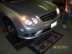

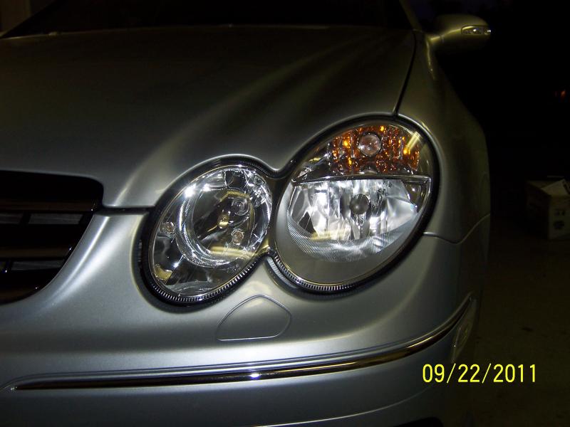

Two other Pics. I will get the drive side done tomorrow sometime..
Attached Thumbnails W209 (aftermarket) bi-xenon lights coming soon....-100_3855.jpg   W209 (aftermarket) bi-xenon lights coming soon....-100_3860.jpg

So what actually did you remove? Did you have to take that tough bolt that you were talking about?

Looking good there Louie. The front plate gotta go though.
Sure beats the OEM halogens right?

I pretty much followed the above link that was posted, but I was already half way there before I saw that link. The bumper does have to be pulled forward as you see in the pics. Thats where you can gain access to the 3rd bolt I was talking about.
I never worked on cars before in my life, if you follow those instructions its pretty damm easy read it 2 or 3 time and refer back to it.
Only thing that I did not do from the instructions was the very 1st step where it says remove the 8mm screw in this hole 1st in his link.I could not find the 8 mm screw.
I caveman could doeeetttttttt

Nicely done. They look great. So the main lights are bixenon and the high beams still function the same with the halogens broadcast through the reflector.
