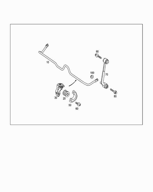

I want to add to the W209 troubleshooting knowledge base. Ever since I installed my H&R sway bars, I've had a "Clunk" coming from the rear passenger side area, here is a diagram of the rear sway bar area:
I've replaced my rear shock and torsion arm (70), with no luck. Today I found the culprit, the screws holding the sway bar bushing (60)! I checked both sides and both had loose screws. I tighten them down, then checked my CLK shop manual DVD for torquing values; I found out they are single use only and need to be replaced (I'll do that later). I took a test drive and it solved the problem!

My rear sway bar was modified and thickened to compensate for the new exhaust and my rear sway bar rod bushing failed. I followed the advise from the thread below and it fixed the problem.
