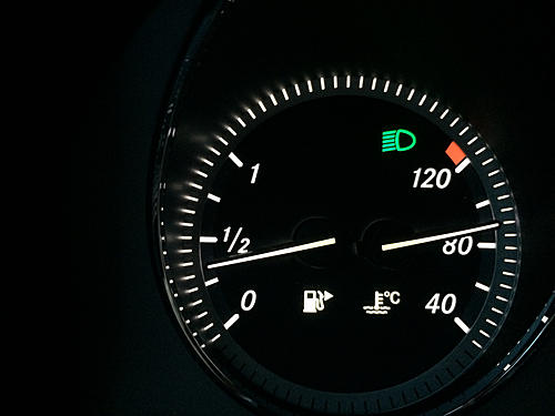

1. I have not attempted that drive cycle in it's entirety. I'll need like 3:00 in the morning with L.A. traffic.
2. I'm going to take it in to have the dealer scan for any codes. I want to rule this out. I've waited so much gas.
3. My engine temp is just north of 85 but suddenly I don't have any heat. Just blows cold air. When it rains it pours.
Attached Thumbnails Intake manifold broken?-imageuploadedbyag-free1404137786.507606.jpg
