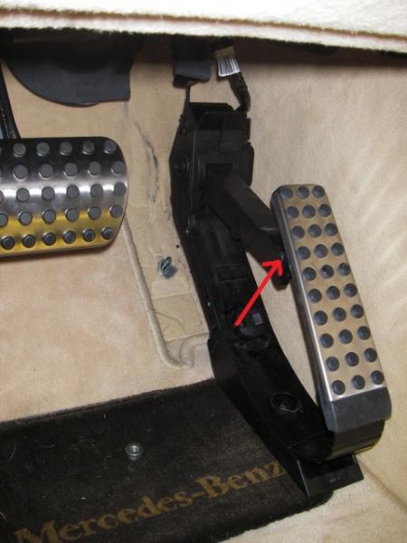

I'm really susprised that you have to asked to install these simple mods. Every mods that I has done on all my cars, I just look at the parts and try to understand how it designed and the installation should very simple.
Your oem rubber paddle on the parking brake and brake paddle should just pull right off. Your gas paddle rubber, just use the plier and pull the plastic pin then just pull off the rubber (go these route if you want to keep the oem rubber) or you can just cut the oem rubber from the gas paddle. Next, before you start drilling holes on all the paddles, you want to make sure your placement of all the new paddles perfectly align up/down and side to side, I used double sided tape to held all the paddles in place then use the marker to mark all the holes that need to be drill. Then remove all the new paddle and start drilling.
Here's the picture of the pin (see red arrow)
Thanks for the picture and instructions.
Pedals ordered. Should be OK now I know where is the PIN.
