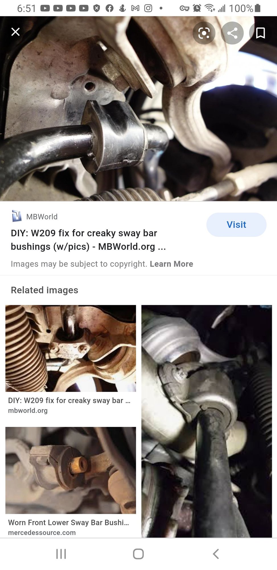

Thanks for the help. But both part numbers are not the one I have. You see how these have that bump in the middle. .ine looks like this picture

I see, from what I know those are not removable, I don't think that you can buy them separately from the swaybar.
If I remember correctly around 2003 Mercedes switched to "non-removable" swaybar bushings and they changed brackets as well. So you have two options:
1. Buy entire swaybar (i so them new around $85)
2. Buy bushings and older style brakes (brackets are around $25 each new, used probably half of that) and cut off old bushings from your swaybar.
Just in case older style brackets are 2033231140 and 2033231240

I found this poly bushing . Can I just cut off the old ones and replace with these ?

Never tried poly bushings, but seems like those should work.
