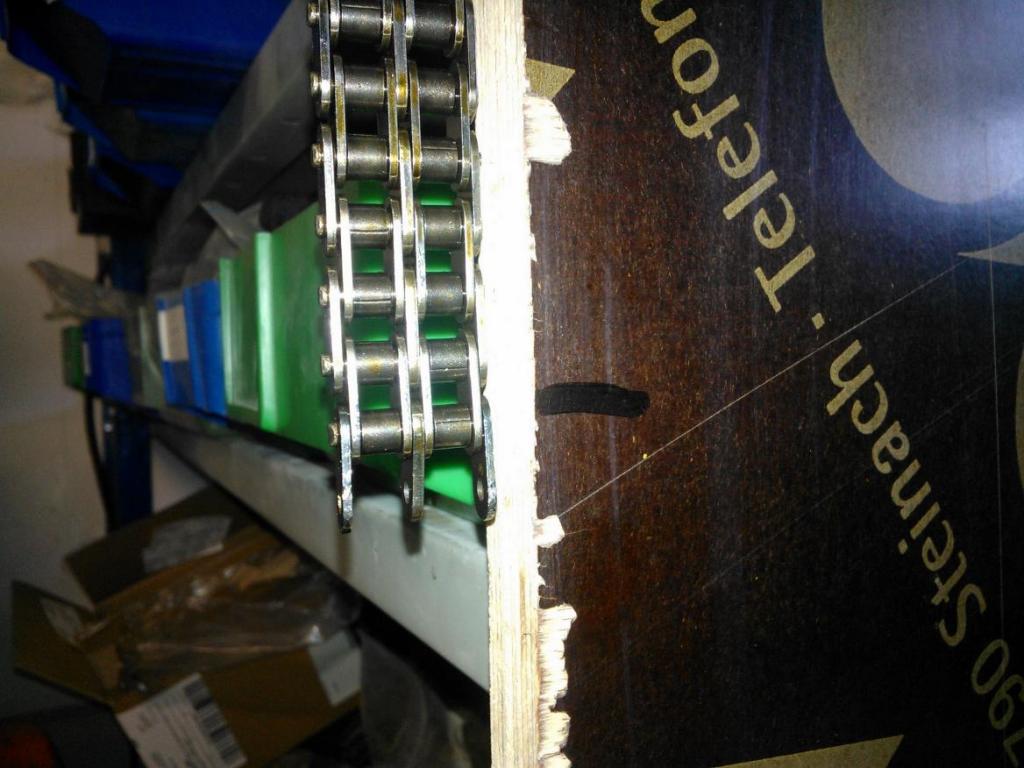

How many miles do you have on your CLK? & list your problems-stretch_zps1a5f3608.jpgThe chain was easy to change by feeding it in with connected to old chain.
Nothing else. Solid car.

That's a fair amount of stretch for 185 000kms - did the engine have regular oil changes with synthetic oils?

I know this is weird. Accordin the service records all oil changes was done like they should. Overall condition of the car is verry good.

Here's picture of my friends old timing chain out off '00 CLK430. 230 000km driven and 12mm stretch.
How many miles do you have on your CLK? & list your problems-cid_s__d8001_zpsa0378c17.jpg
